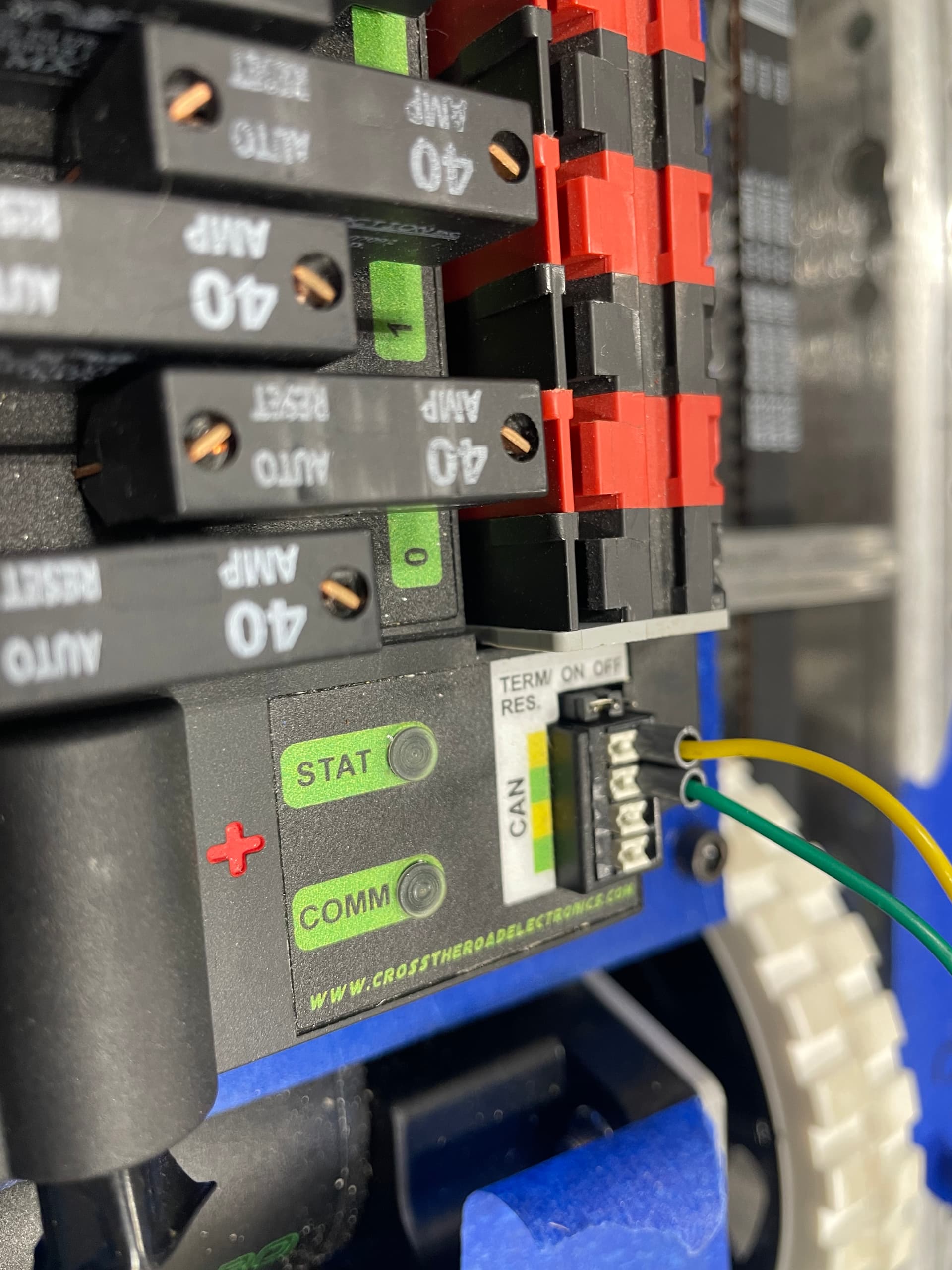

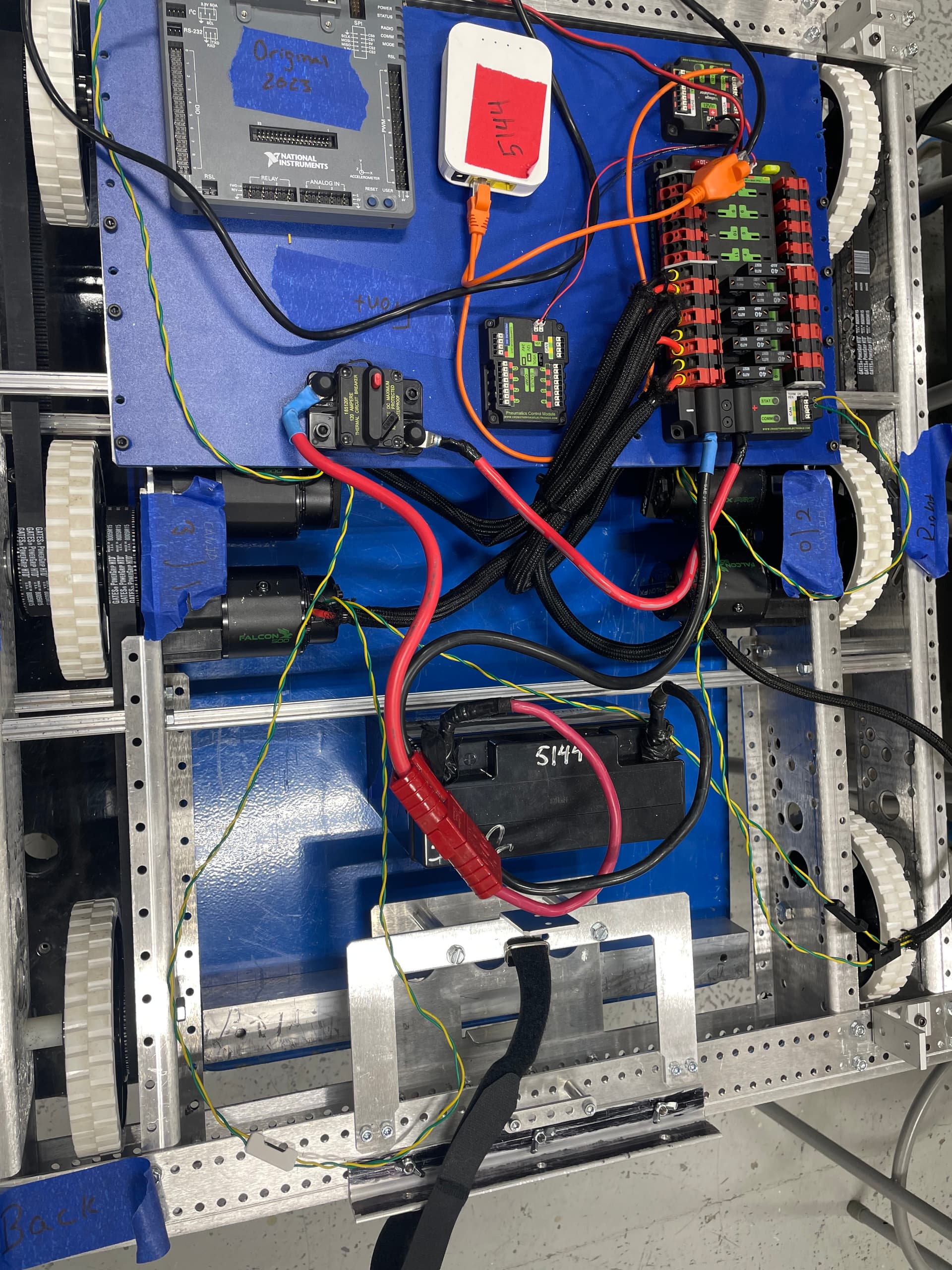

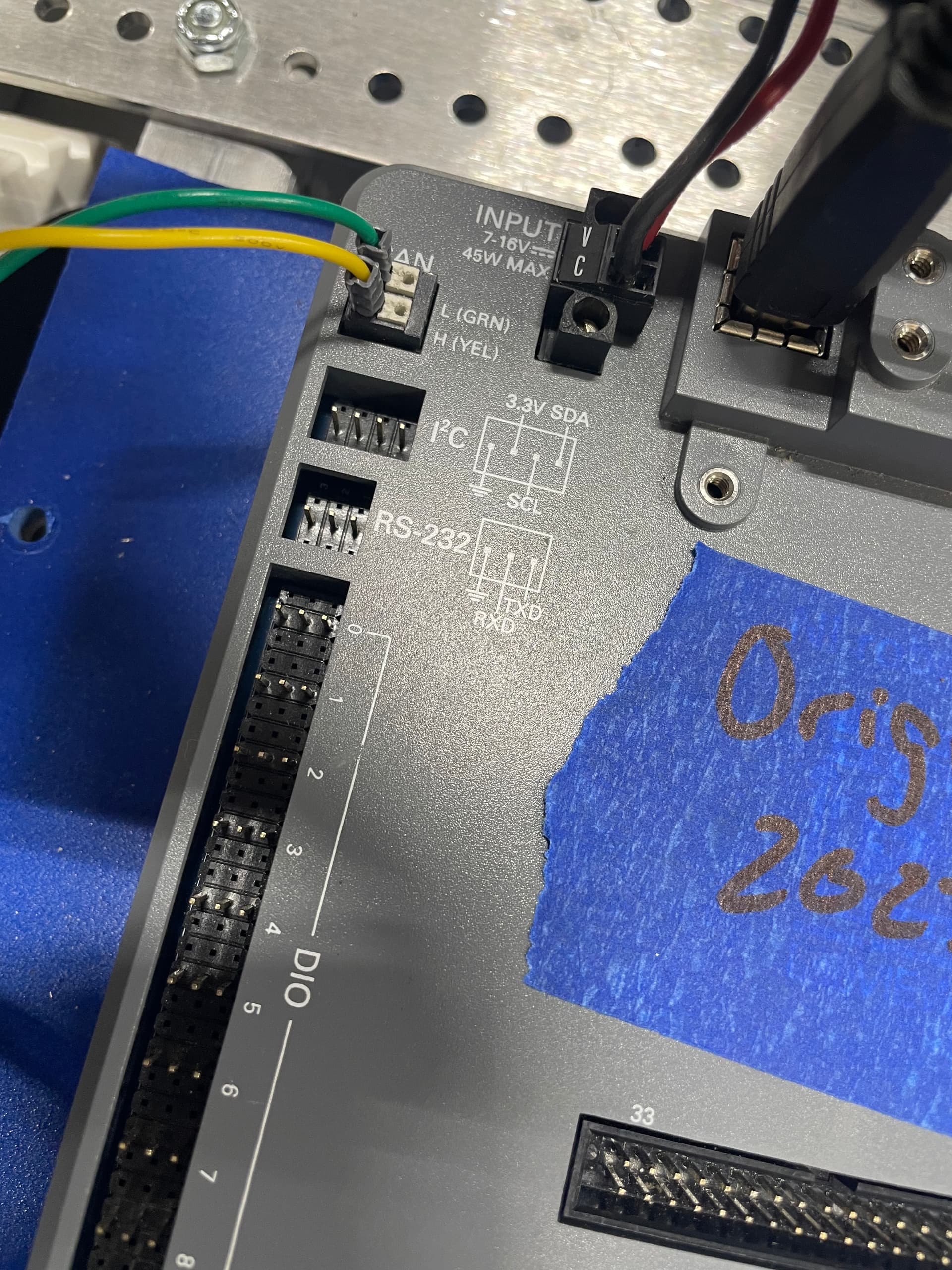

Here are some photos we have checked all our wiring the error is (RoboRIO NOT ON CAN BUS)
Thanks. I don’t see anything obviously wrong with the wiring (except that the PCM isn’t hooked in yet, of course). I’m still a little fuzzy on where you’re seeing the “RoboRIO NOT ON CAN BUS” message.
