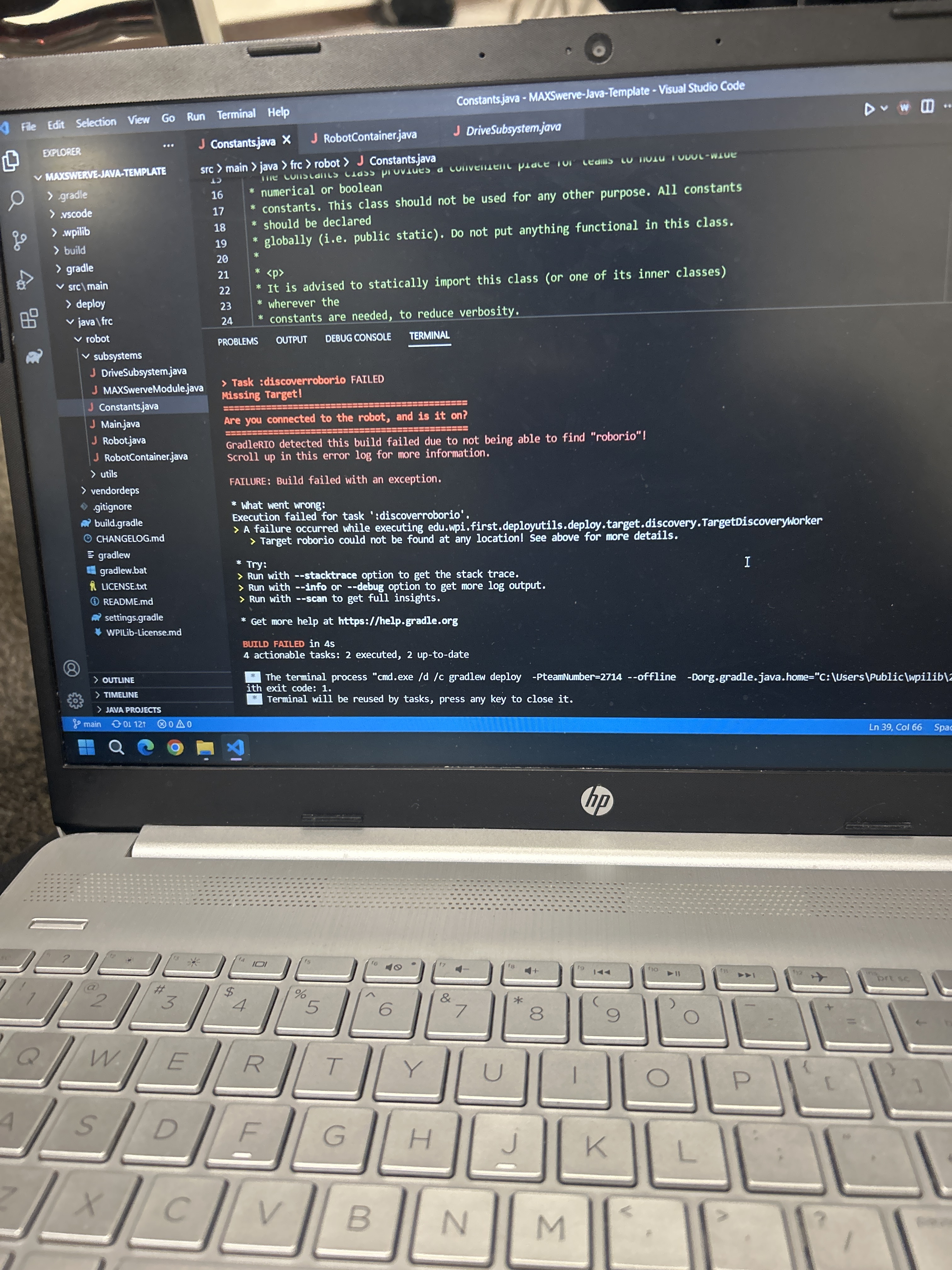

After fixing wiring issues with encoders, we tried to deploy code again, only to not be able to connect to the roborio through Ethernet or wireless. We’ve tried
  • switching out the radio
  • switching out the roborio
  • re-imaging the roborio (through direct connection through Ethernet)
  • testing wire connection
  • re-configuring the radio
The pdh status is magenta, so it’s in keep alive timeout, but nothings working
The deploy console says you are deploying as team 2714, but your ChiefDelphi account says you are on team 691. I think you need to change the teamNumber field in the .wpilib/wpilib_preferences.json so that it can find the roboRIO correctly through Ethernet.
