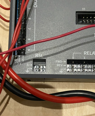

My Allen Bradley signal light didn’t come with 2 pin connector. What is the spec for this 2 pin connector and where do you get it from?
RSL
It’s a standard 0.1" pitch connector, as are nearly all of the Rio connectors. Common mating connectors are 3-wire servo cables (commonly called “PWM” cables in FRC). Just search for “servo extension cable” on Amazon or other sites.

There are several 0.1" pitch connector families that work with the roborio headers. Our choice for the RSL connector is Molex 15-57-9002 for the connector housing and 16-02-1114 for the contacts. That particular contact has a much higher mating and retention force than is common for 0.1" pitch connectors.

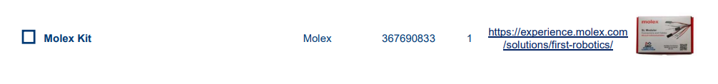

You may have what you need from KoP:
https://experience.molex.com/solutions/first-robotics/

It allows a 3 pin to be installed, you can repin a connector you already have, like a broken Sparkmax can connector
