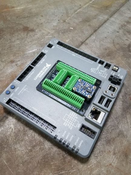

RoboRIO WAGO breakout board with built-in BO055 Gyro mount
As an off season project we designed an MXP breakout board that incorporates a mount for the Adafruit BNO055 gyro. It has push in to lock wago connectors that hold wires in more securely.

We don’t know the 2019 rules yet, but 2018’s R75 has remained pretty constant in the roboRIO era. I can’t tell whether your board is an active device or not (if so, you probably have an uphill climb), but that should get you started. :slight_smile:
R75 definitely comes into play, if you want to use the board to control any motors. Likely it would fall under part B, “via a network of PASSIVE CONDUCTORS used to extend the PWM pins”, but as an LRI having the Gyro mounted in there does present at least some level of concern. The Gyro is, undoubtedly, an active device. This would fall under part of the blue box:
The “network of PASSIVE CONDUCTORS” only applies to the pins being used for PWM output to motors or servos. This means that connecting an ACTIVE DEVICE, such as a sensor to one MXP pin does not prevent other MXP pins from being used in accordance with R75-B.
And so you would need to be able to show that to the satisfaction of your LRI - are the traces exposed on the backside? Is it easy to tell where everything is connected to?
You would also need to comply with R14, “Physical ROBOT elements created before Kickoff are not permitted” and R15, “Software and mechanical/electrical designs created before Kickoff are only permitted if the source files (complete information sufficient to produce the design) are available publicly prior to Kickoff.” So that means posting the designs publicly before kickoff, and not ordering/building the board you use on the competition robot until after kickoff. Which would make the 10 you already made illegal, and force you to make a new one each and every year you want to use it.
If you became a VENDOR, R14 and R15 don’t apply. But that isn’t as simple as offering to sell them. You need a Federal Tax Identification number, can’t be wholly owned by a team, must be able to meet general shipping guidelines (meaning you have to maintain stock), and a few other things - see page 65 of the game manual (the second page of the Robot Rules section) for full details.
The better solution would be to partner with one of the current VENDORS, like AndyMark or Vex. They could satisfy the VENDOR rules for you and help you get the part out to all the teams that want it.
Everything is completely passive and the BO055 is not actually part of the board. It’s something someone can buy from adafruit and add themselves.

The key is “Board we have custom made in china.” The first page of the Robot Rules defines COTS as:
Many rules in this section reference Commercial-Off-The-Shelf (COTS) items. A COTS item must be a standard (i.e. not custom order) part commonly available from a VENDOR for all teams for purchase
emphasis mine.
You would hare to order the board after the season starts, based on design files that were publicly posted prior to kickoff. It qualifies as a COMPONENT or MECHANISM, but not as COTS.

Nice board! I made something similar last year. Unfortunately we never got a straight answer regarding the legality of our board, even though it was passive, like yours. We even went as far as taking a sample to HQ during FTA training, and still no definitive answer. The other issue with making custom PCB’s is you have to get them made during build season in order to comply with the rules. It’s frustrating and in the end we gave up on the idea.

Sorry, you are correct, they are not Wagos. These are from Pheonix Contact but essentially the same as the PCM and VRM connectors. I will say that seem to hold better than those on the VRM/PCM.
