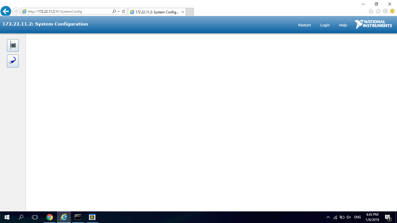

We tried to access the Roborio Webdashboard after installing the new 2019 NI system, and only a blank page shows up. We are using Internet Explorer, and have comm with the rio. Any help would be appreciated, thank you!
The new page does not work in Internet Explorer or Edge. You need to use either Chrome or Firefox.

Edge is because it does not like connecting to mdns or raw IP addresses. It does weird things with security, so it just refuses to load. Its weird.
You’re looking at old docs. The dashboard doesn’t contain any of those things anymore. To configure CTRE’s devices, you need to use their tooling.
