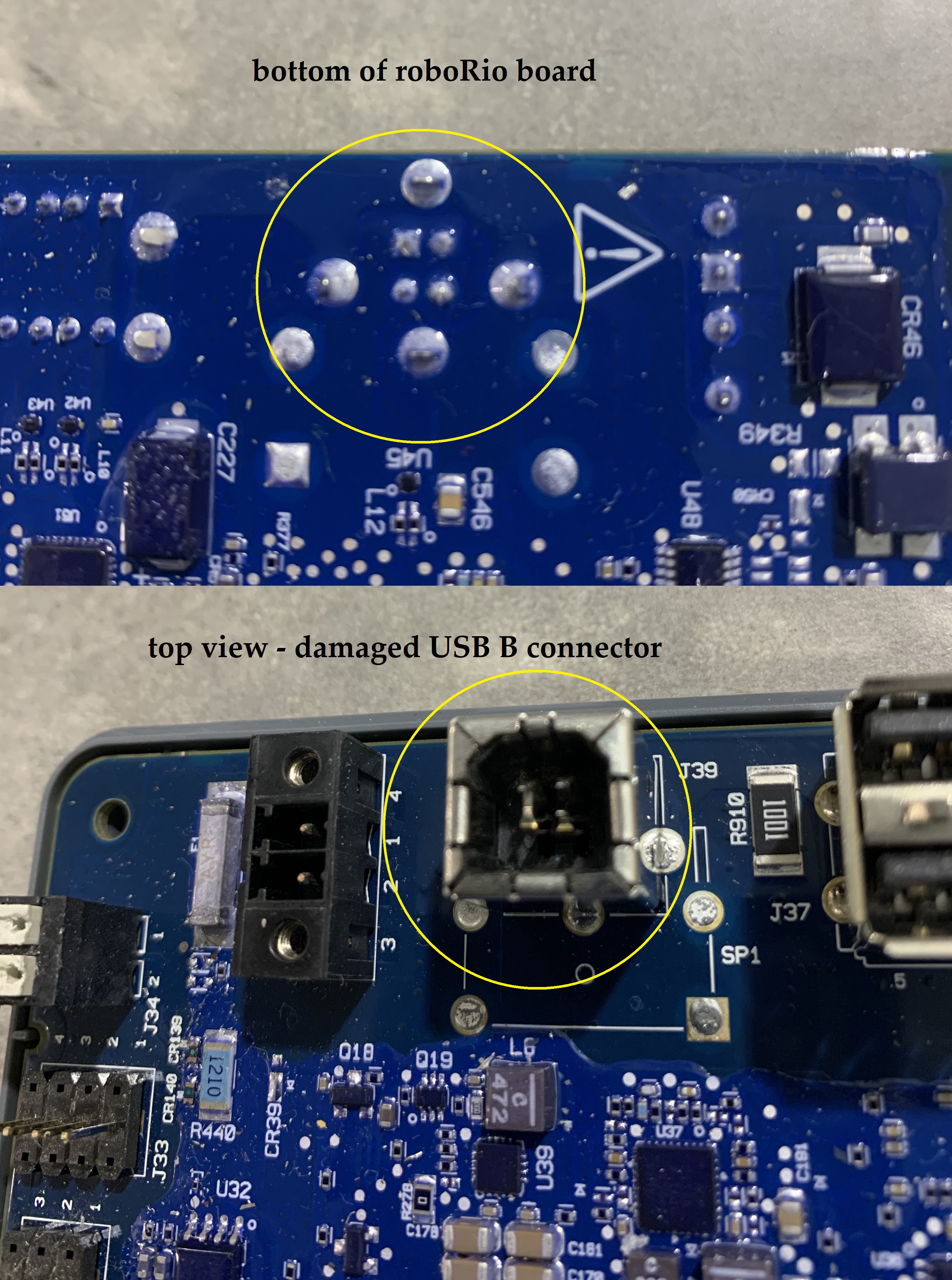

I have 2 ROBO rio 1’s that are broken and need repair. I asked National instruments and andymark to see if I can get them fixed. National Instruments said that the serial numbers are expired and couldn’t really help because they were purchased through andymark. one can’t image the other has a broken USB-B port on it. any. places to send them to to get fixed?

But what specifically is broken? There’s several ways they can break ranging in fixes from you could possibly do it yourself without avoiding any warranty to, crack it open if you get nowhere with support and desolder the old connector and replace it yourself voiding any warranty.

I agree hence why I said follow up on the other links. However as the OP noted in the other thread I shared, in the end they were asked to pay $400 + shipping to have that USB replaced. That’s just about as much as a new one. If that’s what following through with support gets them to then I don’t see what poking you will do to change that portion. Not having done the process with NI myself idk if that’s true, but if it is I’d much rather do it myself and save that funding for the team.
Worst case if the repair didn’t work we’d have to buy a new one for the same price and it would be a new 2 rather than an old refurbished 1. In that situation the latter option seems like the optimal solution with minimal risk to adding to the cost, while having the highest payoff potential in savings.
If you are willing to take the risk and know someone who can desolder the old port and solder the new one you can buy a new port from Digikey.

So what’s actually broken is the interior was ripped out in a match and has been broken ever since.

1.81$ for the port.
This may sound a bit weird but where could I ship the Rio to to get the port soldered?
