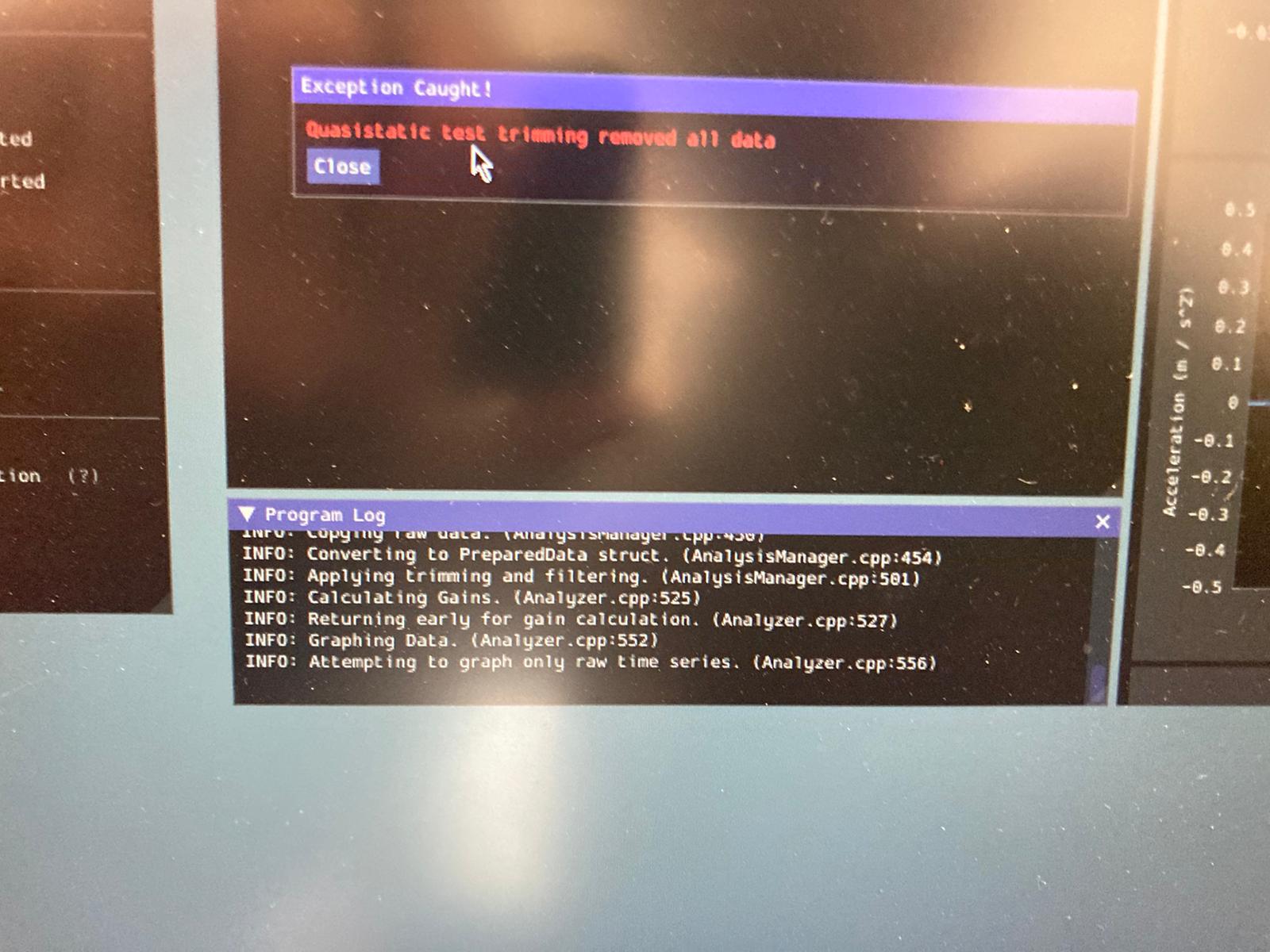

Robot Characterization Error
Whenever we try to run the quastatic test on this years characterization tool we encounter this error? What can be the reason?
Your motion threshold is too high, or else no data was sent back due to an error.
