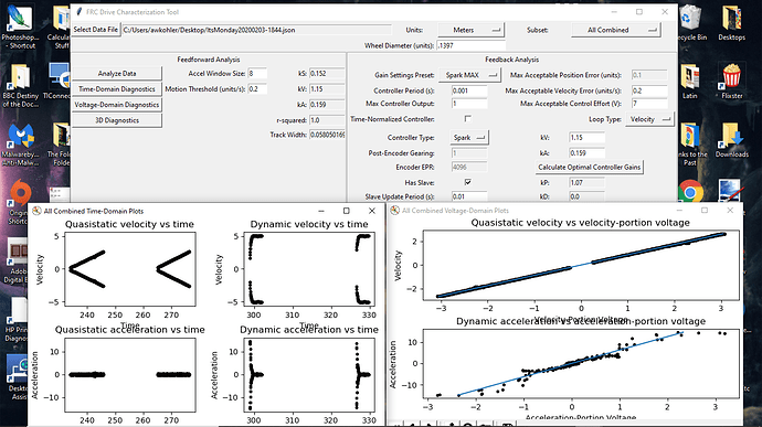

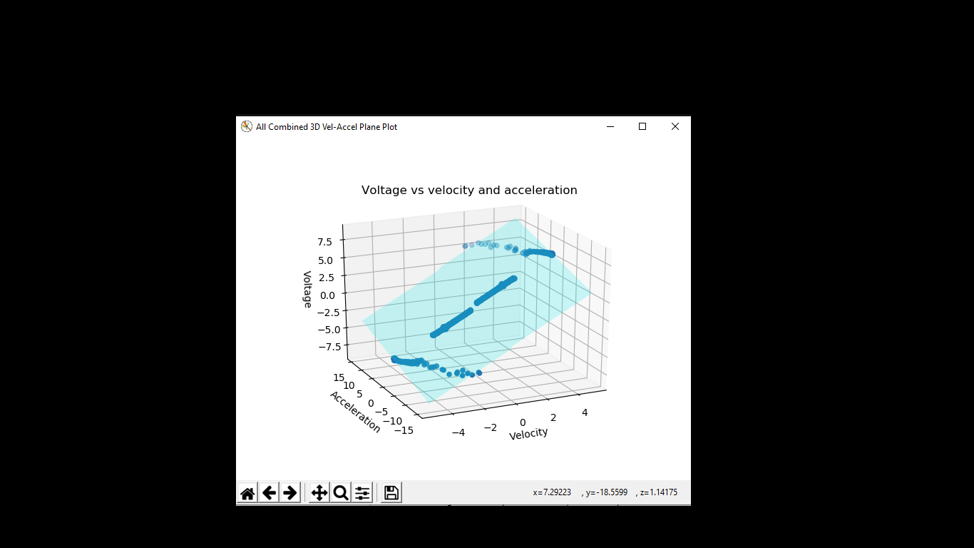

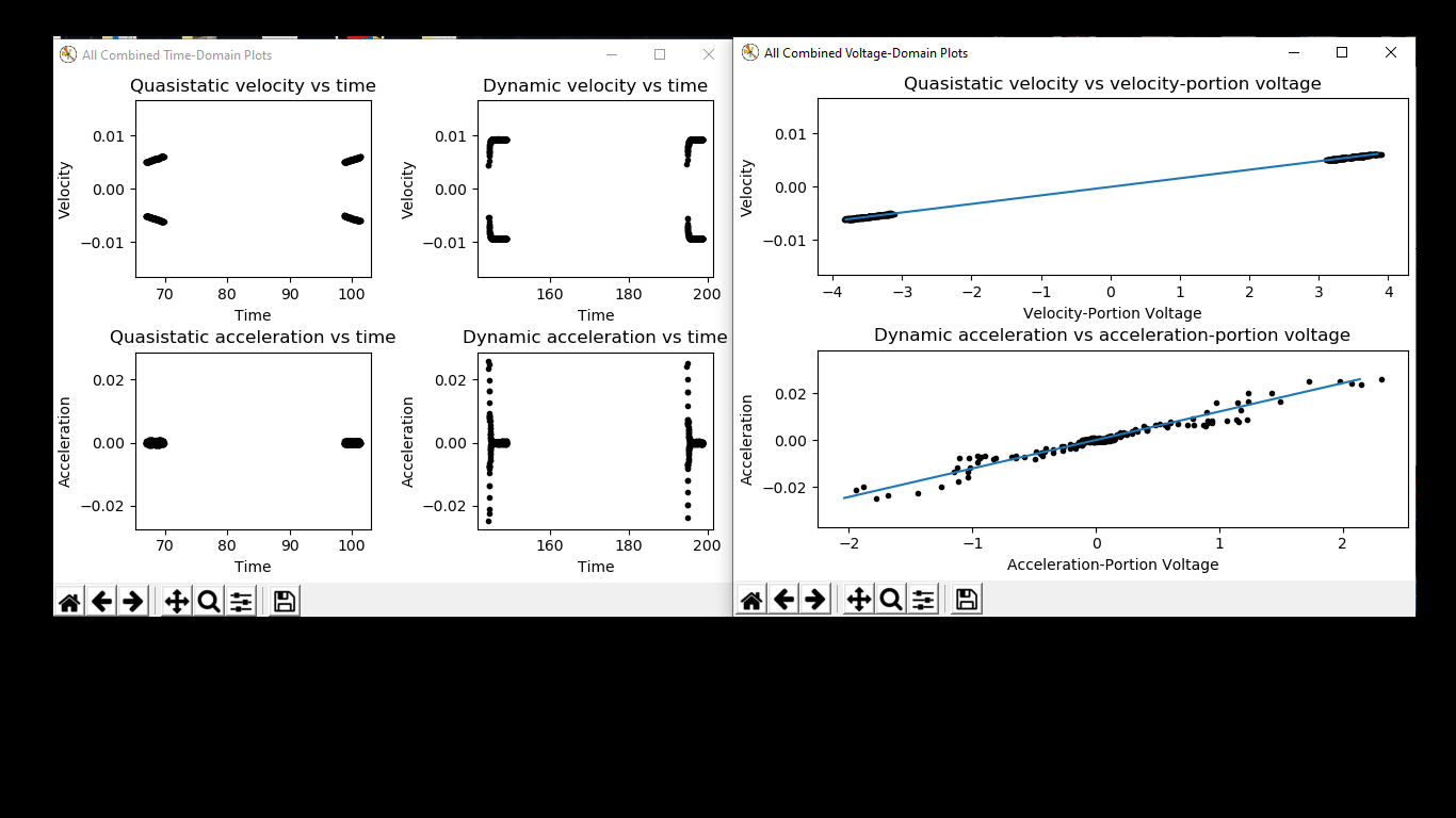

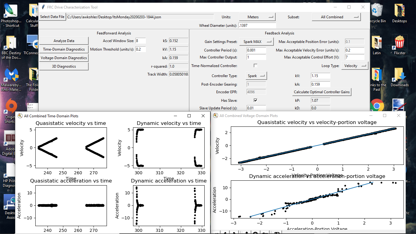

I’ve been using the new characterization tool, and up to this point it’s worked to a tee. However, I recently had to re-characterize our test bot because the competition drive was fitted to it, and the gear ratio changed to 4-to-1. Now when I run the routine, the encoders are returning much lower values and (more importantly) the data analysis tells me that the quasistatic data isn’t reaching the motion threshold. We are using CANEncoders and brushless motors , and working in Java.

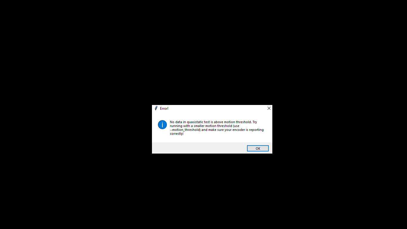

An image of the error the data analyzer gives me

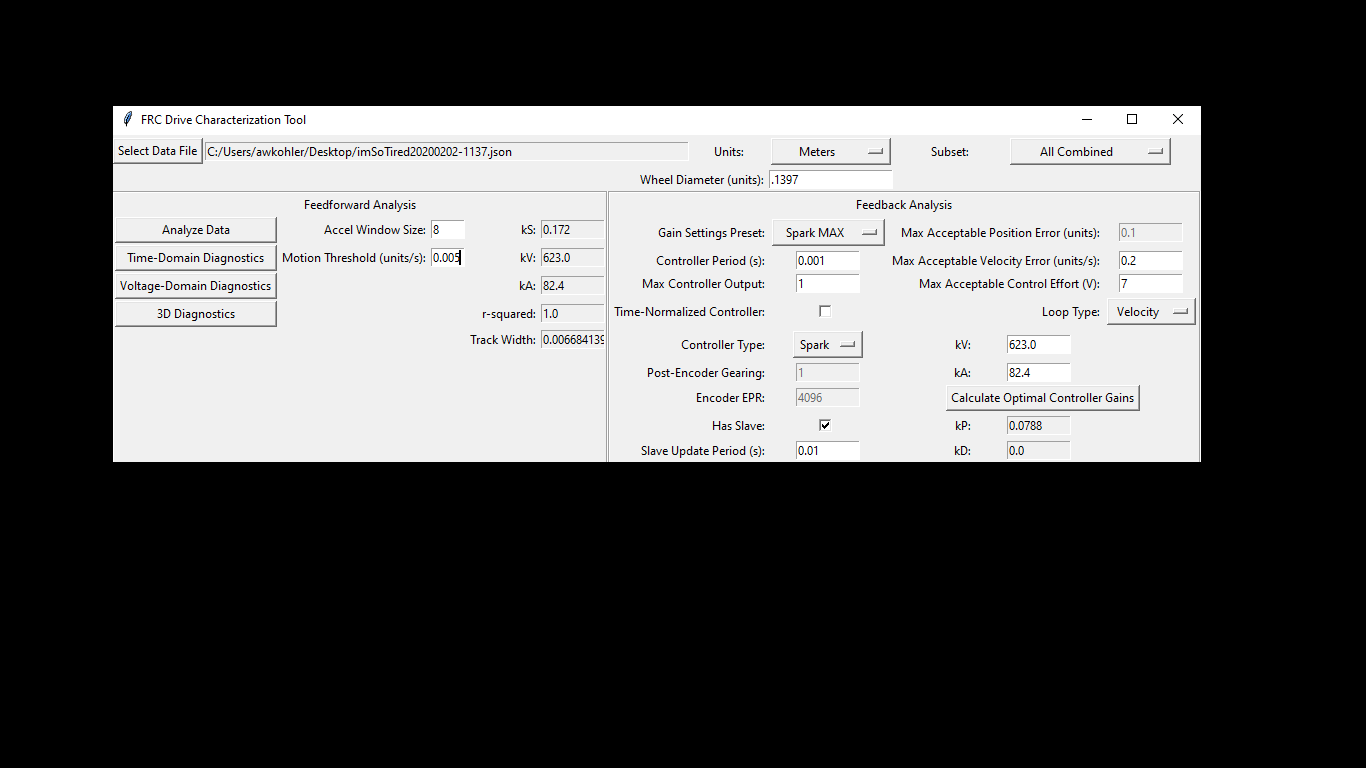

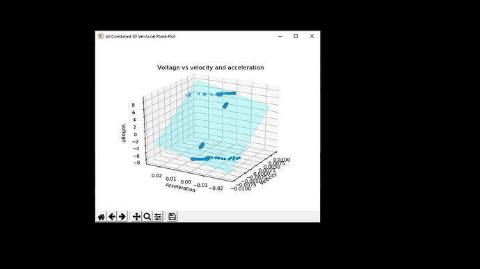

The data the analyzer tool gives me at a motion threshold of 0.005, the highest it goes before giving me an error
