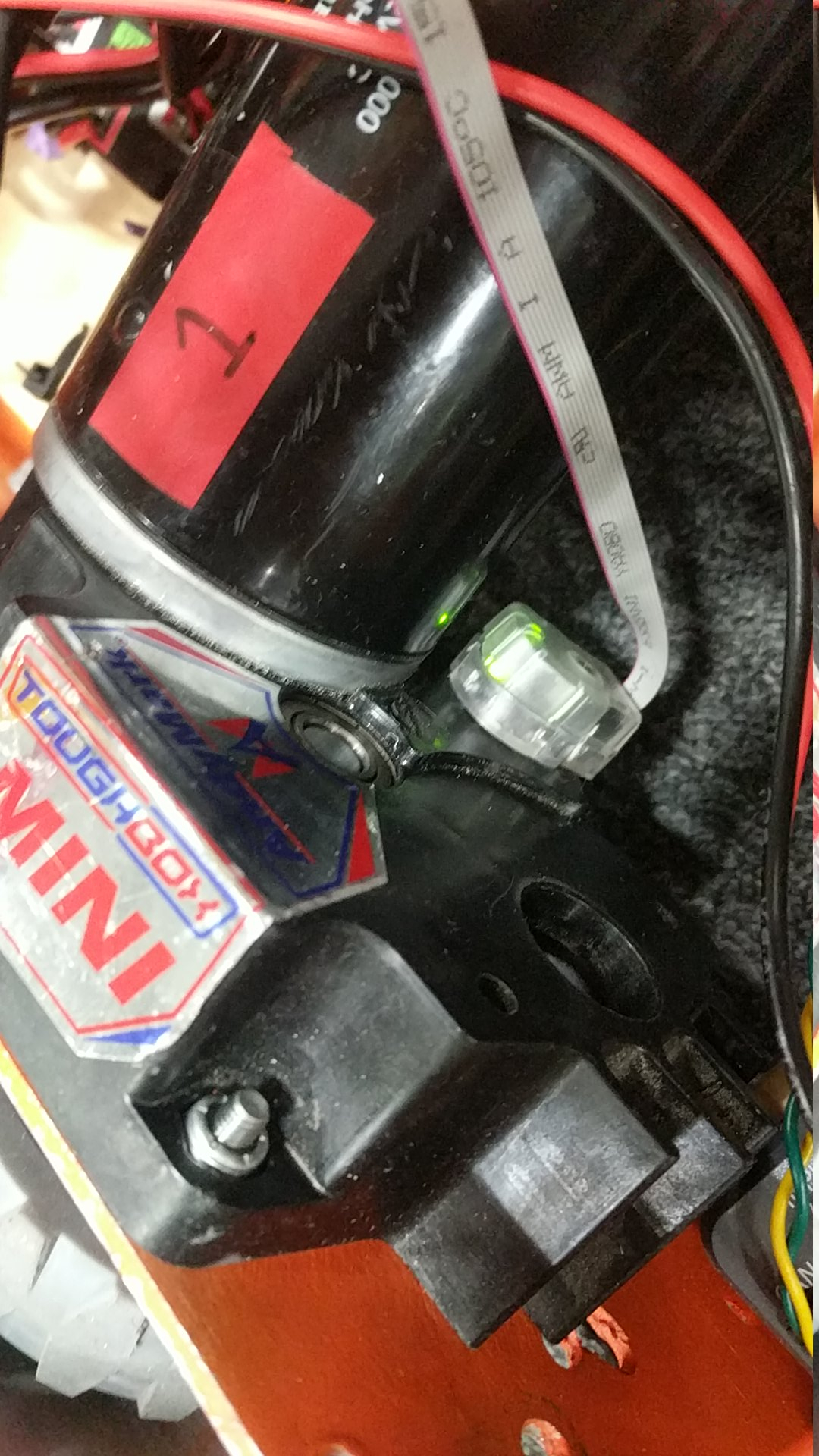

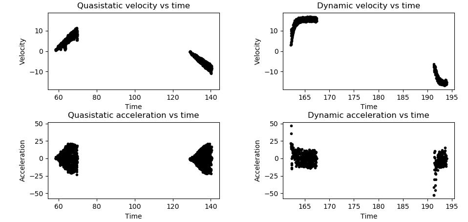

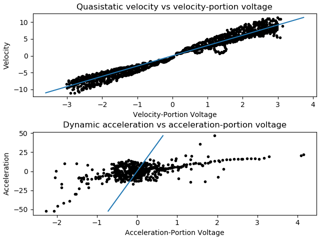

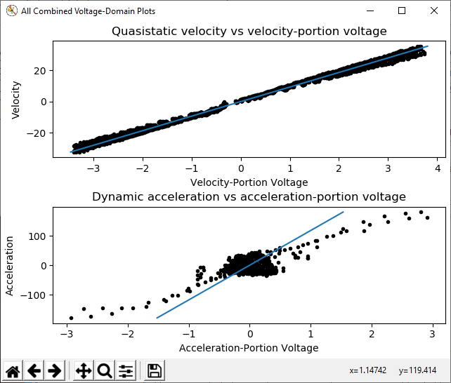

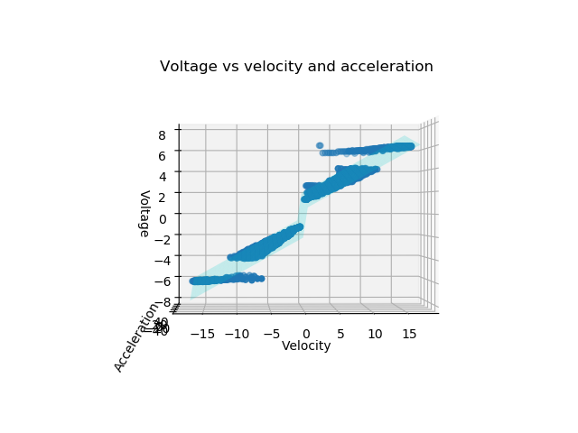

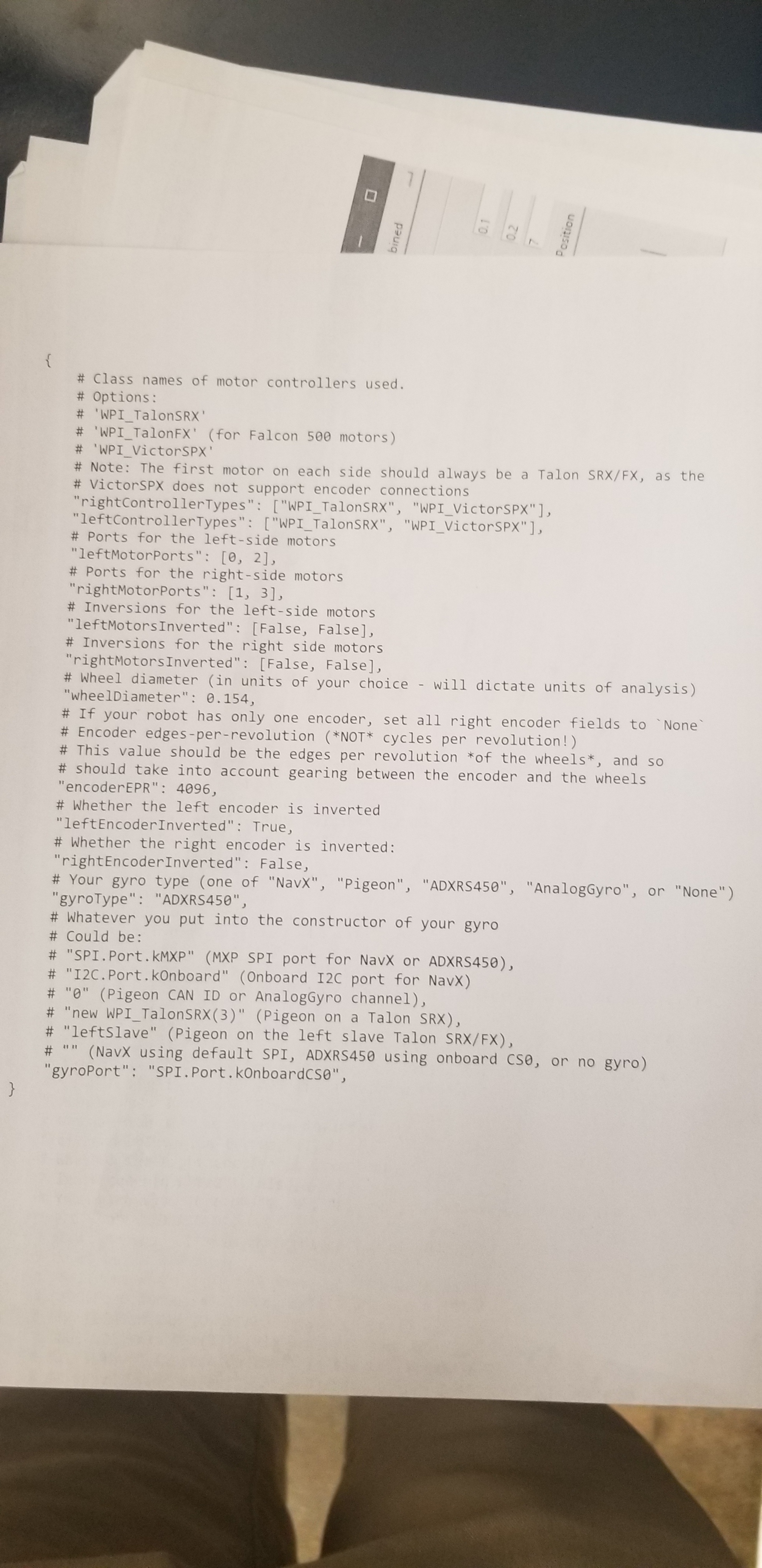

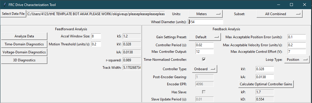

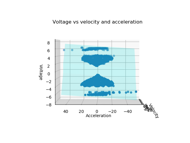

I know this isn’t correct for a characterization but there doesn’t seem to be anything wrong with our set up. Does this tool not like mag encoders?
