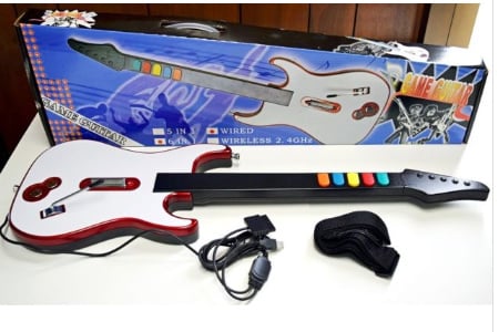

Flair ?
Guitar Hero Controller image
Functional ?
Well, that part I’m not so sure on. :nerd_face:
-Russ

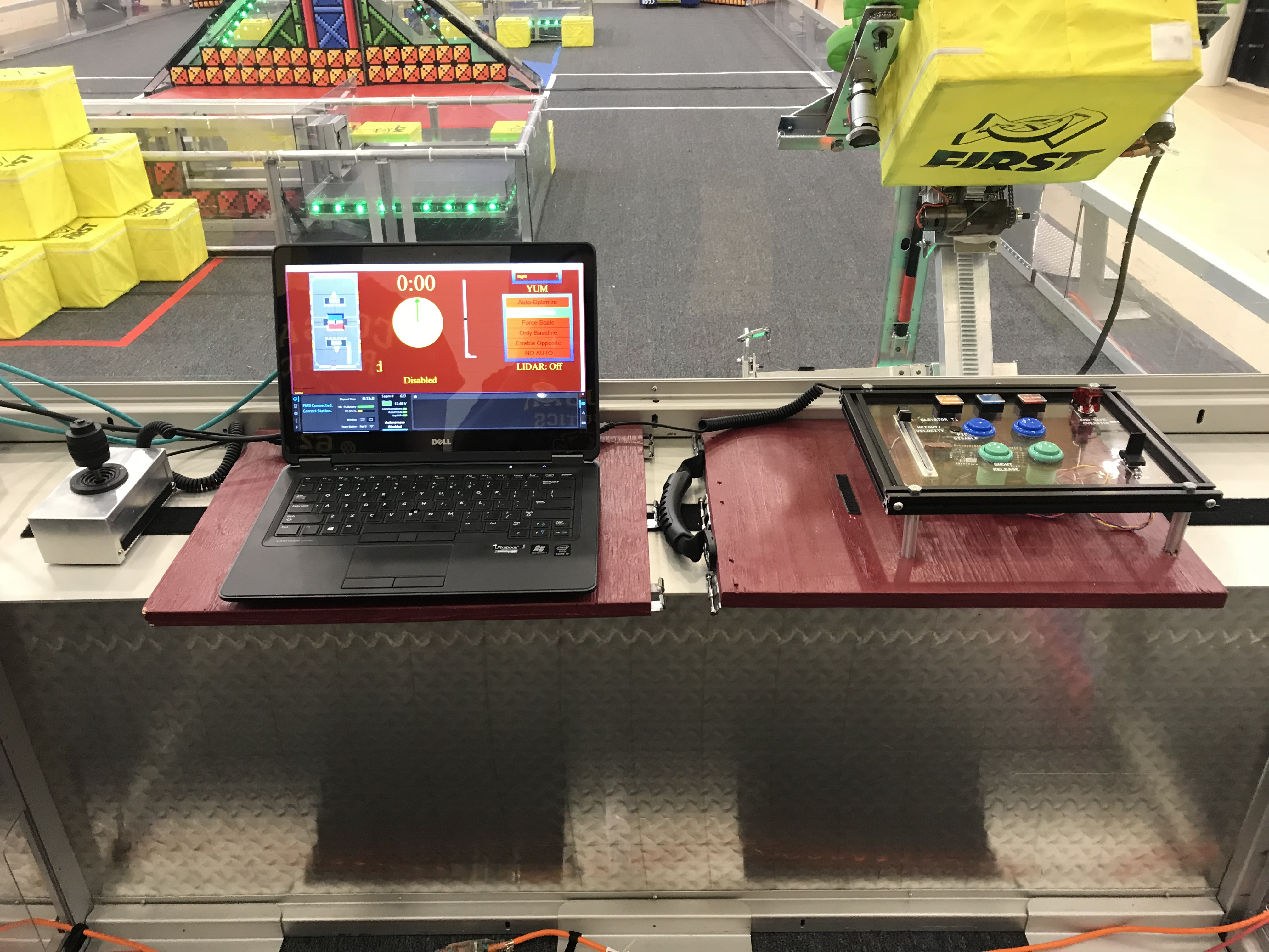

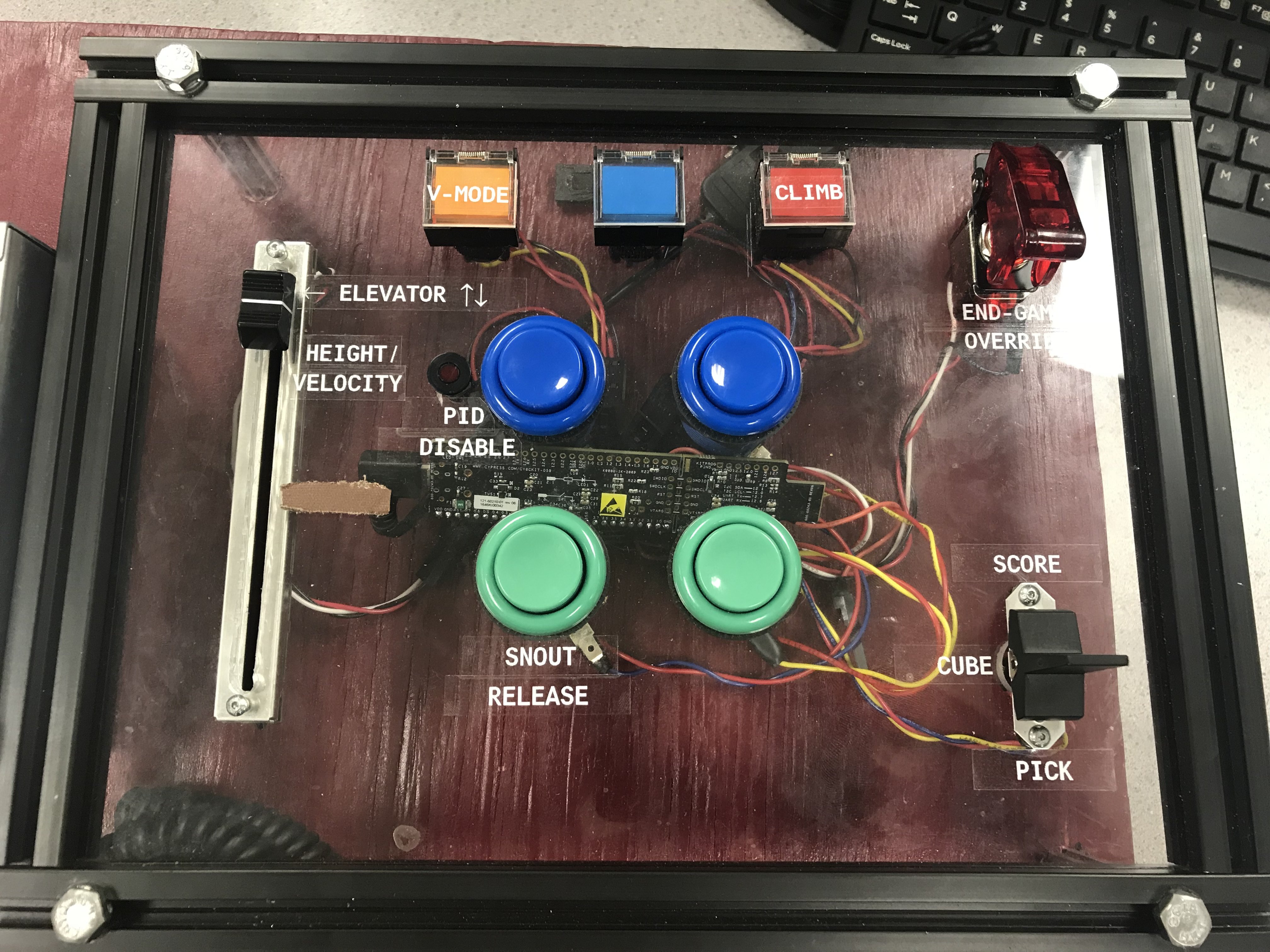

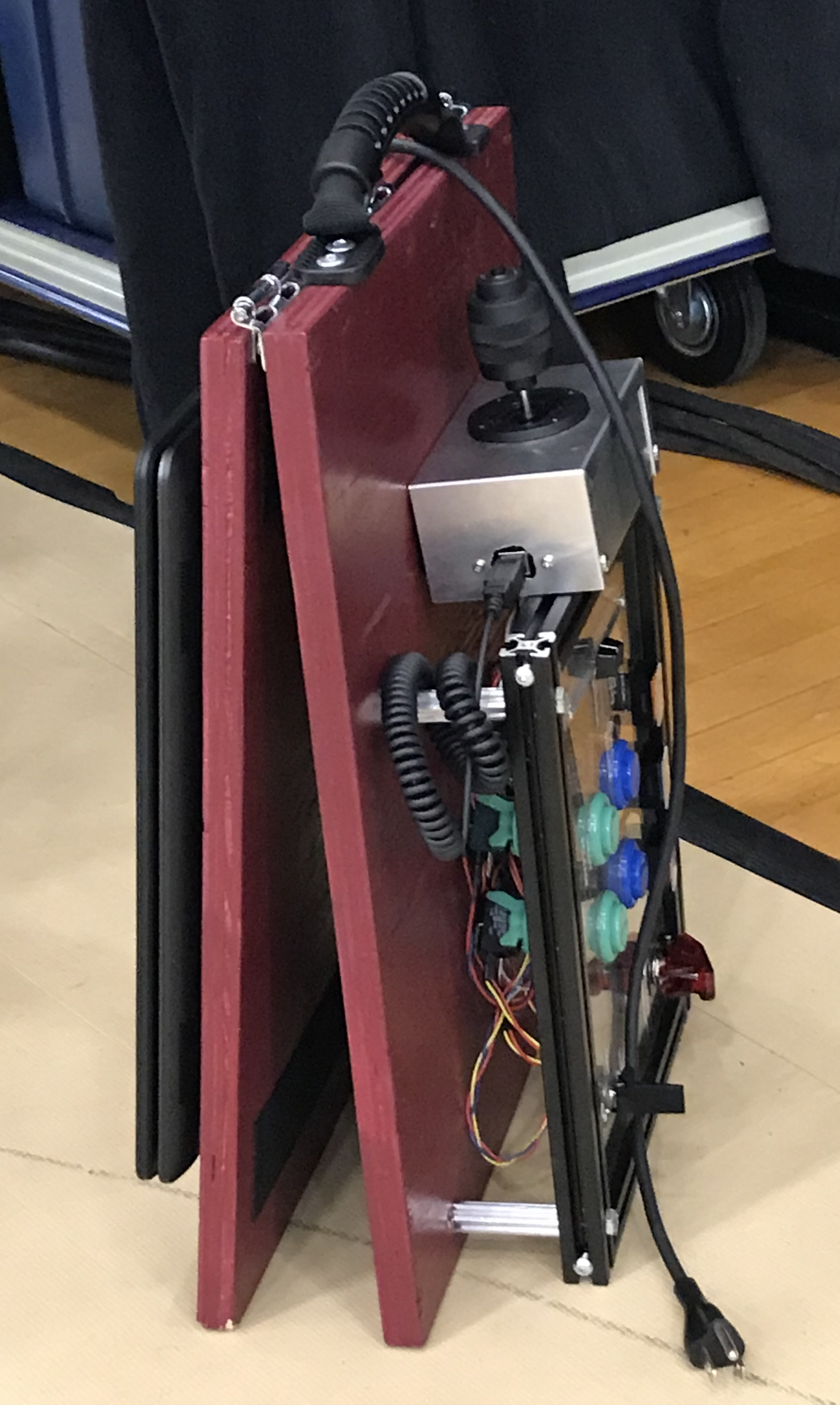

We’ve been building custom button boards for several years and highly recommend it. Last year we built our own joystick, too.
When we’re designing the control layout on the button board, we consider what the operator will be doing the most, and put these controls somewhere comfortable, usually the left and right sides of the board, with the expectation that the operator will have hands on these controls for most of a match. Things we don’t want hit accidentally (e.g., one-shot climb) go near the top of the board and have some sort of cover. “We hope you don’t need these controls in a match, but we’re giving them to you in case something goes wildly wrong (and oh, by the way, we want these controls available for testing too)” controls go in the middle of the board.

1405 used one for the operator in 2016… it was mentioned in one of the Einstein interviews that year.
Effective? Dunno, since I only saw them playing hardcore defense on Einstein that year. But it was unique.
I know quite a few teams who use gas pedals and steering wheels for driving. We don’t we use two Xbox one controllers
We used the guitar hero controller for our hanger that year. The buttons would rotate our scissors, actuate the scissor lifted hooks, and engage the winch to lift us up. Sadly some parts of our hanger broke while we were playing on Einstein and we didn’t get a true hang during those last few matches.
Do you know which version of controller they used? I was thinking about trying to do this and I was wondering if PS2 with the adapter would be best or PS3 or some other choice.
