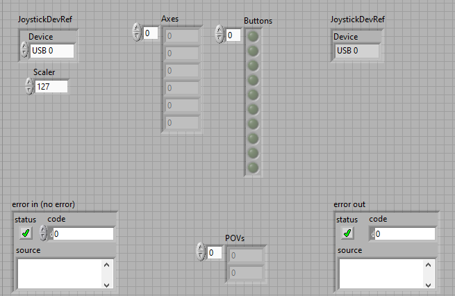

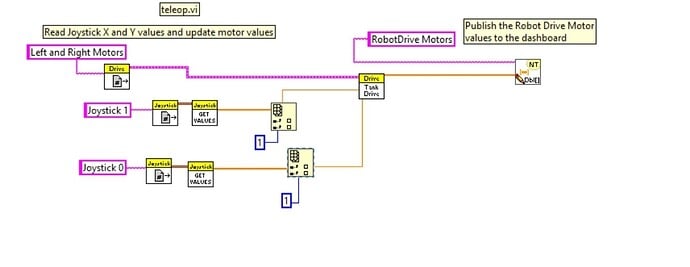

Is there a specific value that I’m not seeing because I thought the only values to change were the numeric constants going into the index array.front panel for getvalues module-1

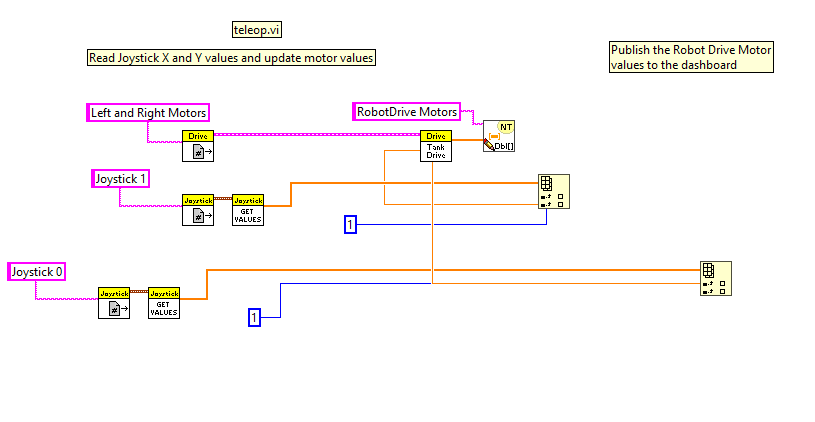

You might get that behavior if one of the index arrays was miswired.
We can’t tell from your snapshot because the wires are crossing underneath.
If you can use Clean Up Diagram we could see your wiring better.
CleanUp

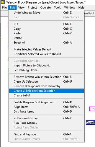

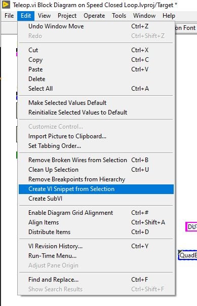

Or highlight that code and use Edit->Create VI snippet from Selection to export the actual code for us to check out.
Sorry about that, cleaned it up a little bit
The nodes of all of the wires coming out of or into the Index Arrays are obscured.

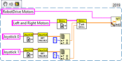

Here is what clean wiring looks like:
You can see the nodes where each wire comes from and goes to.
BasicTank
This is also a code snippet.
You can drag this onto a block diagram and it will become LabVIEW code.

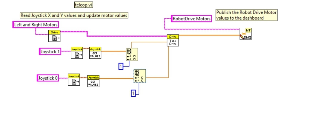

This is what I got Teleopvi5
That looks fine.

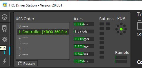

I’d check the joystick outputs to be sure of what the sticks are doing.
You can use the Driver Station USB tab (no robot required).
  • the joysticks should show up in green on the tab.
  • highlight one of them and see if the Y axis is the only one moving and you’re getting the reading that you expect.
CheckJoystick
(can’t find my joysticks, so I used an xbox game controller for the example above)

You are setting Left and Right Motors in both Periodic Tasks and in Teleop.
Pick one place.
Periodic Tasks is also using both X axis instead of the Y axis.
So you’re getting a random mixture of X and Y axis from both joysticks.
