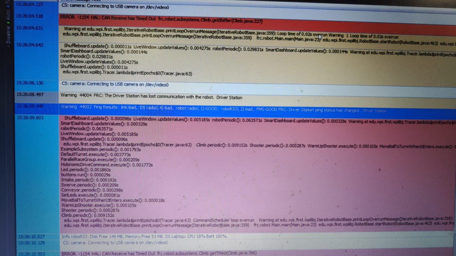

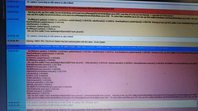

Here are some images of our logs that matches:
It’s hard to tell from screenshots, but it looks like you’re remaining in contact with the radio, but losing contact with the roboRIO. I think your disconnection times are too short to be a roboRIO reboot. Possibly you are losing power to your switch. How is it powered?
I notice your battery voltage is dipping. Is it possible that your bad games were all with the same battery? You might want to check that your battery terminals and wiring are solid. Also, next time you have a bad match, check for hotspots in the power wiring, from the battery terminals to the switch.
Oh, and probably not your problem, but I see loop overruns in robotPeriodic. You should check on that. What is it doing?

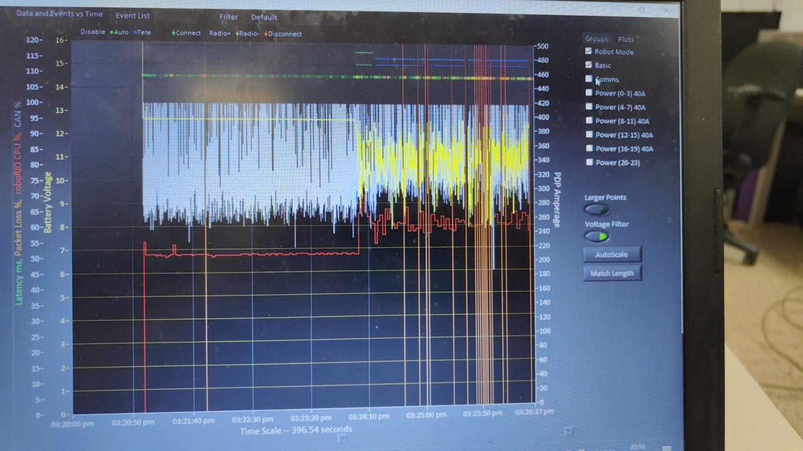

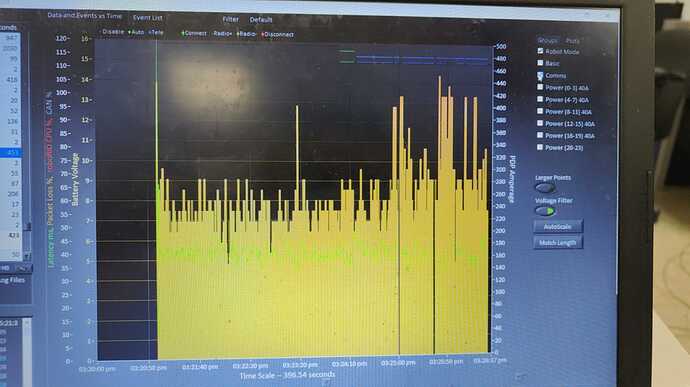

Can you post some full DS logs?
The packet loss in that log is through the roof- consistently 50%, with disconnection events coinciding with spikes of 80-100% loss. Additionally, latency is 40ms (two full DS packet cycles) throughout the log.

This is the DS log of the match.Disconnect logs.zip (81.1 KB)

Thanks for the logs. Some notes I made:
  • During teleop, you had 19 disconnection events, none during auto. The disconnections seems to last about a second.
  • There are no “Time since robot boot” messages, which suggests that the roboRIO did not reboot.
  • All the ping results show “link-bad, DS radio(.4)-bad, robot radio(.1)-GOOD, roboRIO(.2)-bad, FMS-GOOD”. This suggests that the DriverStation can contact the robot radio, but not the roboRIO.
  • I also see “Info Communications Timeout: NN Input Voltage Brownouts: 0.”, with NN going up to 31.
  • Packet loss is about 45% throughout, peaking to 100% (or more!). The peaks are often synchronized with the disconnections.
  • Latency is steady at about 40ms.
  • Laptop CPU remains at about 15% CPU.
  • CAN utilization is steady at about 75%.
  • Battery voltage is around 10.5v, dipping to 8v at points.
  • I see a lot of messages throughout: CS: camera: Connecting to USB camera on /dev/video0
  • There’s a few messages about “HAL: CAN Receive has Timed Out”, which seems to be from Climb.getTilted().
