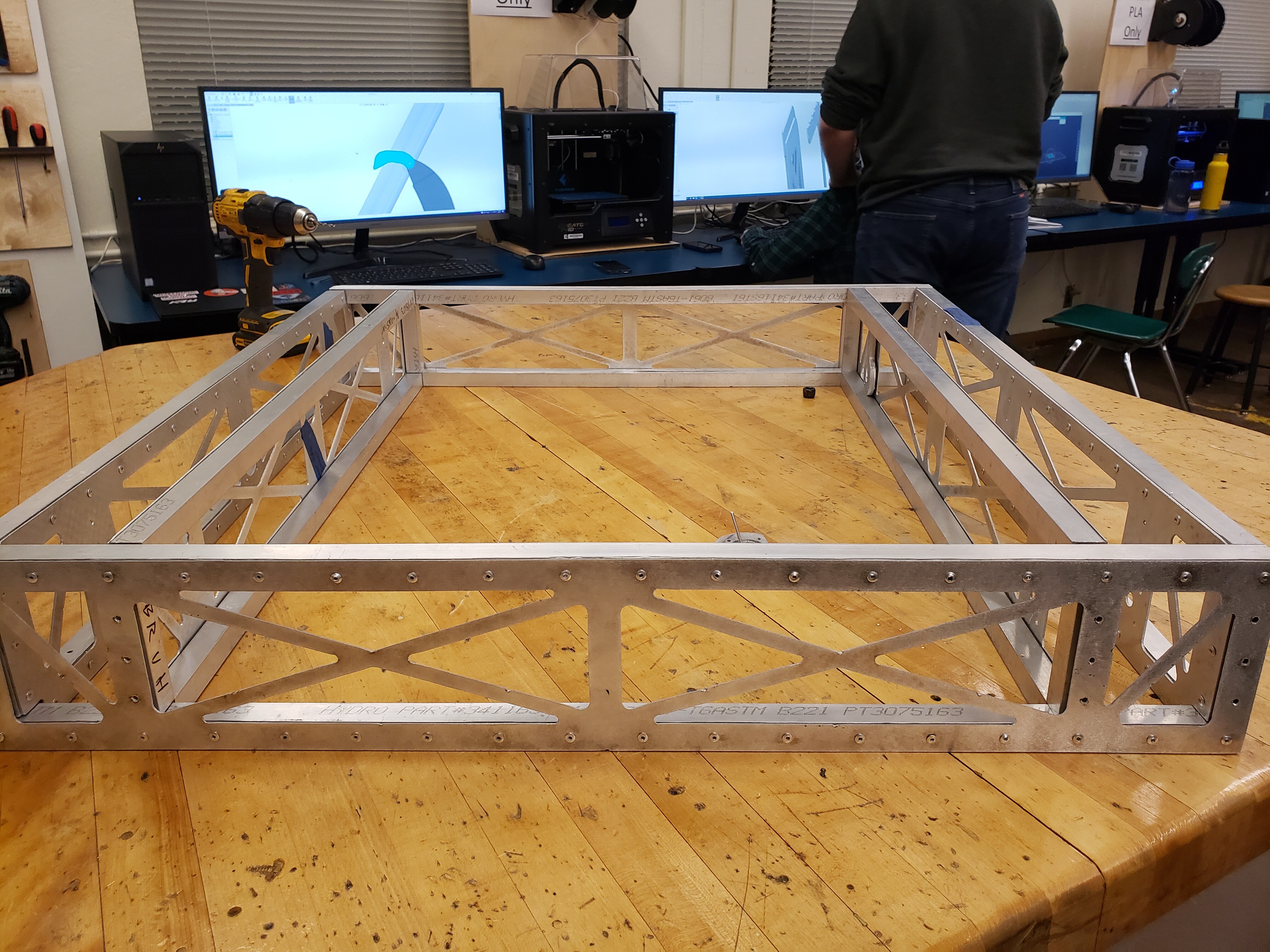

In addition to everything said here (nylocks, loctite, and nord-locks).
Blind Rivets(aka pop rivets) are often used in many FRC fastening applications and they won’t come loose from vibration.
Nylon Nuts are your friend, also blue Loctite for tapped holes. but do NOT use Loctite with polycarbonate or lexan. For that i would get sufficient preload in cases where they can be checked periodically or make use of nordlock washers or something of that sort.
We like to use 3M 4910 VHB tape between the parts we are riveting.
Could you share your experience and process there? Seems almost it would act like a spring lock washer. Well, how those are supposed to work.
Our construction is plasma cut .063" thick aluminum attached to .75" square tubing. The VHB is between the parts. We have undersized holes in the sheet and match drill rivet holes.
Is that something you compensate for in CAD? Is there a magic number for compressed VHB? Though I notice the assembly here is unaffected by the additional thickness. edit: except for the width of the “wheel well”
I’m totally trying this out the next chance I get; gussets starting to wobble a bit across the season eats at my soul.
Sorry for all the questions but I literally never though of putting something between riveted tube/plates.
Could you ELI5 the advantage of putting the VHB between riveted parts?
