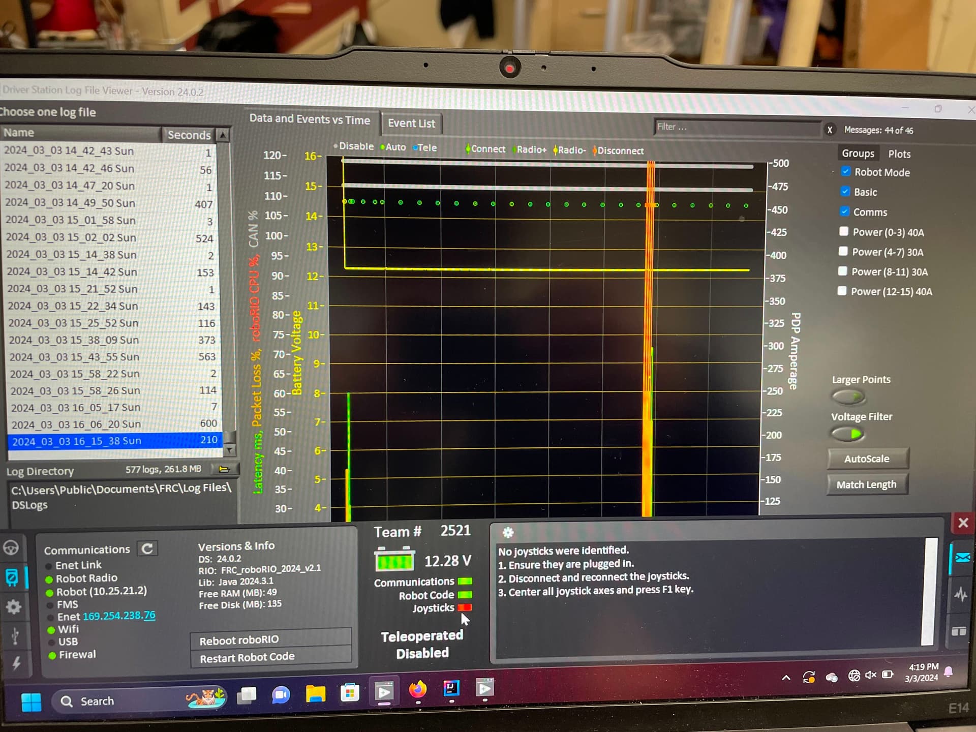

Our robot is consistently having periods of rapid comms loss, where it rapidly disables and enables, causing our bot to stutter. Here’s a video of driver station having a seizure, and attached the portion of the log file where it happened.
IMG_0701 (1)
Our radio is powered PoE by the Rev RPM, which has a 10A breaker and is connected to the Rev MPM. It is mounted on a high point of the robot, with a direct line of sight to the laptop, far from motors. Our laptop has all firewalls and security turned off completely, and we are using a 5-port brainbox ethernet switch powered by MPM 10A.
If anyone can help, it would be greatly appreciated, as the robot as it is right now is unusable, and we won’t be able to compete if this issue persists.

What version of DriverStation, WPILib and roboRIO image are you using? (Check the Diagnostics Tab.)
Can you reproduce the problem with an Ethernet tether?
Did you set the team number in the roboRIO image?
I don’t think this is the cause of your problem, but I believe this setup would violate R617.

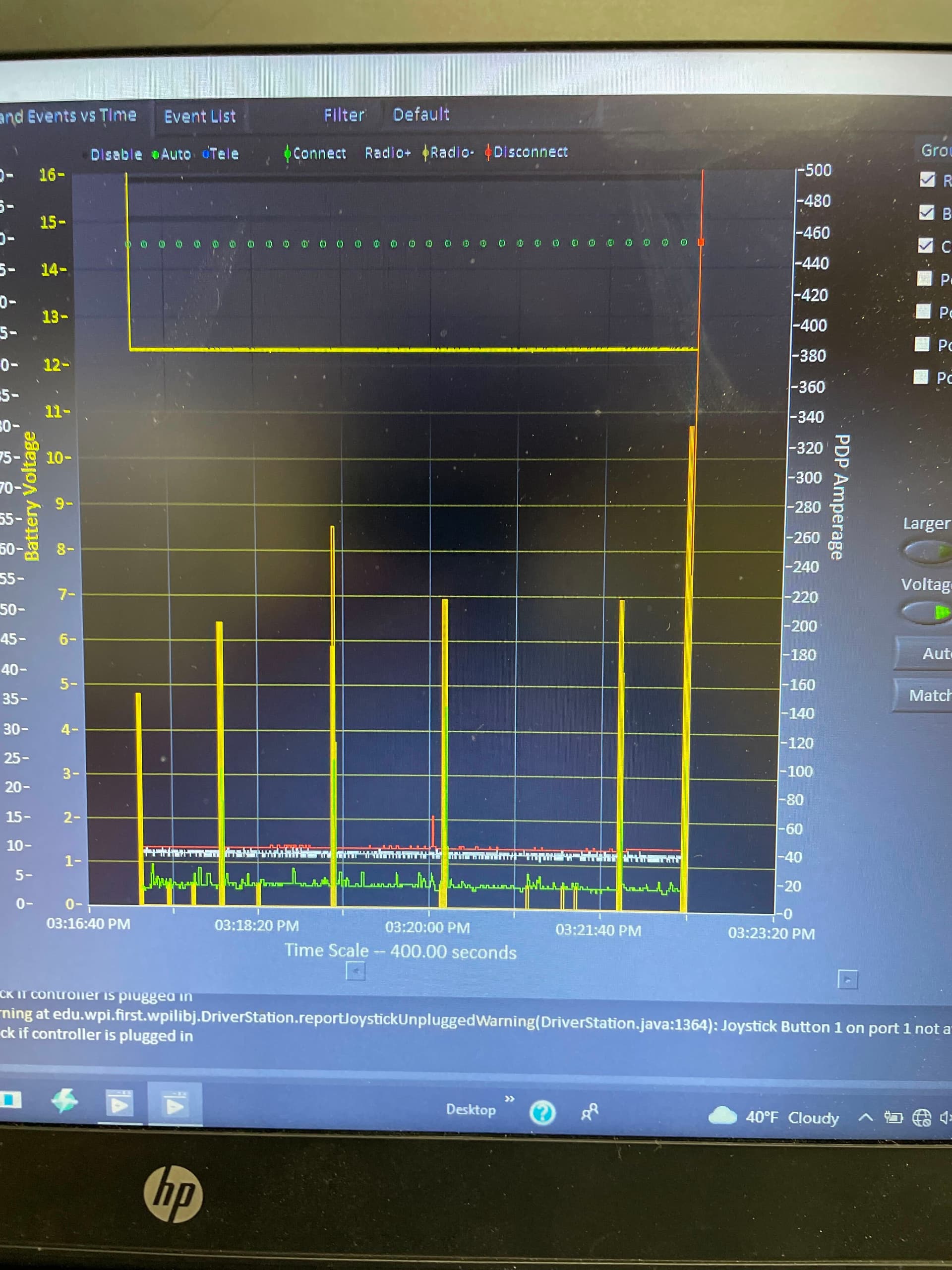

In the second graph view, the disconnects occur almost exactly every minute. Is the driver station machine a completely clean Windows install with nothing but the DS package?
We’ve seen this exact issue on a fresh DS install. Exiting and re-opening DS usually fixes it for us.

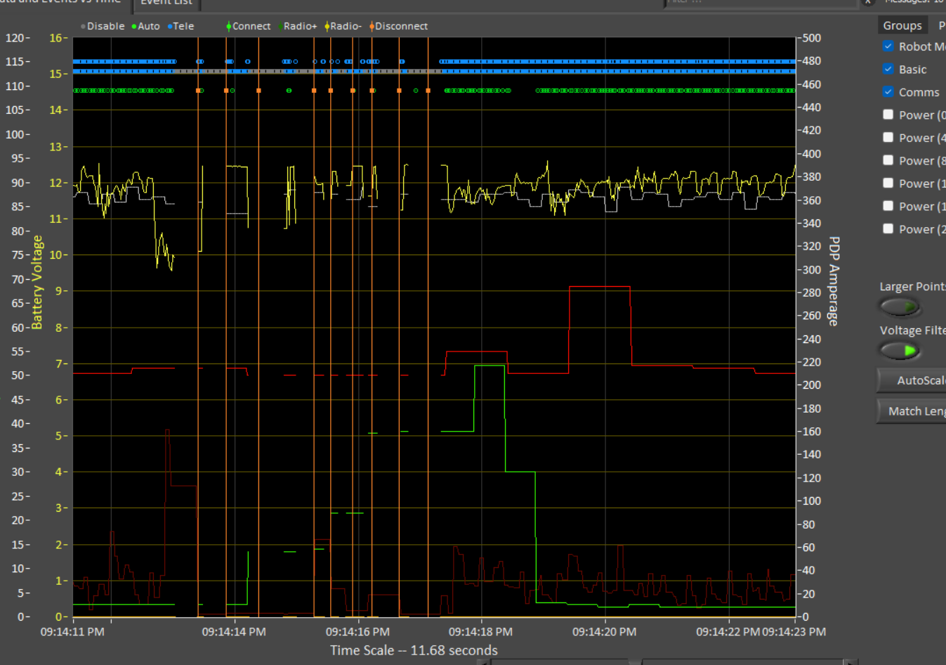

My team has been having similar troubles throughout this season, and they’ve done some pretty thorough troubleshooting. The issue appears to be isolated between the Driver Station and the radio.
  1. Ethernet or USB tethering into the RoboRIO directly: no problem.
  2. Ethernet tethering into the network switch (connected to co-processor, RoboRIO, and radio): no problem.
  3. Wireless or Ethernet into the radio: communication seizures.

We tried the 2022 Driver Station software, and did not notice the same issue, though we did notice some intervals of abnormally high packet loss that seemed to align with when we’d receive disconnections in the 2024 software.
I am very confused by this combination of symptoms. For some reason it seems like the 2024 Driver Station has some issue connecting via the radio. If it was just a noisy wireless environment, I’d expect the issue not to happen tethered into the radio. Does the 2024 Driver Station have less tolerance for lost packets before showing “No Robot Communication”? What’s causing those lost packets in the first place?

The timing checks were tightened up for 2024, so yes, I believe this is likely a symptom of that.
There can be a variety of reasons, both hardware and software. Some background updaters (e.g. Inventor) are notorious for causing these kinds of issues. On newer laptops the cause may be power optimizations (either the CPU or WiFi adapter going into a low-power mode) or packet coalescing on the built-in WiFi adapter (a lot of laptops now prioritize power or throughput over latency). Sometimes you can find advanced adapter settings in Windows that can help. Also make sure your laptop is in “high performance” power saving mode.
It may be worth trying to use a separate WiFi router/bridge to connect wirelessly to the robot radio, and connecting the laptop to it through Ethernet. That would at least exclude the WiFi adapter from the equation.
I want to second @Peter_Johnson’s suggestion of using a wireless bridge device instead of the DS laptop’s wireless adapter. Windows and wireless drivers try to provide good behavior for people moving around with their laptops. Networks come and go, some APs are “better” than others; it’s important to conserve battery power; etc. All this means that Windows and drivers are optimized for quite different use case than driving a robot.
Many (not all) home router devices can be configured in “bridge” mode where instead of providing a wireless access point, they instead connect to an existing AP and connect their ethernet ports to that AP’s network. Use of one those to bridge your robot radio’s WiFi network to an ethernet port and locate it close to your driverstation.
When you connect the DS laptop via ethernet to such a device you get rid of all that complicated behavior of Windows and the wireless adapter. The router also probably has way better antennas and more power than the laptop’s wifi adapter.
I experimented with this setup this morning in an environment where I would typically get the rapid disable/enable cycles, flashing red and green on the dashboard, and sawtooth displays in the timing window. Problems gone.
Note that other things can cause this behavior–most of which have been addressed above. But when you have solid power and data connections to all of your devices on the robot and it is still happening, this is something I would try to implement in a heartbeat.
Thanks for the suggestions, @Peter_Johnson and @chauser — configuring a bridge router appears to have worked perfectly, and we’re no longer seeing these disconnections!
