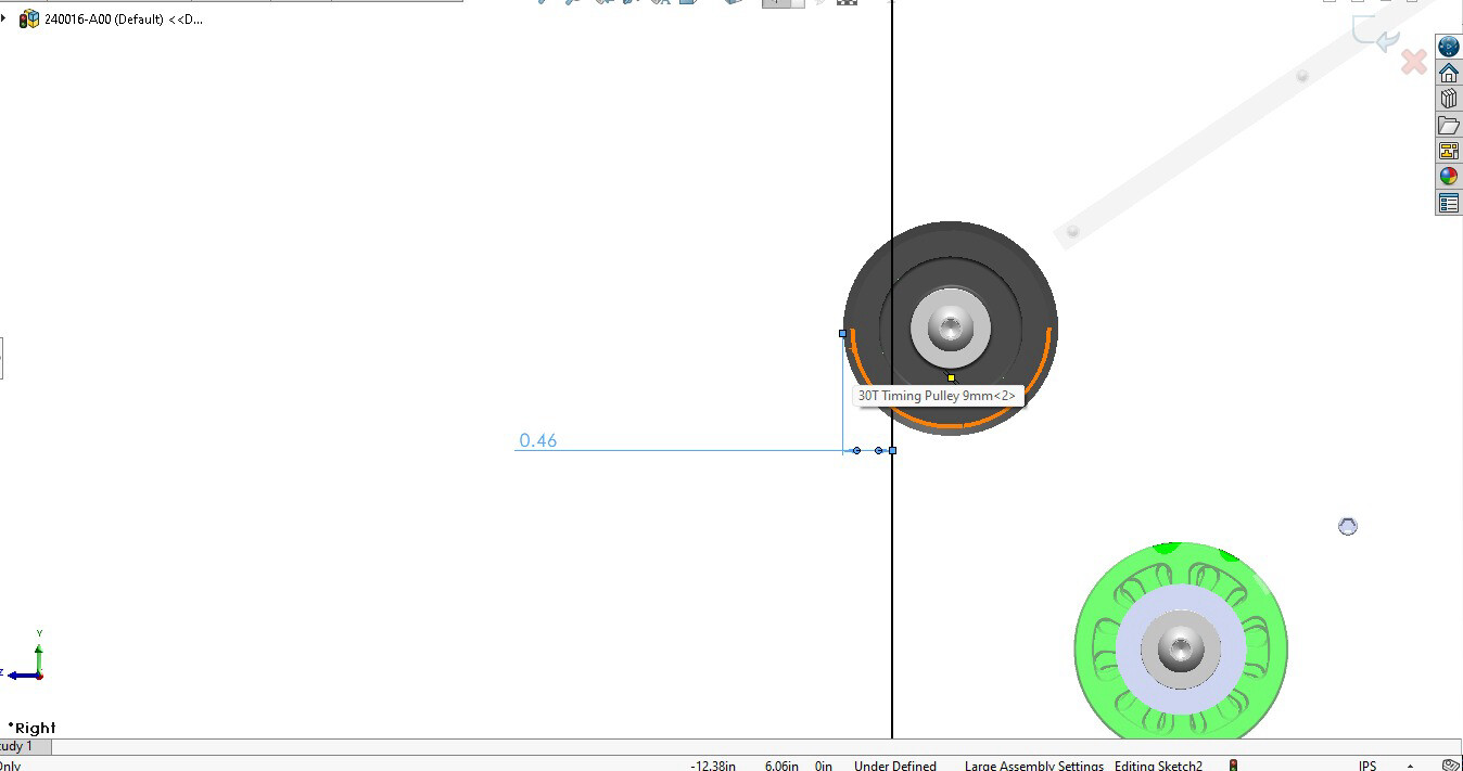

Hi, I was wondering how strict the judges are in the inspection. Our robot exceeds 0.5 inches of the frame perimeter at the longest point of the path of our intake (it is only part of the path, at no time the robot will remain in that position). I would like to know if we would pass the inspection or if we would have to make any modifications.

we exceed by this measure.

Dazzy, if I am understanding you correctly, you have a mechanism that extends past the 12” extension limit by 0.46” and you are asking if this is a violation of R105. If I am misunderstanding please let me know.
Since R105 specifies a 12” extension limit and you are aware that your mechanism will exceed this by 0.46” then you will be knowingly in violation of R105 and I would encourage you to remedy this before you get to competition. You are essentially saying “We know we are violating R105 but do you think we can get away with it?”. The R105 extension limit is a design constraint placed on teams by the GDC. Knowingly violating this rule would be exploiting for a competitive advantage.
