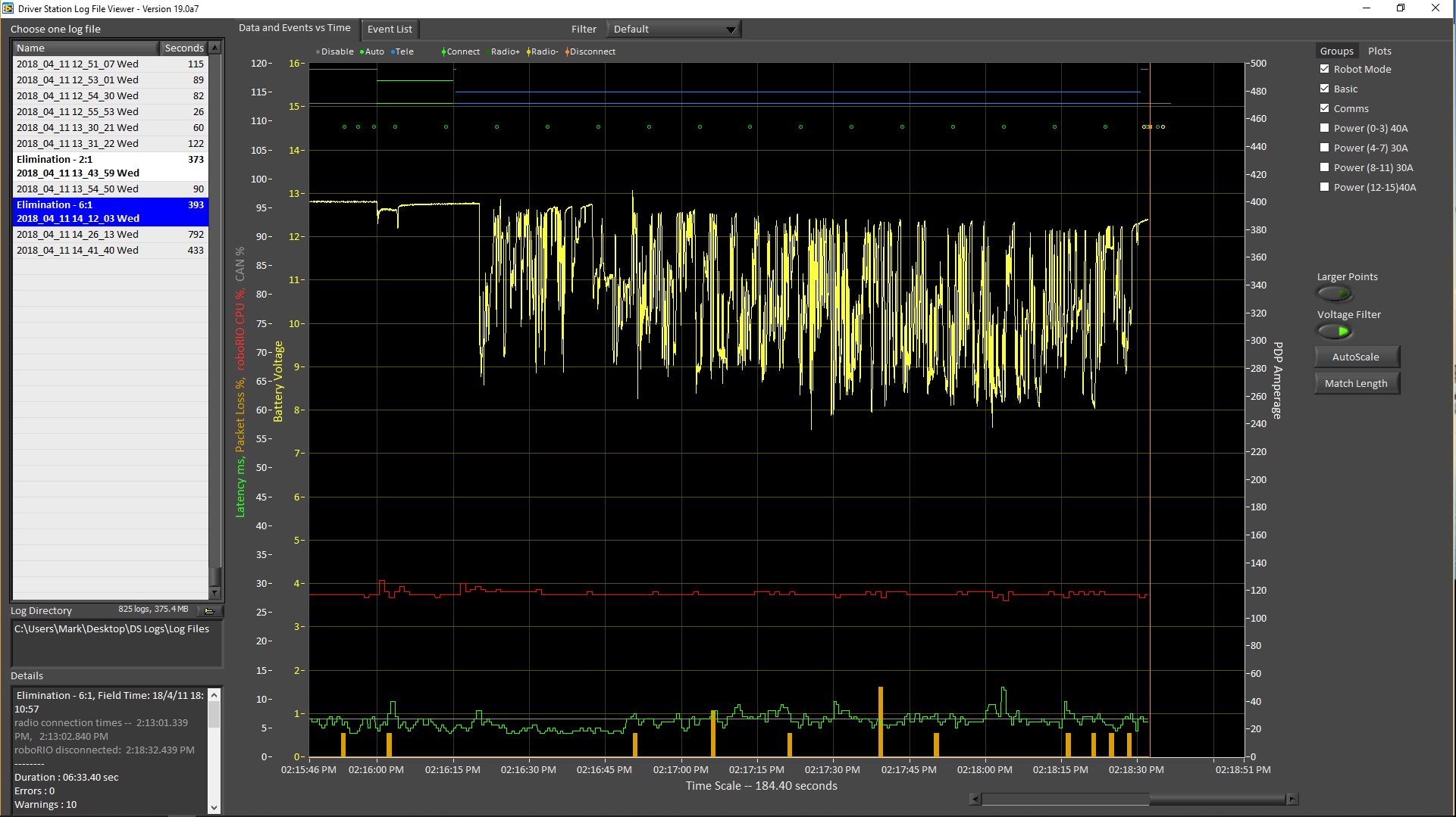

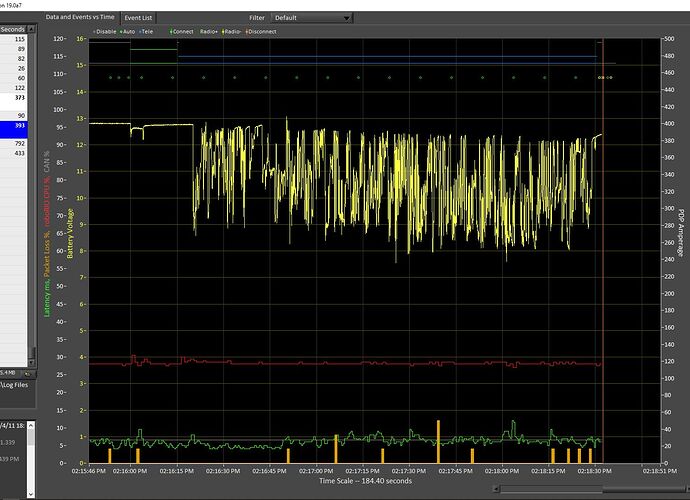

Check out the Driver Station Log to see the battery voltage graph from when it began to dip.
You can compare your recent robot performance with any time in the past to see if things have changed a lot or not.
In this example log the yellow plot is the robot battery voltage.
