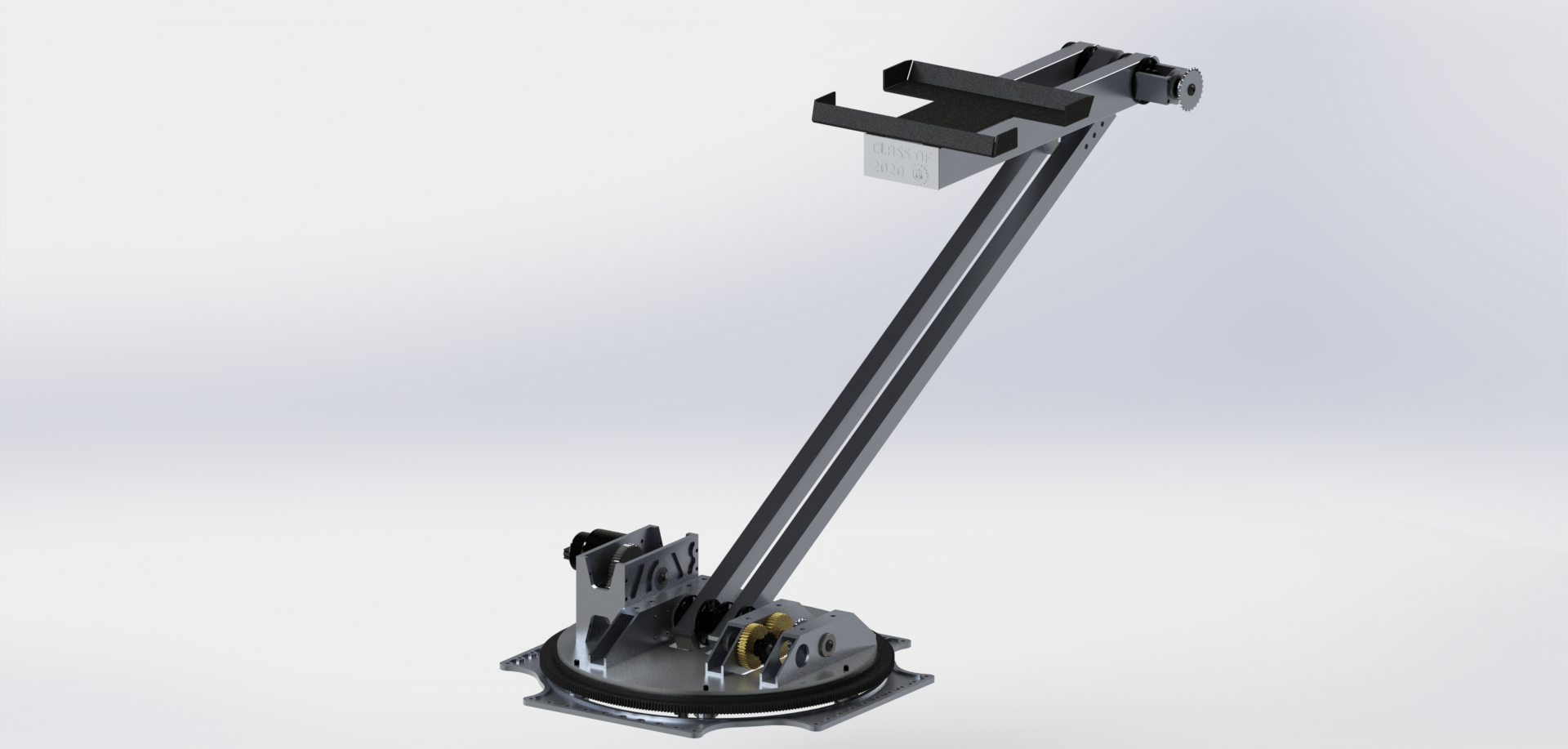

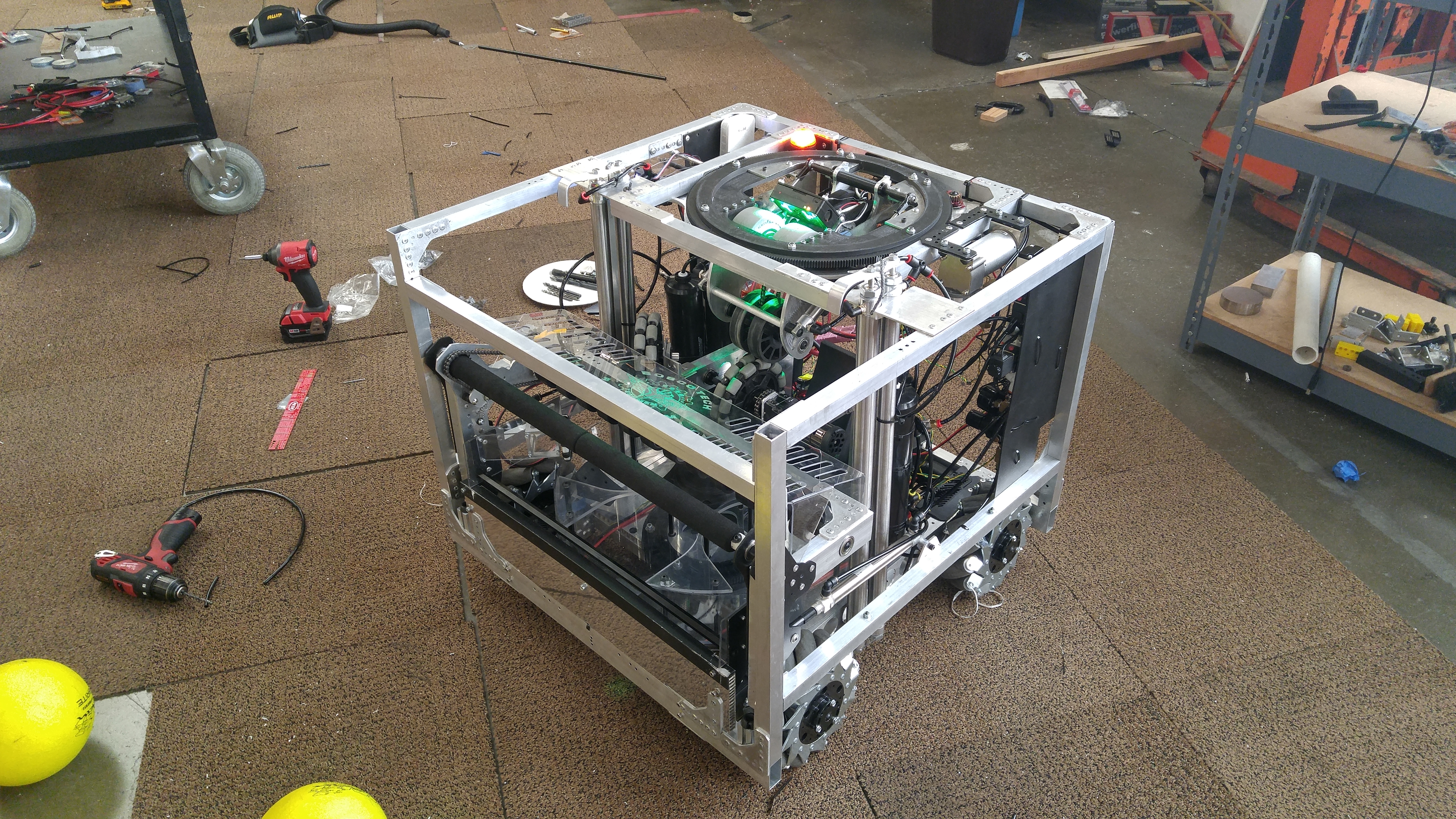

I was assigned to design the diploma manipulation system and got started right away. The first thought I had was to remove the shooting system from the turret and so I did. After that I made the most simple thing I could think of which was just a t-slot extruding out from the turret with a box at the end which would have worked but it had no style factor. I decided to go with something more complex which I started to design in SOLIDWORKS CAD. It was a robotic arm that would stay level and be driven with one Falcon 500 motor. One of my mentors wanted me to use a four bar mechanism but I didn’t think that would be complicated enough so I tried to go with something different.

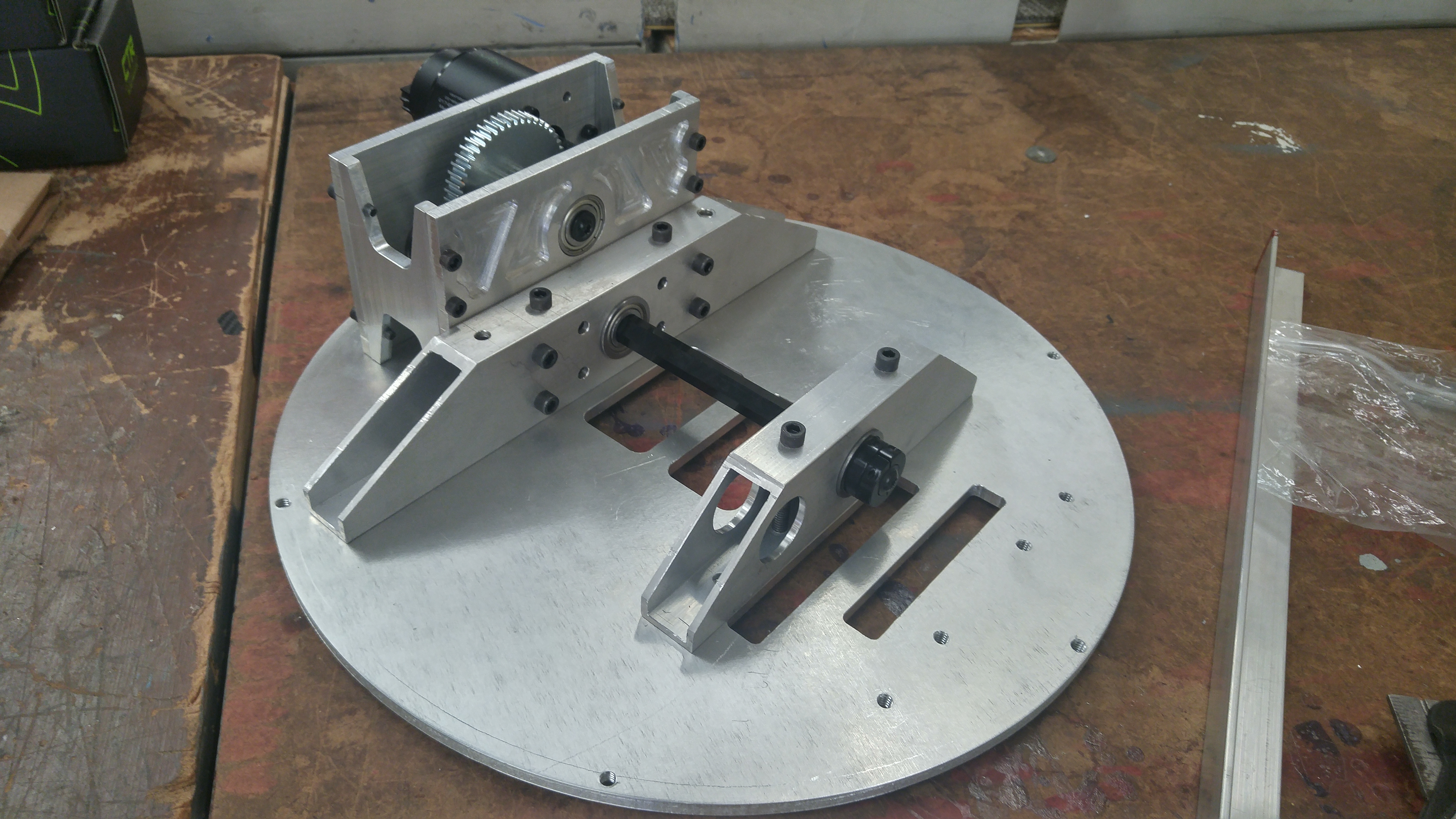

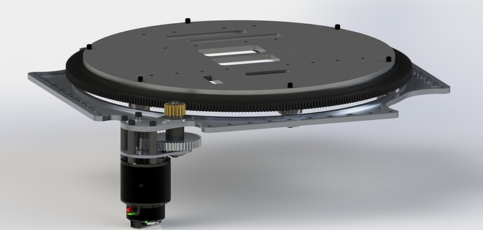

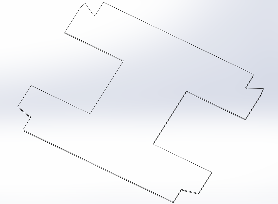

First off we have the turret and base plate. The turret gear is a two-piece 3D printed polycarbonate gear with 330 DP 20 sized teeth. It is driven by a Falcon 500 motor with a small gearbox. Since weight wasn’t an issue the left over 1/4" aluminum circular plate from the structure plate for the turret gear was used for the base of the arm.

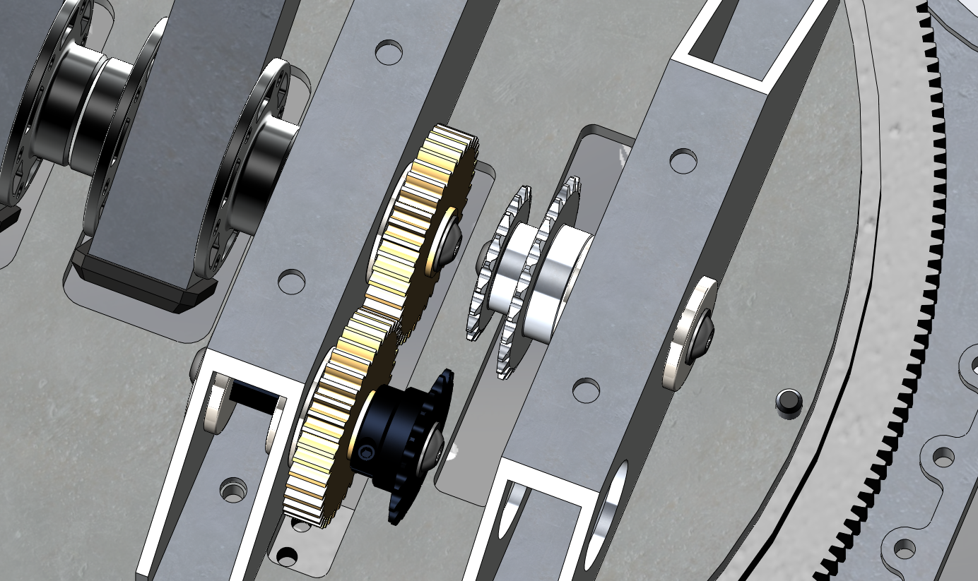

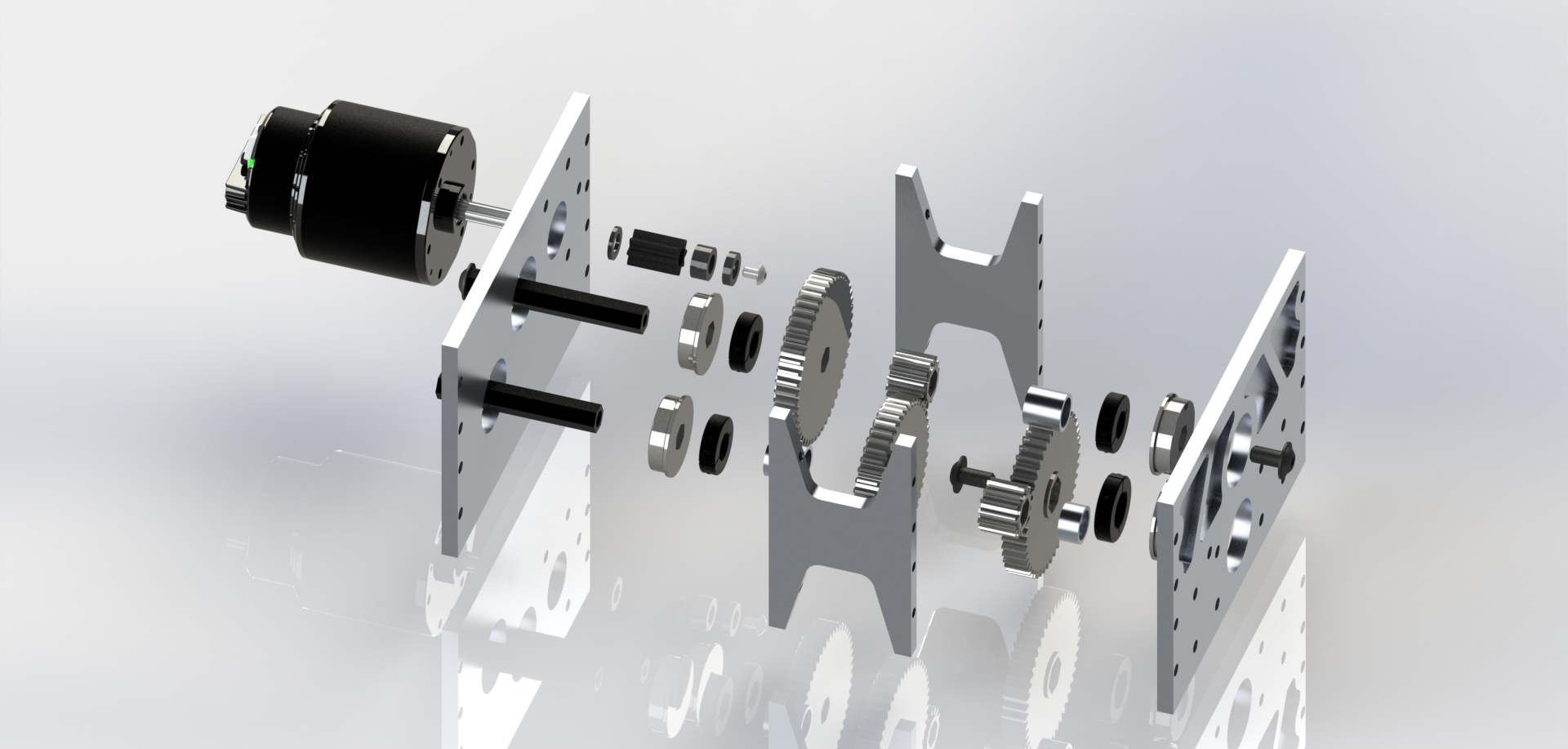

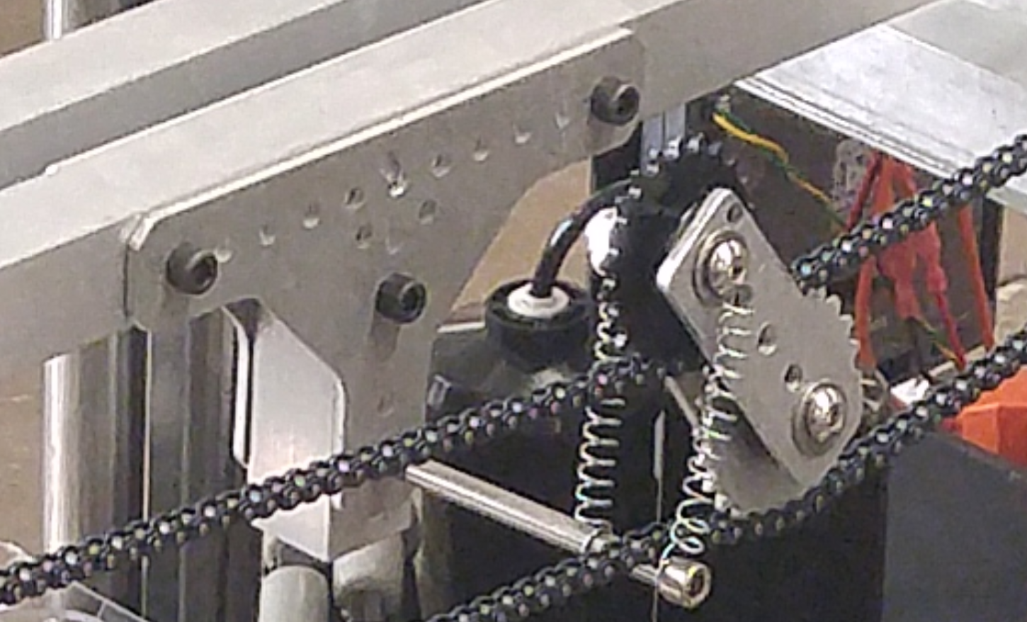

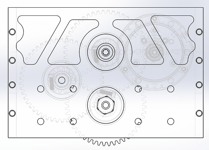

To move the arm there is a 3 stage gearbox held together with 1/4" aluminum plates which is mounted to the base plate with a series of 1/8" 2x1 aluminum tubes. The shaft on which the arm is mounted is a 1/2" Aluminum Hex Shaft and to secure the arm to this shaft, there are four Vex Hubs and two solid reinforced PLA inserts. At the end of this transmission is a system which was supposed to reverse the direction of the motor and send it through a chain to the joint in the arm to move the top part of the arm in the opposite direction. This system worked but it didn’t keep the top of the arm level as I had thought it would. I later found out that to make the chain method work, the bottom sprocket had to not move at all (rather than in the opposite direction). I made this change although it is not in the CAD and it worked great. This method is technically still a four bar but with a chain instead of a bar (more movement flexibility).
The arm itself has two stages connected with one joint. It is constructed of aluminum tubes and the joint is constructed of four more VEX Hubs and some more 1/4" plates and solid reinforced PLA inserts for support. There is also a chain tensioner that I added onto the arm without CAD.

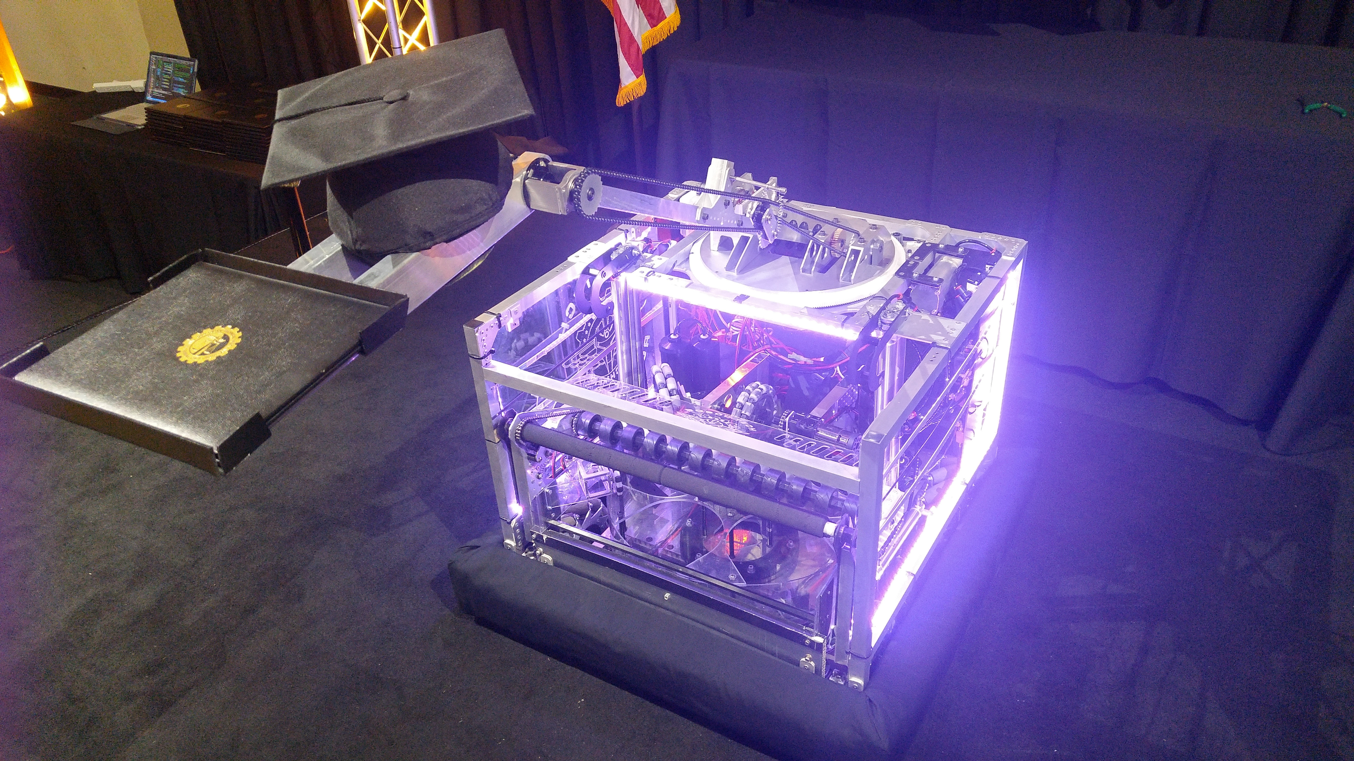

The diploma holder is constructed of a single piece of 0.1" lexan. It is bent into shape and then spray painted. It is quite easy to load/unload the diplomas and they don’t have any chance of falling out.
Added some LED lights, a graduation cap, and black bumpers for presentation.

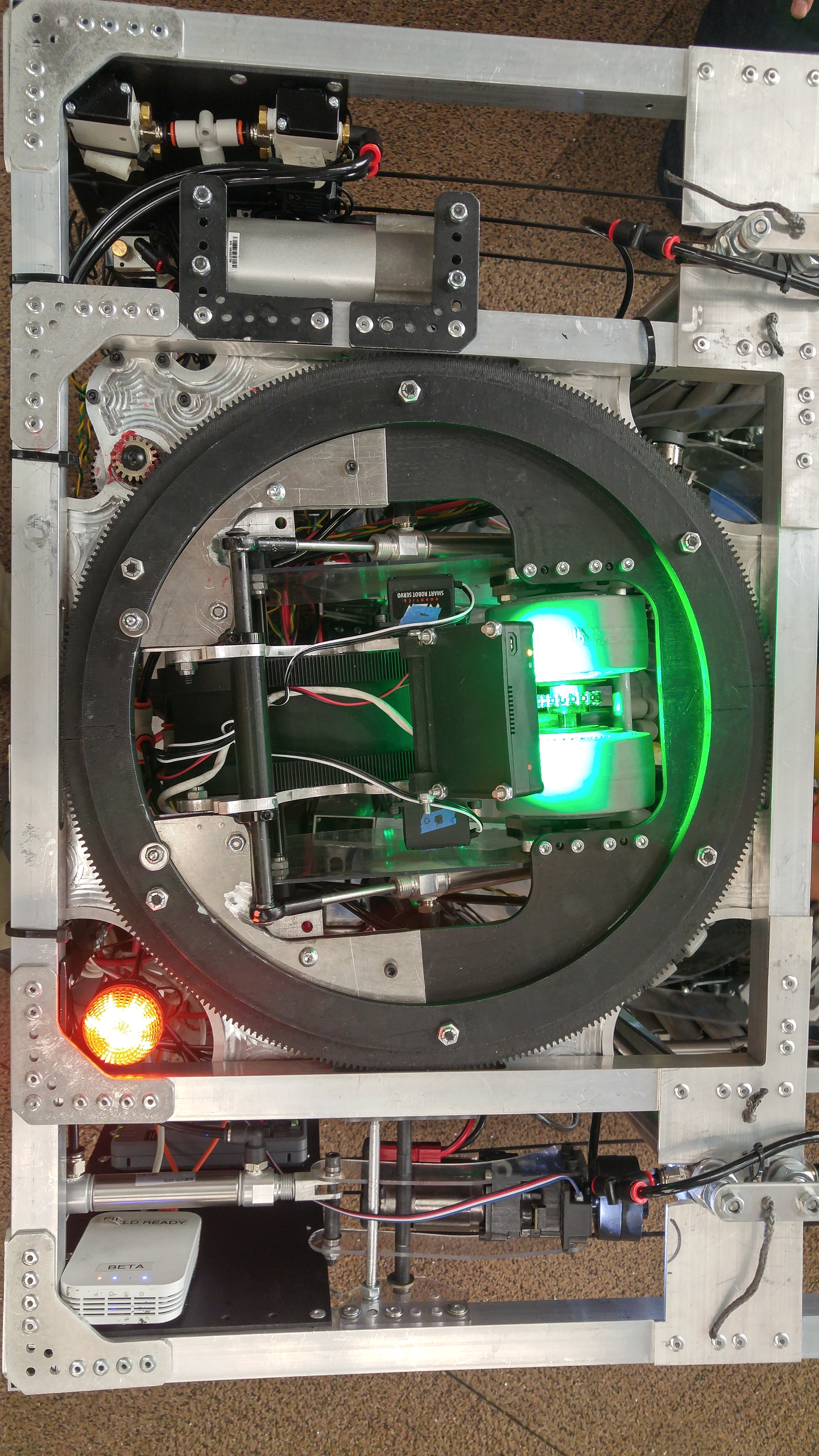

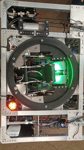

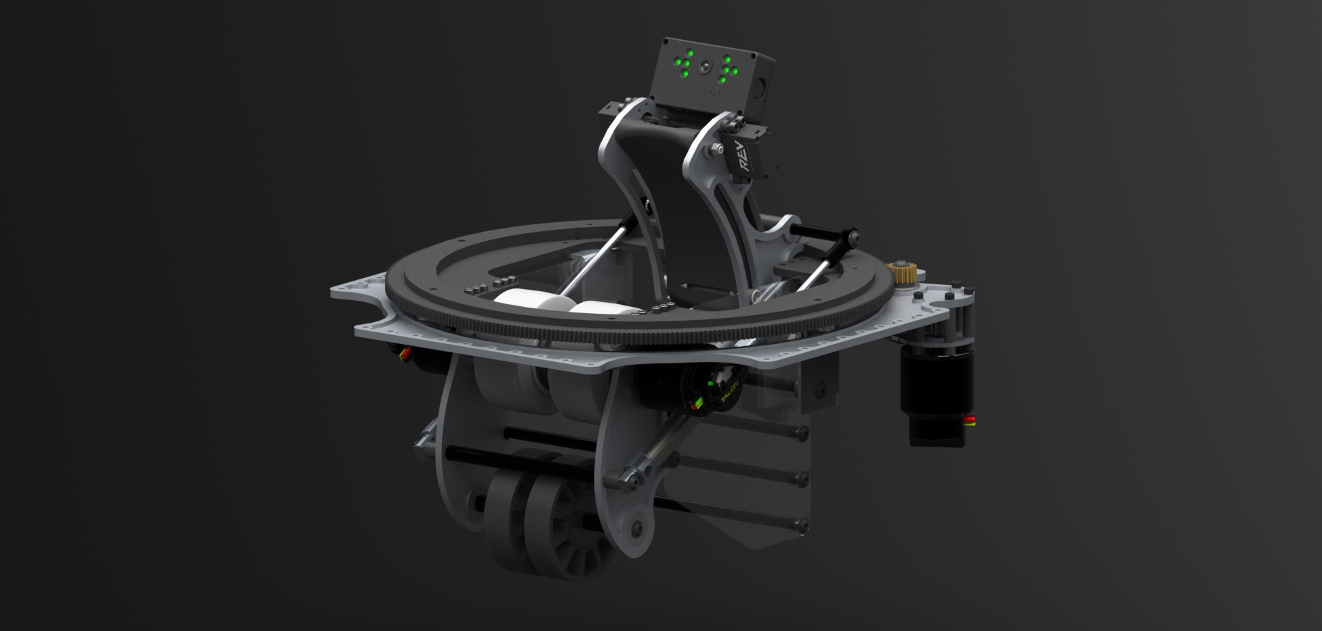

Robot Before Modification:
CAD Before Modification:
