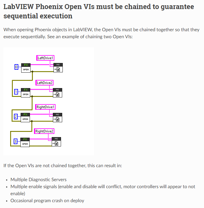

We had a similar issue early on. We are only running Falcons on the robot, all the falcons would not respond but the pneumatics would. We found redeploying code fixed this temporarily but after a few enables/disables it would come back. Which version of WPILib is your team using? I believe early on others had experienced a similar issue and it had been addressed in later releases of WPILib. I don’t recall if we had the can bus errors you are experiencing though

Our team uses labVIEW, the most current 2022 version.

Team 3142 uses LabVIEW and CTRE products (Falcon 500 and Talon FX) for our motor controllers, just like you do. Earlier this season, we experienced what appears to be the exact same situation as you. What finally fixed the issue is reading the documentation below and following the instructions therein:
This was fixed in a previous CTRE release (still post kickoff) and the latest update just came out a few days ago. Updating solved this for teams at Heartland.
updating the CTRE library fixed everything. 5411 loves you very much.
