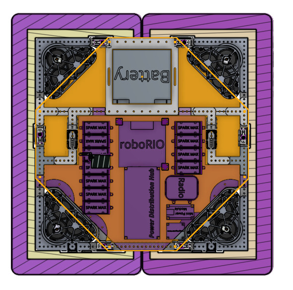

So currently, our robot weighs in at around 60 pounds. we want that number HIGHER.
our biggest priorities are lowering the center of mass for less “tippyness” as our design has approximately 40% of the weight up high, and getting as much weight as possible so were better at defense/not being effectively defended against.
Our drivetrain has a few places that are perfect for small, dense weights. but we don’t know what types of weights we should buy. below is an image of the drivetrain to get an idea of the space were working with:
the weights would go in the two rectangles on either side, and in the two triangles next to the battery. most of the weight of the robot is on the front (bottom of the image) so that’s why were thinking we’d put the weights in the back (top of the image)
our main question is this: what type of weights would be best?
we found these weights with a quick google search, but we are a little hesitant to use lead because of safety concerns.
we also considered cutting off the shelf exercise weights to fit in our space, or making a bracket for them.

Chunks of steel. Not little ones, either: STEEL. BLOCKS.
Bonus if you can find them with a hole drilled into them already, but if not go slow with a drill press.
We have sponsors that were able to donate copper tungsten blocks. It’s really dense and adds about 12 pounds to our base. I’m sure you’d be able to find similar dense material by reaching out to sponsors for any excess material they may have. Uncut belly pans also add a lot of weight, I think a 28 x 28 1/8th belly pan is close to 10 lbs so maybe increase the thickness or have multiple belly pans.

I’ve seen teams just add 1-2 inch sheets of steel to the top of their belly pan. If cost is no concern, then I might suggest large quantities of this.
Cost is a concern due to the $600 COTS limit
we just run a solid 1/4” alu bellypan + solid steel bars as ballast found on mcmaster allowing us to pretty much max out our weight

The densest elements are mostly radioactive or extremely expensive, the most affordable is tungsten. For FRC purposes, though, steel is more than enough.

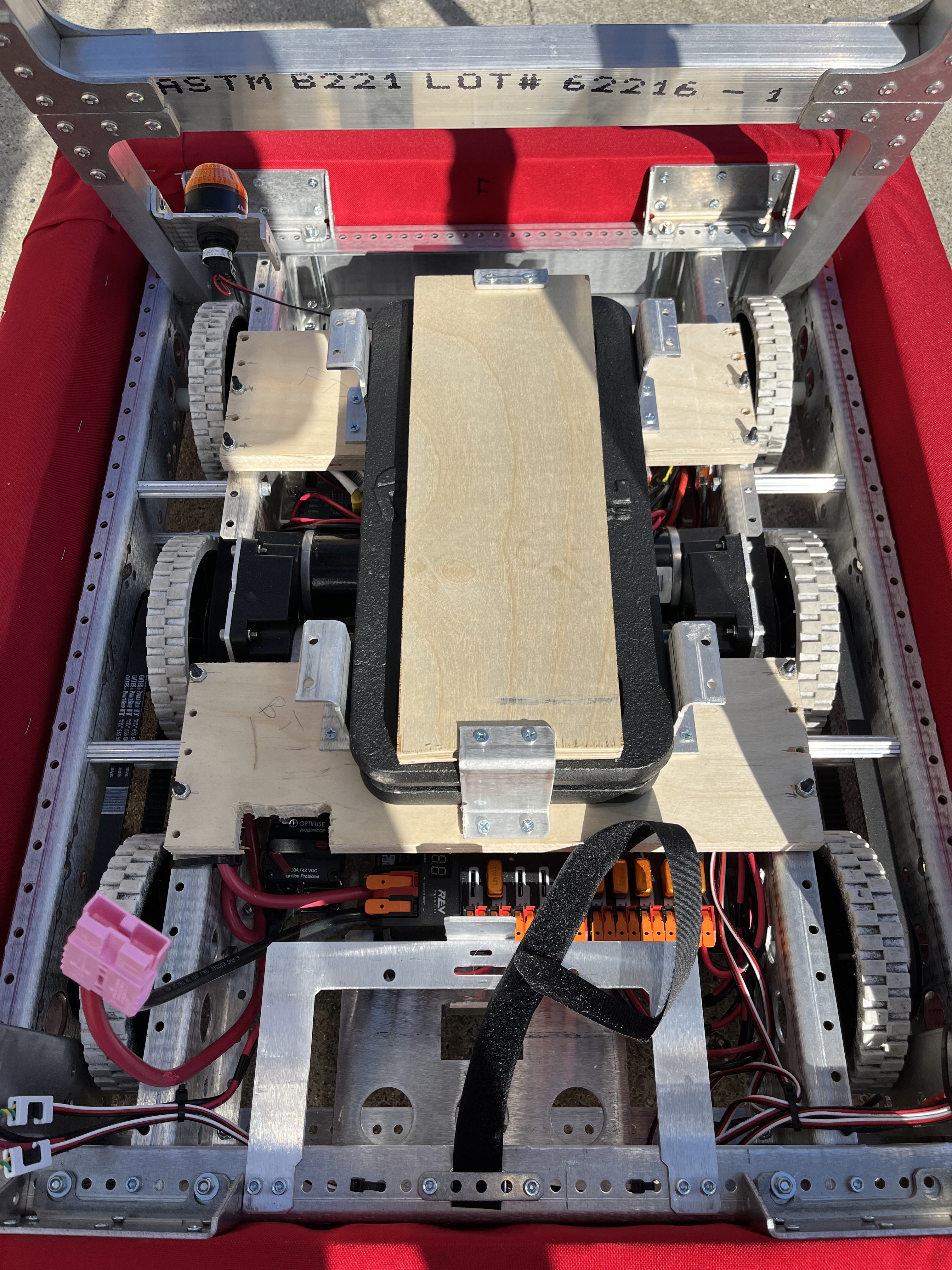

Beware of zip ties. We were told that “zip ties are not rated for dynamic loads” at inspection. We had to run out and get U-bolts to hold down the dumbbells we were using as ballast.
We built the EveryBot.
We used these 2 20 pounders from Amazon. She still a little light and slightly tippy and we will probably add more small weights. But this 40 lbs was a huge improvement. I forgot to get a photo before the wood covers.
Titan Fitness 20 LB Cast Iron Ruck Plate, Weighted Plate for Rucking https://a.co/d/7nfv5MS
