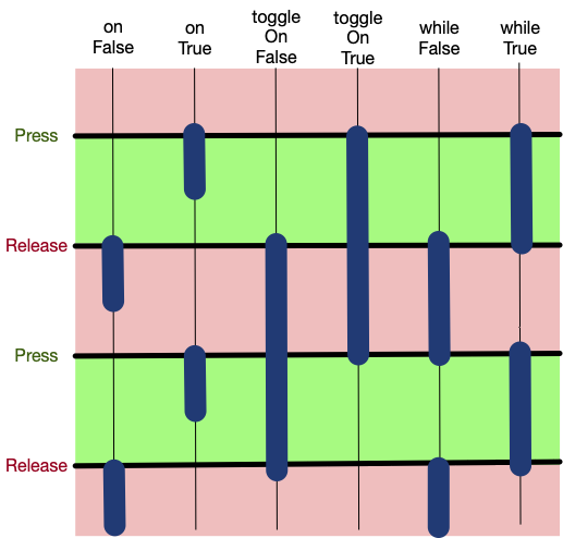

  • In RobotContainer.configureButtonBindings, it’s a little odd that all of your triggers use onFalse. This means that they activate when the button is released. It’s more common to see onTrue (for instant commands) and whileTrue. (See this article.)

This diagram might clarify what I mean by suggesting onTrue instead of onFalse.
I like this chart. Maybe you can make a PR to the docs project with it so it shows in the online documentation.
Thanks. Maybe I will. I’ve been building my own commands cheatsheet, not only for in-house training, but also so I have something to hand out as CSA.
