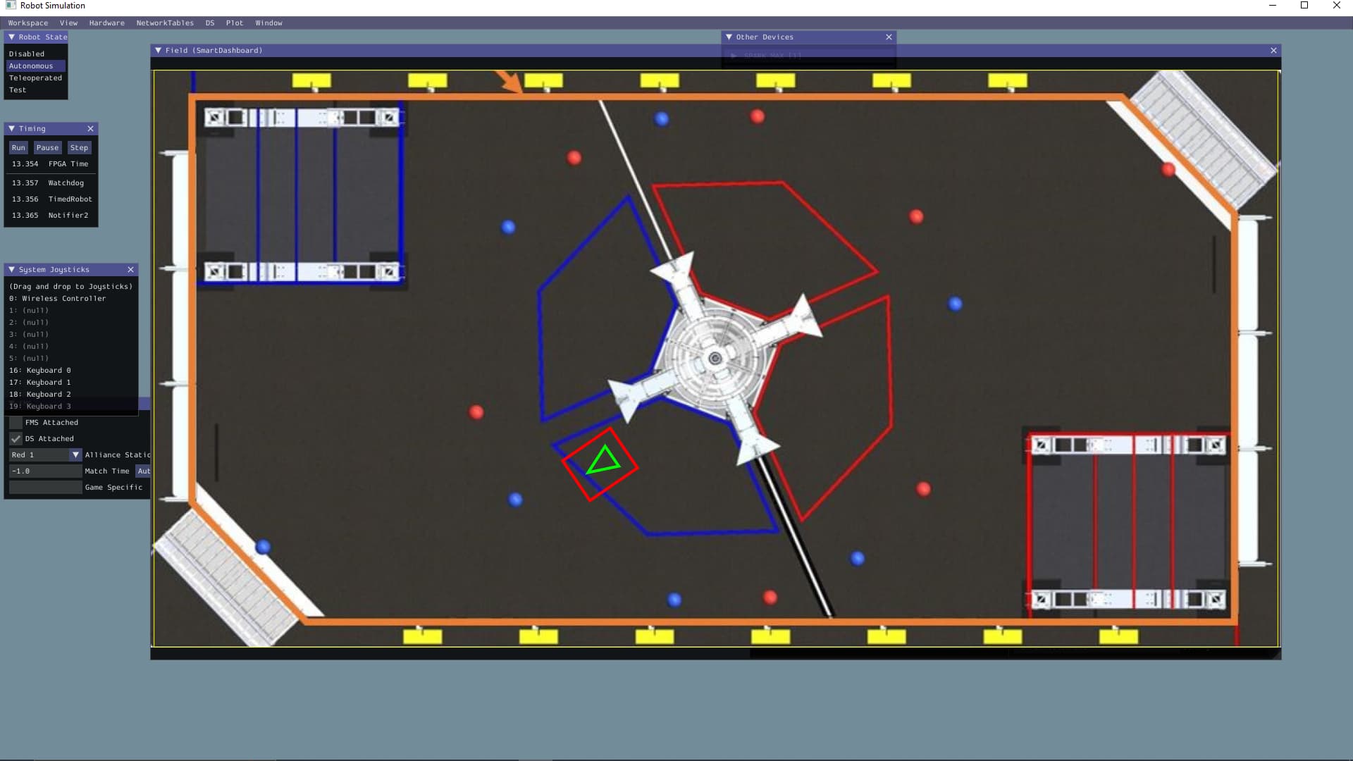

Robot not moving during pathweaver auton routine in Simulation
I haven’t found anyone with this exact problem yet so I’ll try to be as specific as I can, this is the link to my code: GitHub - Wing57/Immo
I created a set of paths using pathweaver that were then put in the output folder of my deploy thing under src/main for my project. I created a sequential command group autonomous command which just ran paths1-4 in succesion however when I press autonomous it does not do anything at all.
It will reset its position so that it starts exactly where I told it to start with the initial trajectory but afterwards it will not move. This at the very least tells me that resetOdometry() works but I have also tested all the other odometry features, encoder/gyro readings and confirmed that everything is correct.
If anybody has faced similar issues or has any ideas as to what could be causing this please share, I’ll take anything atp

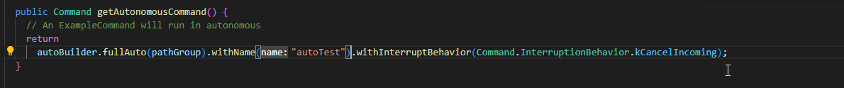

I added a “.with interrupt behavior(Command.interruptBehavior.kCancelIncoming)” to the end of the autonomous command.
Some how this works, but I think it’s hacky.

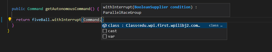

Where would I add this in my code? I dont see the option for withinterruptbehavior and all that stuff that follows
Line 50 in robot container, I think

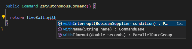

Yeah i think its there, how were you able to put Command.interruptBehavior.kCancelIncoming? I dont see any options after Command.
Sorry if these questions seem dumb
not dumb at all… you mispelled the command:
…I also led you astray a little.
Screenshot (1432)
Do you think it only works with pathplanner? Honestly I was getting ready to try and switch over anyways…
oh, hmmm this is awkward… this may be 2023 behavior. Im lost what to suggest next.
