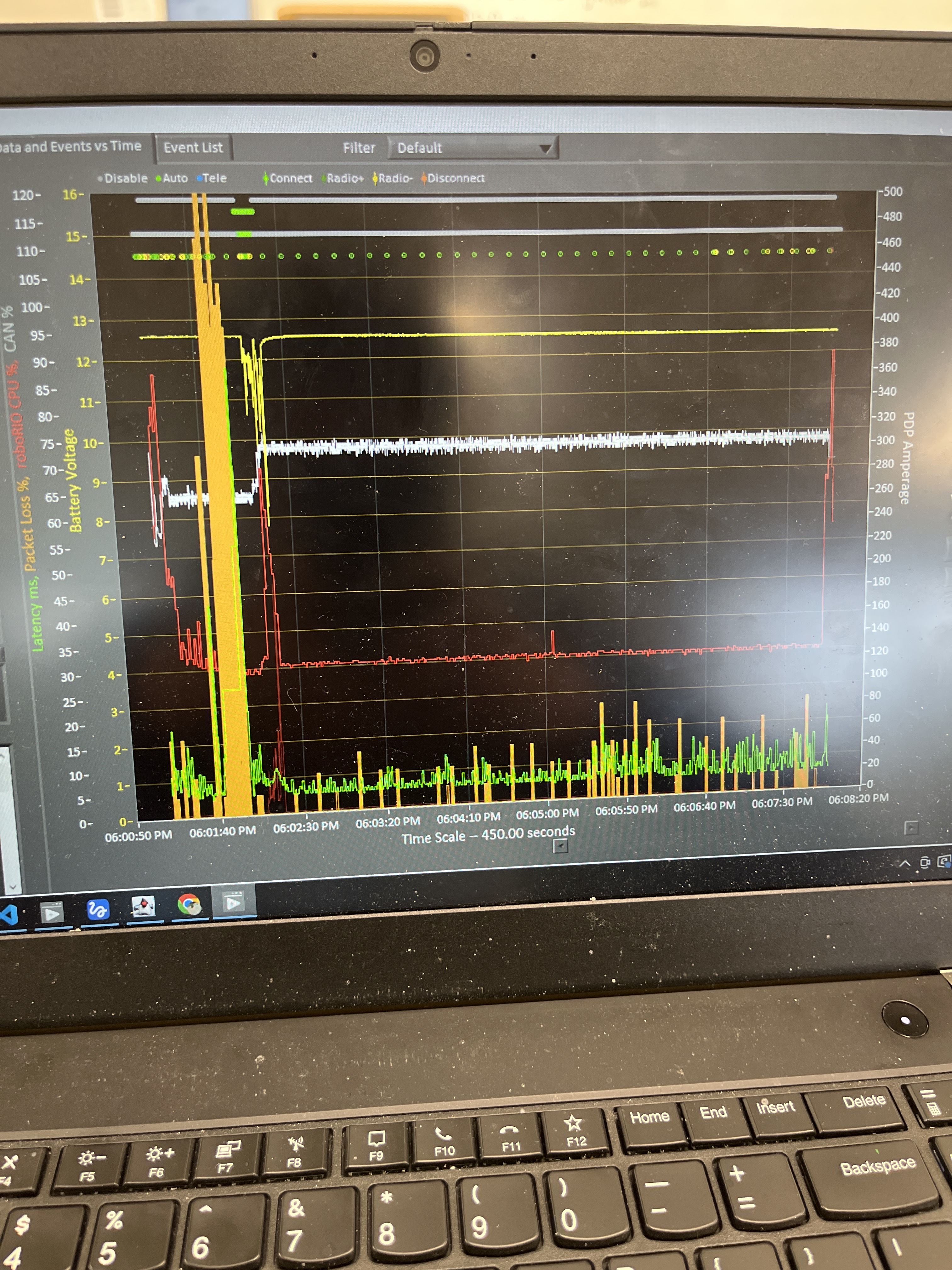

Hello!
So basically we’ve been having an issue all season where shortly after we enable teleop or auton sometimes, our robot will “spasm out” pistons will rapidly extend and retract, our compressor will turn on and off rapidly, if we’re driving at the time our drive motors will stop and go. This has never happened in a match but I am very concerned that it will.

Sounds like classic packet loss. The question is, what’s causing packet loss? Sometimes can be straight forward, other times not to much.
We’ve checked our driver station logs and there isn’t any packet loss like that, yes we’re using a good laptop and a fresh battery and it still occurs.
I’m going to go through all of yesterdays driver logs and see if there are any times with large packet loss

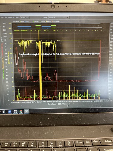

I think it’s a packet loss issue, looking at yesterdays logs this is what every few (1 every 5-10) show:
Yup, figured. Unfortunately diagnosing these issues isn’t always straight forward. So yeah if you could drop in a post about what you’ve already looked into, lets go from there. Both on the robot and on the laptop please.

With something fairly cyclic like this, my first guess goes to a background process running on the computer. Make sure all of your firewalls are disabled, any auto-updaters are turned off, nothing is running in the background, etc. Sometimes an app can decide “I need to check RIGHT NOW if I have an update” and freezes the internet traffic until it finishes checking, not ideal when you want near-realtime communication with your robot.

Yes, we are. However, the latest wpilib update regarding shuffleboard seems to have helped alot. Shuffleboard would max out GPU usage, in turn slowing the drivestation.
