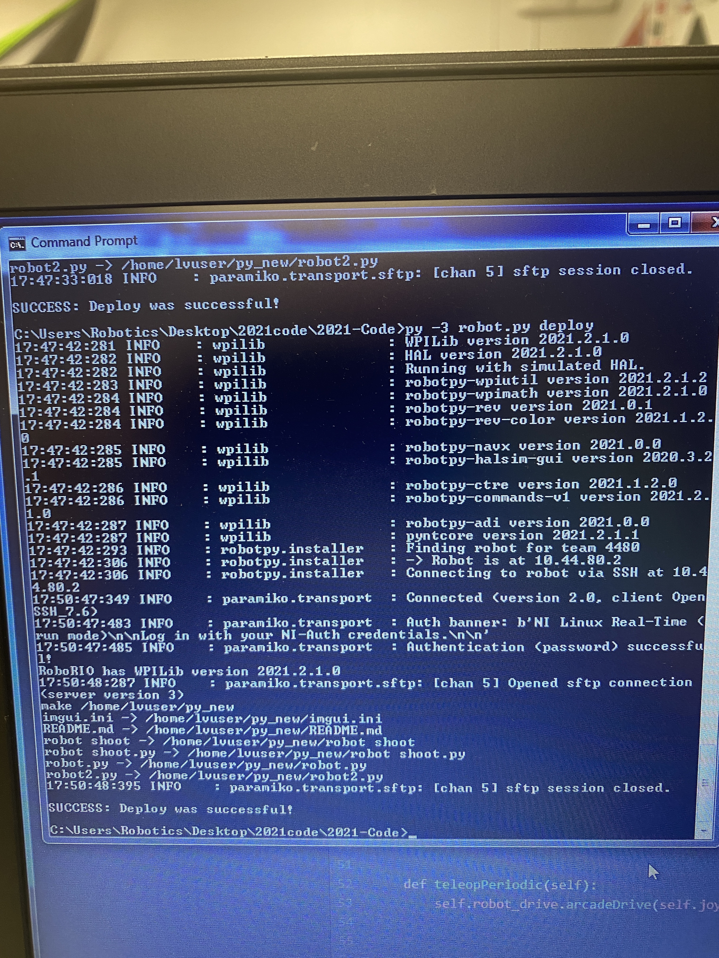

Here is our log from deploy. This is following making the GitHub repository and other codes for students who are working on things.
Is that possibly what is slowing it down?
Edit. I just removed all but the deploy, and robot.py files. Still pushing 3 minutes for deploy.
Looking at the log messages, it starts connecting at 47:42, and connects at 50:47. That’s the problem. It’s weird because it is connecting via IP address, so it shouldn’t be very slow.

Another fun fact. We were trying it today and working code. The Windows PC would take two minutes (average) before it kicked the first log item. Following it took the additional time to actually deploy.
Using the MB Pro today. Almost instant deploys. Soooooo weird right now…

Update So this might now be a RoboRio Issue. I tried deploying and setting up a second rio we are using for Autonomous Training and in using our Windows PC it worked perfect, and Deploy took only seconds. I go back to our Current Build Robot - and the Deploy is 5min still.
I really am baffled as to what might be causing it however, being the Mac Deploys are quick.
