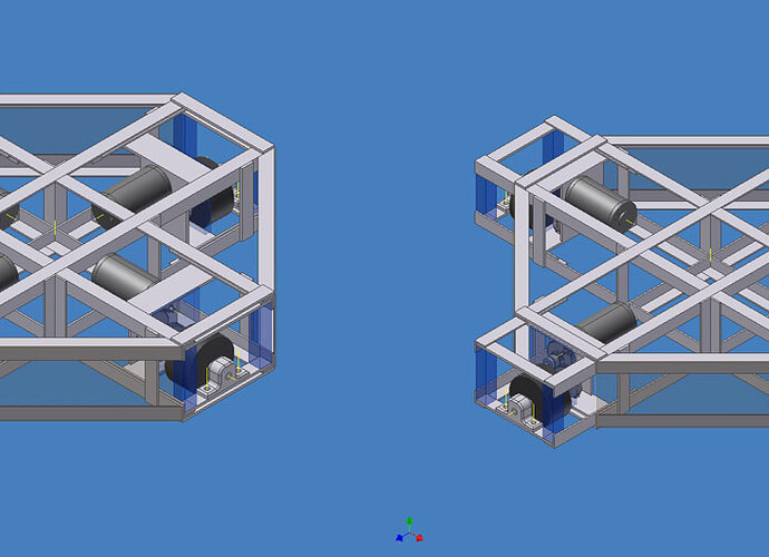

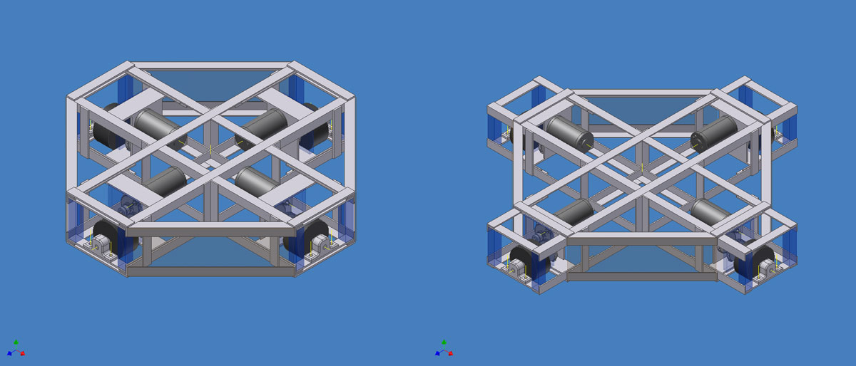

We had a single speed gearbox. 1 CIM per a wheel. We did 13 fps with holonomic and expanding drive modules.
Can we get a picture of what exactly is an “expanding drive module”? Thanks.
I’m going to have to clarify that speed. 13 fps (…calculated, more like 10-11), but that was only parrallel to the wheels. If we drove 45 degrees across our wheels (straight) we would go about 7-8fps… and then we put our arm on and got scared of going that fast.
Oh and the expanding module thing…hmmm i think i have an inventor pic somewhere.
found it… an old one though.
also, not in this pic is the driving mechanism for this expansion. you can see it here: http://www.chiefdelphi.com/forums/showthread.php?t=34669&highlight=1002
There was a piston involved also, but we don’t like to talk about it.

I saw the Circuit Runners’ robot at nats (scouted it too as it was in our division) but didn’t get any pictures. What happened was they had four omni wheels that slid out of the starting box at the robot’s corners. I think the motors and gearboxes also slid outwards. Don’t ask me how it worked, but it was pretty cool to watch.

Here is a link that shows the drive module, this picture shows it still inside the robot. One module consists of the omnie wheel and its gearbox.
http://www.circuitrunners.com/inventor/images/team_1002_omni.jpg
Here is a picture of the overall robot.
http://www.circuitrunners.com/inventor/images/team_1002_front.jpg
The piston running down the middle of the robot pushes down on that piece it is connected to which is connected to all of the drive modules which causes the modules to pop out. We could move them in and out quickly.
I hope that clarifies it a little better.
