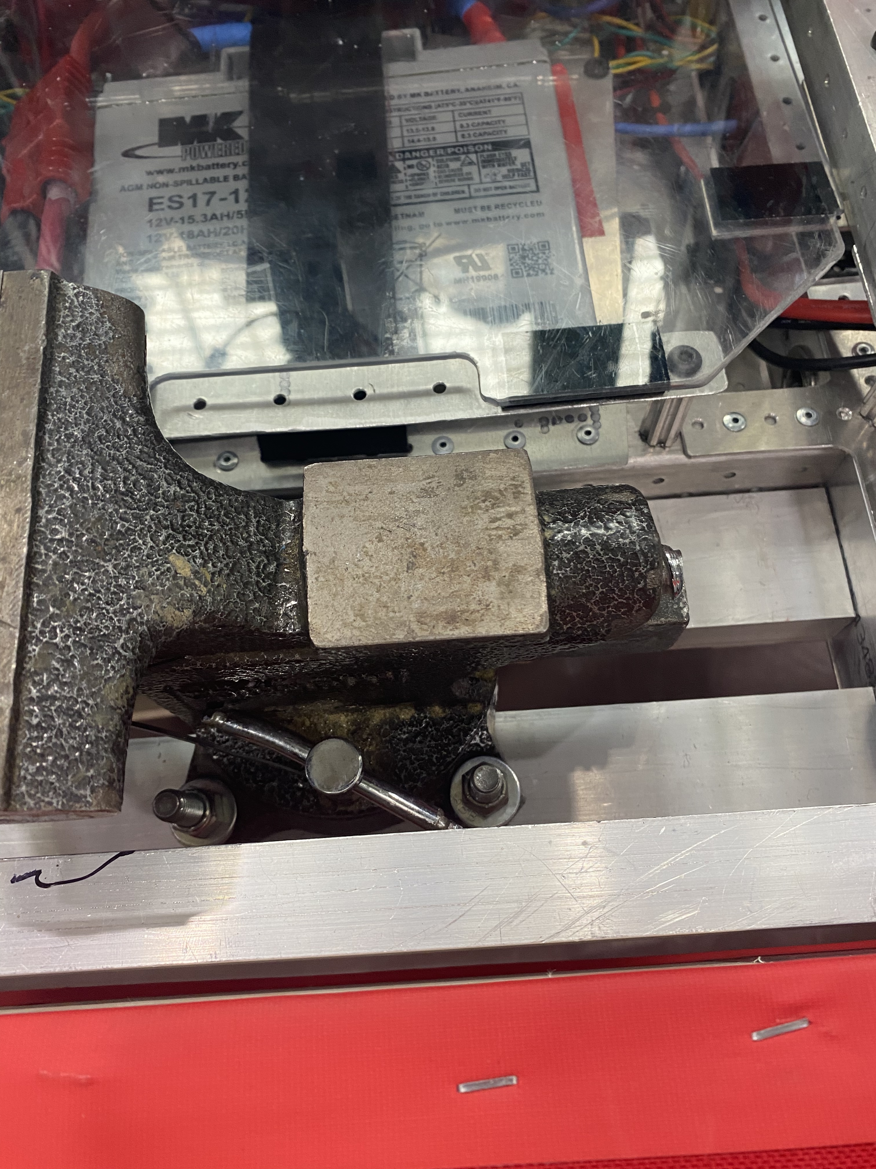

We had to add weight so we could do defense in the playoffs, we attached a vice and bolted it on, we won the competition so it worked

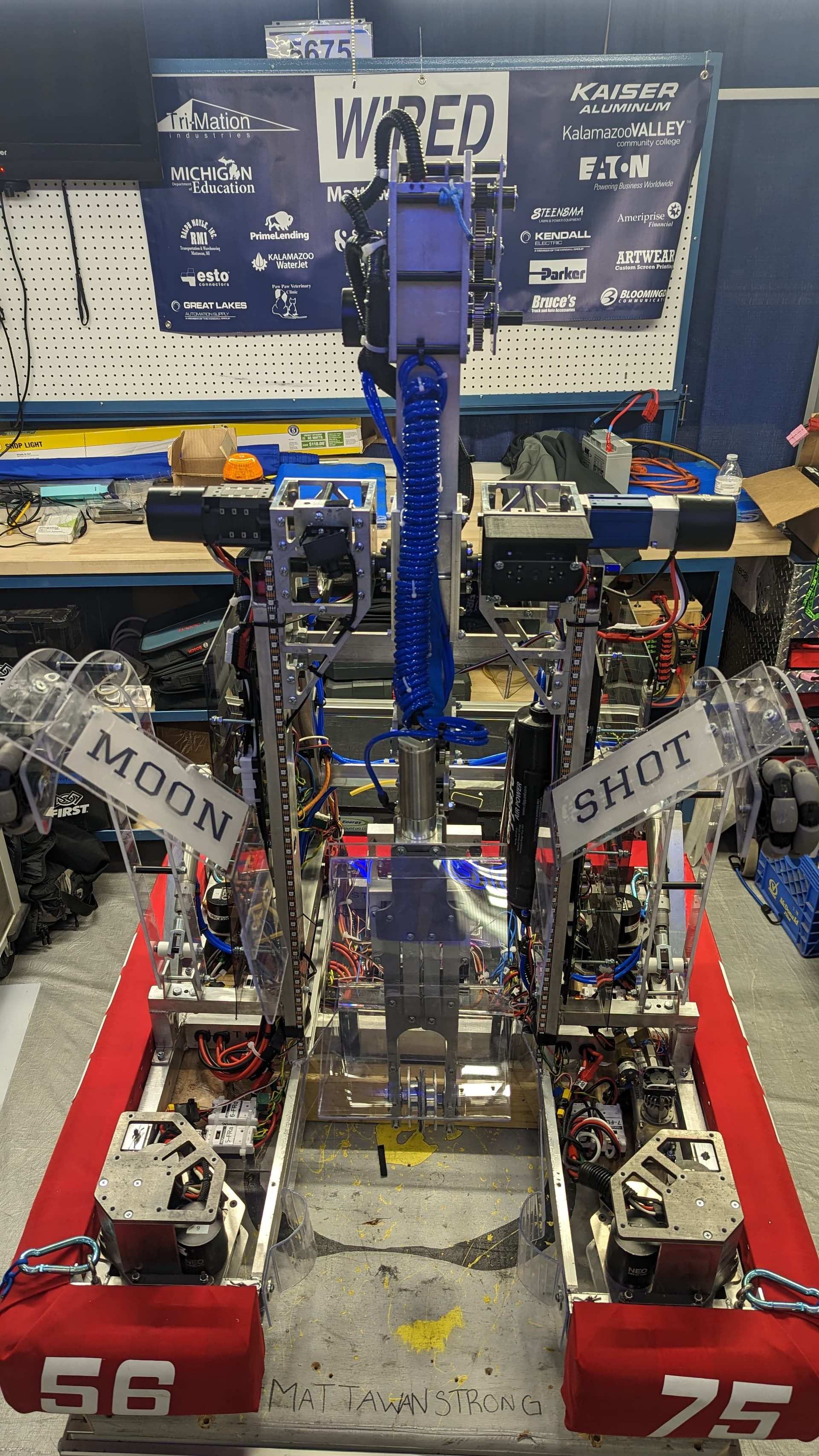

We were practicing with two 10lb dumbbells zip tied to the front our robot. We were fairly certain that this wouldn’t pass inspection, so milled two steel “swerve protectors” that each weigh in at about 8-9lbs. Worked great. Not tippy at all and driver said they even improved robot drive performance.
This is the swerve protectors referenced.

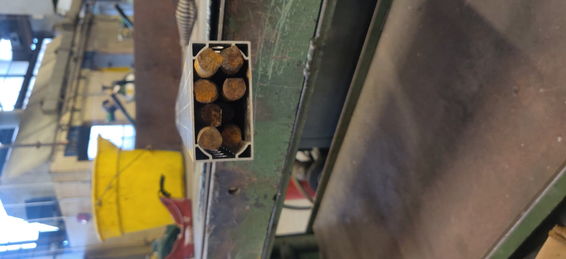

We threw rebar into our 2x1 frame rails.

  • Scrap chain in 1x2 tube, held in place permanently with epoxy
