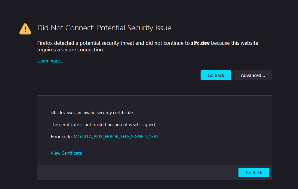

Im getting a cert error trying to visit the site:
Yikes! Thanks for letting me know, it should be fixed now.
Looks good to me now! Thanks
