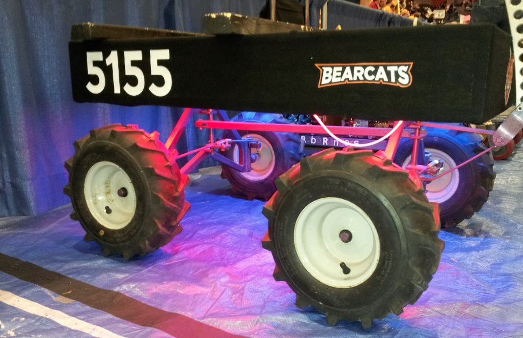

Or go for best maneuverability - 4 wheel steering:
I don’t know how many times our cart’s wheels have skittered and you have to drag it against the wheels. It sucks lol
