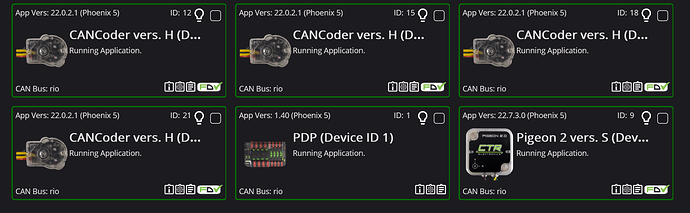

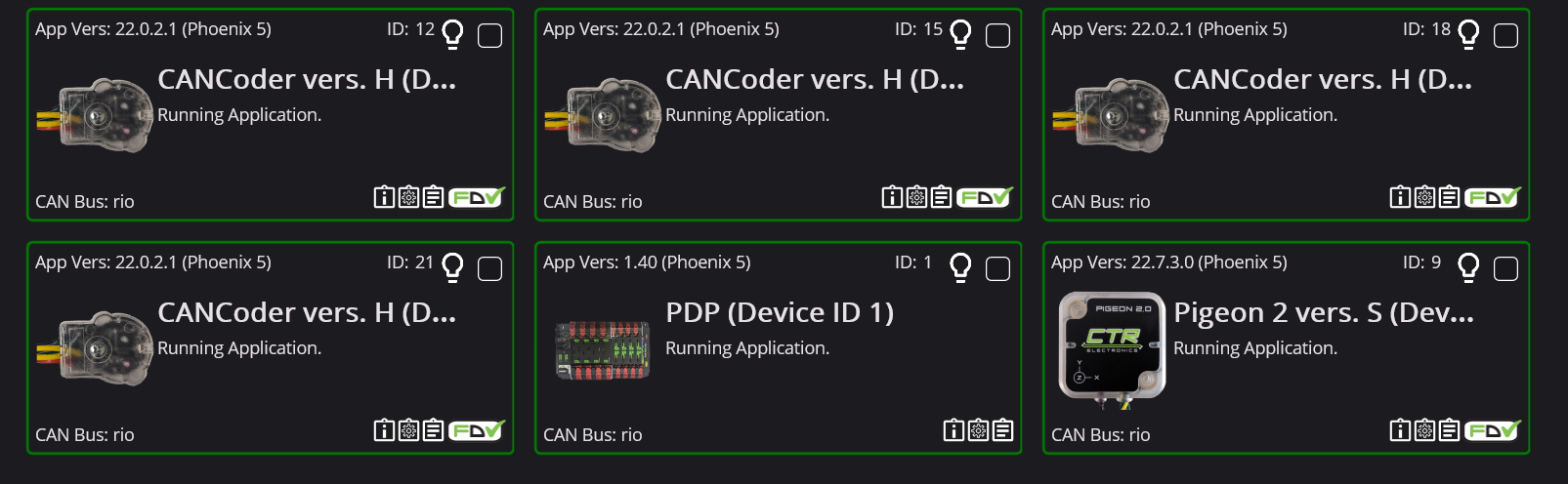

Not entirely sure where to ask this question since I’m not entirely sure what’s wrong, so sorry in advance if this is the wrong spot.
I’m trying to get a swerve robot up and running with the 2024 beta software, and I’m running into problems with all my CTRE devices running Phoenix 5. All software works in simulation, but I’m trying to get it to work on a real-world robot. For reference, I’m using NEO driven Mk4i L2 modules, and the robot was previously working in 2023 software before performing the setup steps for 2024 beta.
(1) The Pigeon2.0 on board keeps reporting that its firmware is too old (Error -8, Firmware must be newer than 22.0). I cracked open Phoenix Tuner X and made sure my firmware was up to date, it is 22.7.3.0. In addition (though I would expect this with incorrect firmware), the device does not respond to any calls with values that make sense, it just always reports 0 for both getYaw() and getFirmwareVersion().
(2) CANCoders also report 0 for any function call. They are also on the newest firmware version available. I also confirmed in Tuner X that the CANCoders do actually measure position, and that they’re doing so as I expect them to.
Any help or troubleshooting options would be appreciated. I feel like I’ve missed some key setup step somewhere along the line, but can’t figure out what.
Can you share the following
  • A screenshot of all the devices in Tuner
  • Your CTRE json located in your vendordeps folder.
