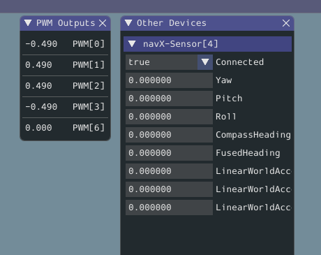

I wonder if I am doing something wrong with the Navx.
I do have version 2020.2.2 of the Navx libraries installed.
You can see the output I get below. When I change the values manually, it shows up in the driver station. However, they do not change when the robot spins in a circle. Here is our code.

if __name__ == "__main__":
    wpilib.run(MyRobot)
navx
That’s correct, there’s no automatic gyro support, you would need to set it manually.
I’ve updated the navx examples in https://github.com/robotpy/examples/pull/33, but they require pyfrc changes to work. I’ll be working on finishing these up this afternoon.
Thank you. I do not mean to push. I was just wondering if I was missing something.
