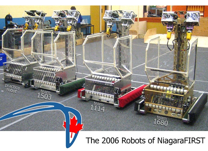

Adding another 2006 robot, or rather robots, to the discussion.
The Niagara FIRST Triplets
It wasn’t the first case of design collaboration in FIRST (254 & 60/22/968, 217 & 229) or even the first iteration of these three teams collaborating (they also shared designed in 2005, when 1503 and 1680 were rookies). But it pushed the concept of design collaboration to the forefront in ways that none of its predecessors had done, and really make it a point of discussion in the FIRST community. The fact that 1114 & 1503 teamed up to win three regionals together (in an era where winning three events in a single years was unheard of for any team with a number other than 47) really made it a point of focus. They also helped launch 1114’s stardom.
