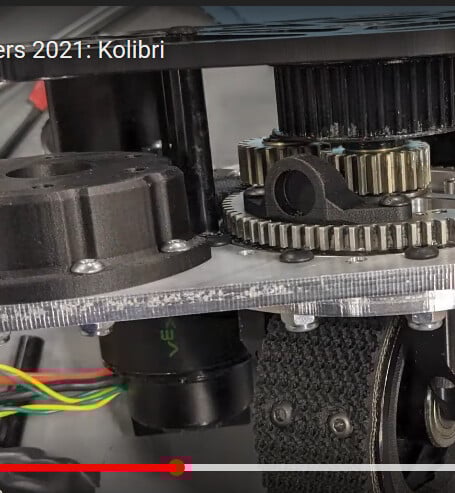

Awesome robot and very interesting swerve modules. I love how the video is a tumbleweed throwback. A couple questions:
Maybe my eyes are deceiving me, but are the drive motor pulleys a different size? If so, how are you using that to your advantage? Are they always receiving the same percent output?
How are you initializing the steering angle on the modules? I’m not seeing a steering encoder. Is it done manually on power up?
I figured hall effect based on this part that looks like a magnet holder:

I was watching the reveal video again for Kolibri, am I still am confused what the point of the 3 falcon. If you look at 0:53, when they were showing off the swerve, only the 2 side falcons of the modules we active, the center falcons weren’t doing anything. Can someone explain why they have a 3 falcon? I assume they were using it as the encoder but they could have just used a CANcoder or something.
the center falcon was moving too they just had 2 falcons for every wheel
