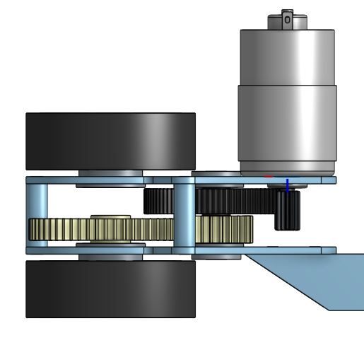

3" VexPro Compliant Wheel
3.125"
Double stack, 0.402" gap between
Backstop is 0.1875" behind the center of the wheels. YMMV however what is important is that the hatch is over center when resting against the backstop.
Hope this helps!
Edit: Here’s some CAD screenshots. Here’s a video of an early practice session. Oh and a pic I took yesterday of our ongoing redesign.

Just for another data point:
-We used the 30 durometer WCP flex wheels with plastic VEX hubs bolted through the holes
-Center distance is 2.803" simply because we had two 56T gears and that’s the pitch spacing plus a 0.003" adder. And the backstop is roughly 1.25" from the center of the wheels
-We used two stacked, with 1.75" between
in2
All of this was determined based on parts we had on hand around week 2, and doing detective work on 973’s Instagram posts.
