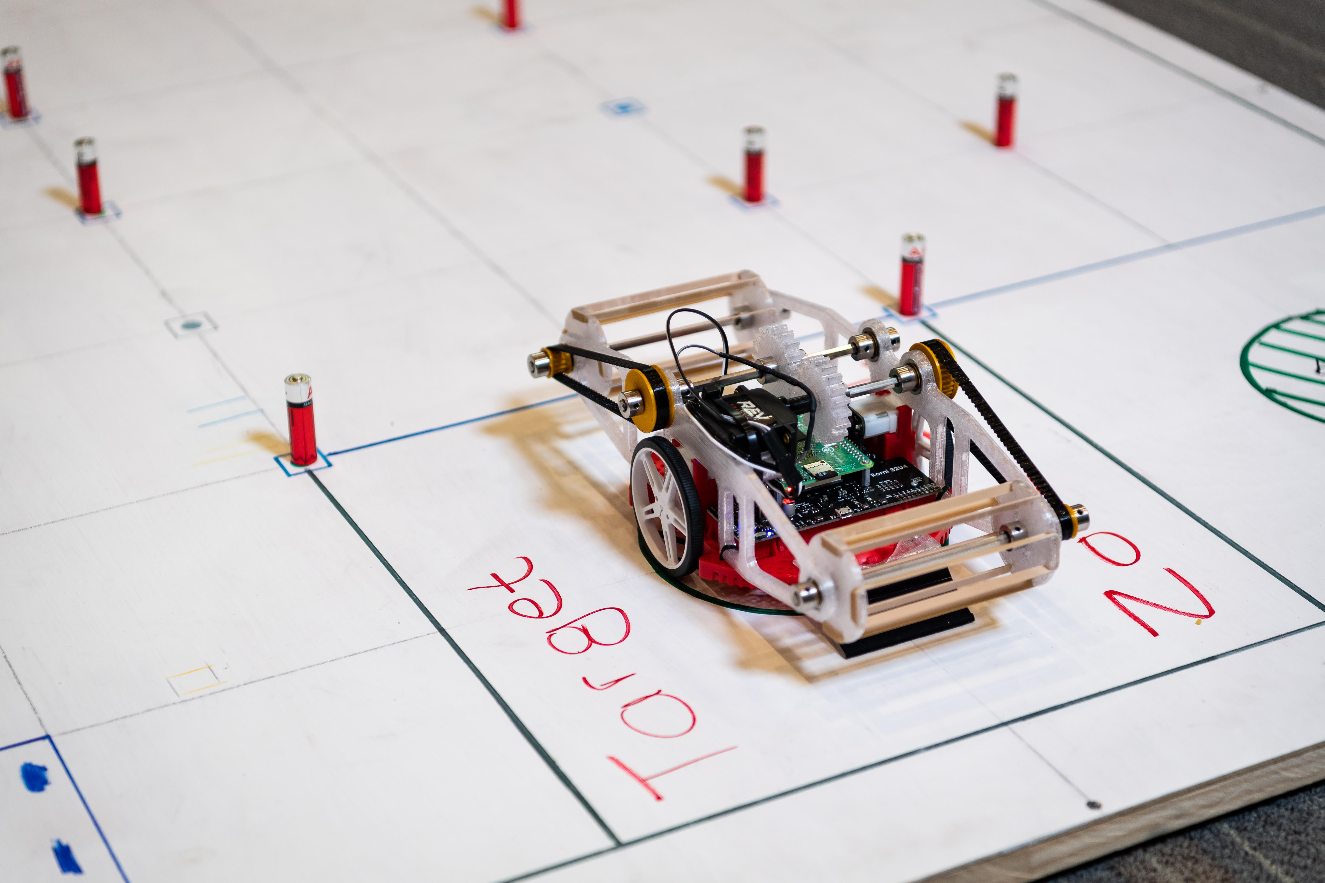

Definitely agree with @tkchan remarks above. I think it would be very hard to get anything close to a FRC mechanical platform without needing all the HW and expense associated with a FRC robot. That being said, I think there is definitely value in the Romi platform beyond just being able to program it like a FRC robot. With a 3D printer and CAD you can come up with all sorts of mechanism to fit to the Romi. Though smaller in size, all the principles of designing and prototyping a robust mechanism still apply. You can get plenty of cheep gear motors, servos, sensors and dc motor controllers off Amazon for the kids to use in their designs. You could also use FTC mechanical parts or Legos if you want, but why miss the opportunity to make everything in CAD? For the third Romi Challenge we designed our own custom gears, 3mm timing pullies, and timing belts. We printed the timing belts using rubber TPU filament. We had lots of fun prototyping and building on a small scale.

Thanks for the insights so far! I guess to clarify, we’ve found FTC-like robots good training for our mechanical and machining teams the past two years. While the mechanisms are definitely scaled down from what you’d put on a full FRC-size bot, they’re similar enough that our kids have gotten a good feel for how to design different types of climbers, intakes, and more specialized game mechanisms, and gotten good practice CADing in Onshape. We encourage them to use more FRC-type custom parts rather than FTC COTS parts (such as making the chassis from versaframe, custom bearing blocks, using hex shaft & 4" omni/hi-grip wheels, etc), so it’s good practice for the machining students too. From what you’ve shared so far, I agree that a Romi challenge could be pretty good for the mechanical team, but I think the machining would be much more challenging to incorporate.
