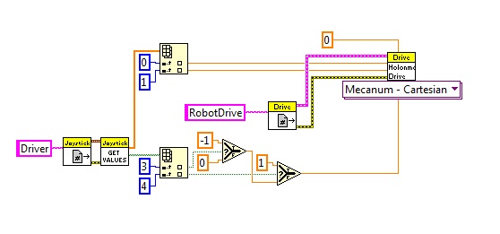

We are first time programmers, and we have decided to go with a mecanum drive this year. We have been running the default roboRIO Mecanum With Arm code, and we are driving great. However, our driver hates using the z axis (the little dial) for rotating. How would we change it to buttons 4 and 5 on a Logitech Attack 3? It’s the default code, but we can post a picture if you guys think it will help. Thanks!
Here is an example of how you can do this, but you will probably need to play with the values and array indices (I don’t have the joystick or your robot sitting here).
The first part is just opening the refnum to the joystick, and assign the X/Y axis to the Holonomic Drive block as usual, but in order to get the Rotation, we simply put it through two Select blocks to get which direction it should turn. Keep in mind that button 4 overrides button 3, but you probably aren’t pushing both buttons at the same time with the same finger.
what VI do we put this into?
You can put this inside of Teleop, sorry.
