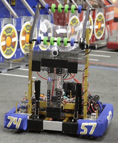

Keep it simple. Once you decide how simple you want to make it, consider making it simpler. Our Cargo mechanism from our rookie season might be the mechanism I am most proud of because it was so simple. Fixed top rollers and powered bottom rollers with a curved pieces of polycarb behind it. It never failed, and probably scored more cargo than anyone else in the district that year.
