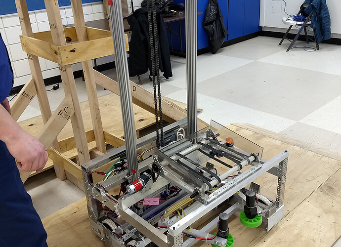

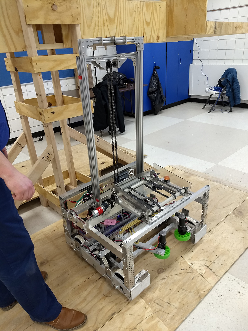

Well, our experience with unbag time has been bittersweet. At our build session last night and our 2nd piece of unbagging time getting ready to compete this week we bent the living ^%$# our of our extrusion at the top of our climbing mechanism. I have the aid of an awesome mentor from Team 67 Team Hot (Mike) which is helping me fix this issue but being a prior military member I want to have a plan B in case we have the same outcome.
If you see the pictures of our robot thus far on our profile you will see that the climbing mechanism, using a REVRobotics single stage extrusion COTS device, is rather tall and makes us very back heavy. Are there any ideas any of you have for a climbing mechanism which I could reuse the Redline 775 motor and 64:1 gearbox I have attached?
I have been trying to brainstorm overnight, although to be honest, I had nightmares of the events of yesterday, to be able to devise another climbing mechanism and looked some of the climbers from StrongHold but knowing my fellow mentors have had MUCH more experince then myself I thought I would ask this question. Any help is greatly appreciated!

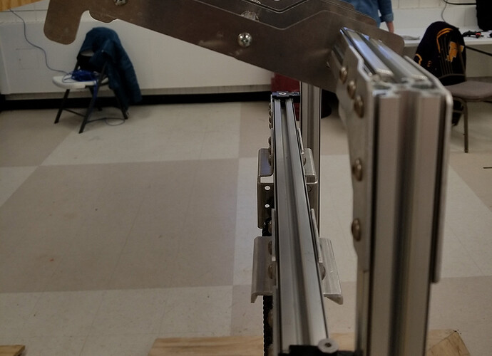

That second pic you found was our first attempt a couple of weeks ago at a rung grabbing solution which bent badly. The pictures I just posted are one of the current stage of the robot and the damage from the second test last night.
It will be difficult to keep that top extrusion from twisting from the torque exerted by the weight of the robot. At the very least you should replace the corner gussets and perhaps use a stiffer/thicker material for them.
I would attempt to make a similar hook to what you have, but make it where it will rotate clockwise (based on uploaded pic) and allow the rung and hook to be aligned with your elevator so there is no moment applied to the extrusion. This could be done with a hinge or something similar.

Extrusion has very poor torsional strength.

Your biggest issue is the twisting of the corner brackets.
If the elevator is ONLY for climbing, I’d put the hooks on the top of the cross bar. That will put the load directly under the elevator instead of in front of it.
Are those bolts on the corners going all the way through the extrusion, or are they connected with slot-nuts? All the way through would be much stronger.
I’d also recommend that the horizontal crossbar be bolted on top of the uprights instead of between. Though that’s more of a gut reaction inspired recommendation.
You may need to chop a few inches off the uprights to make the starting configuration height limit, but that’s not too much work.
Looks like you just need some new connecting brackets, preferably some beefy ones too from the looks of it, assuming the damage is limited to what I can see in those pictures. I would also STRONGLY recommend drilling the mounting holes for the brackets all the way through the extrusion and using longer bolts with washers and lock nuts to secure them.

What I see is that your hooks are too long, giving way to much leverage against the extrusion.
Shortening those hooks to right next to the extrusion (instead of … it looks like 10") will alleviate most of the torsional forces.

Replacing the top extrusion with a 1 x 1 x 1/8” wall tube will significantly improve your torsional stiffness.
For Sections In torsion:
Theta = (TL)/(GJeff)
T = applied torque
L = Length of the section
G = Shear Modulus (material property for 5052 Al this is ~26GPa)
Jeff = Effective Area Moment of Inertia or Torsion Constant for the section (I’m fuzzy on the terminology here)
Open sections do almost nothing for torsion, so we can effectively ignore the outside part of the extrusion and treat is as a 0.35” diameter solid aluminum tube (probably not completely accurate but will likely be better than the actual extrusion). For a solid section J = 1/2 pi *R^4.
Thin wall closed sections are represented by J = (4 t (Aenc)^2)/S where S is the circumference of the enclosed Area.
Running the numbers (I’d normally never use inches)
J_ext = pi/2 * 0.175^4 = 0.001473 in^4
J_tube = 4*(0.125)/(4)*(1x1)^2 = 0.125 in^4
That means the tube is ~ 84 times stiffer in torsion than the extrusion (please correct me if my math is way off - bottom line is it’s way stiffer)
Unfortunately this means all that load is going to go into the brackets… I think we can work through this though. As an alternate I think the detachable hook mentioned above is the easiest to implement given what you have in place, but I don’t think it’ll be necessary.
It doesn’t seem like the extrusion is what bent, it seems like the corner brackets bent more than the extrusion twisted.
