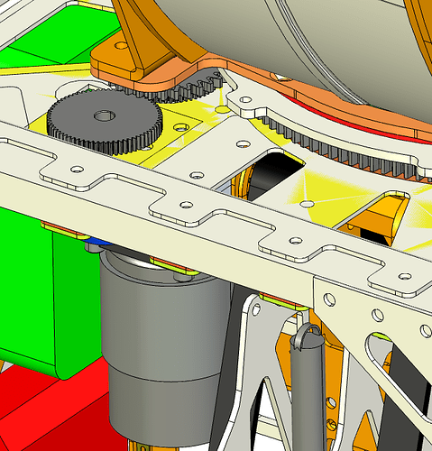

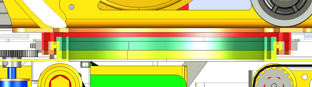

Here is a cross section through the turret bearing:
And here’s a view of the motor that drives the turret. It’s a 775pro through a versaplanetary that drives a gear at the base of the rotating part of the turret.
