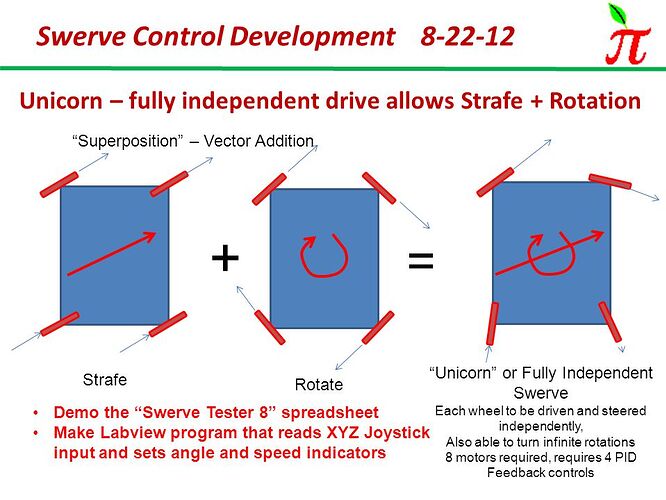

We are trying to rotate while strafing using our swerve chassis. At the moment, we are capable of strafing, rotating in place, and rotating around a pivot point; however, we would like to be able to strafe while rotating around the center of the robot. A good example of this is Team 2910’s Swerve Drive in 2017: https://www.youtube.com/watch?v=FLnUZBHBczM
Our current robot’s configuration allows us to set the wheel’s angle and speed. Using this config, is there anyway we could accomplish our goal?

Find the vectors for each wheel as if you just wanted to strafe and find the vectors for each wheel if you just wanted to rotate and just add each of them together. Then you will need to do some scaling so your motor efforts don’t exceed 1. This slide (from Apple Pi I think) sums it up nicely.
You need to represent this as a vector equation - essentially, you have some target [dx, dy, \omega], and four vectors (representing angle and speed of each of the four wheels). Set up the equation to model robot dx,dy,\omega given the speed and angle of each of the wheels, and then invert it and solve for the wheel speeds and angles necessary to achieve your target dx,dy,\omega.
