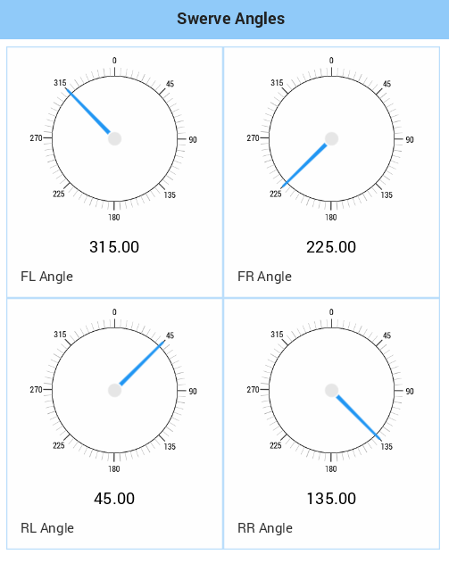

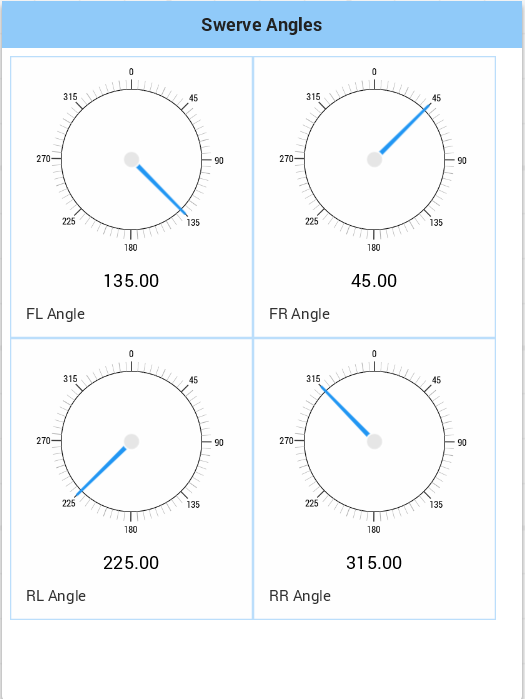

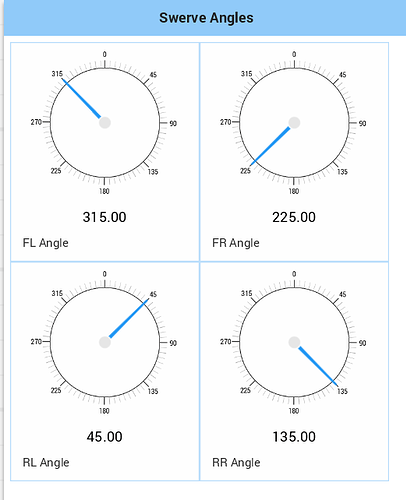

Our team has been trying to get swerve working this year and we’ve run into a slight issue. That being that, when simulating the swerve module states with an Xbox controller, rotational inputs make the modules turn like so: (All speeds in all screenshots are positive and all angles are unoptimized.)
Translating works exactly as expected. For example, moving forward and to the left yields this:
However, while not touching the translation input and only moving the rotational input fully to the left, I get this:
Each angle is opposite of itself if I push the rotational input to the right.

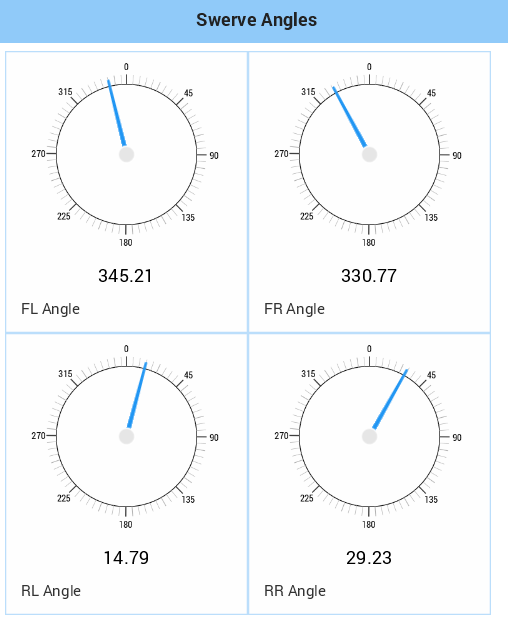

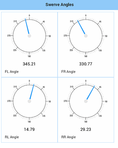

Translating and rotating looks like this: (Forward and rotating left)
The Code

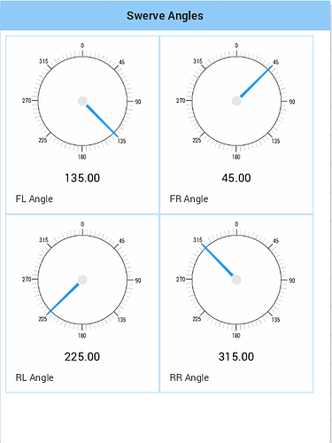

The pictures look as if you have left and right swapped somewhere. In particular, when everything is working correctly, when only rotating, you want to see a “diamond” shape for the wheel orientation, and if you swap your left and right pictures, you get that. I believe that your picture of translating while rotating is consistent with that, although that’s a little harder to visualize.

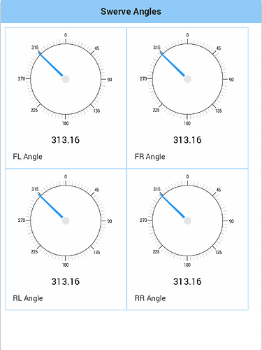

I don’t understand this: If I change the code to get field relative chassis speeds with a constant heading of 45 degrees, translation again works as expected, being 45 degrees to the left of 0. However, this change doesn’t affect the rotation as rotating left still looks like this:
My strong suspicion is that the things you are outputting to your dashboard that you are labeling “left” are actually the right wheels, and Vice versa. But it is really hard to validate that without seeing all of the code. Perhaps you could paste it all in here, or share the code repo.

I did swap the left and right as suggested, and that gave the values we wanted which is great! But I’d still like to know why it happened in the first place so we can avoid this issue later down the road. Isn’t the order of the SwerveModuleStates supposed to be in the same order they’re provided?

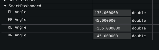

Everything looks correct and cloning your code and logging the swerve module states from the drive method in simulation gives me the angles I expected:
    SmartDashboard.putNumber("FL Angle", states[0].angle.getDegrees());
    SmartDashboard.putNumber("FR Angle", states[1].angle.getDegrees());
    SmartDashboard.putNumber("RL Angle", states[2].angle.getDegrees());
    SmartDashboard.putNumber("RR Angle", states[3].angle.getDegrees());
Not sure if the wrong values are being displayed or how you are seeing your results. Could you verify you get these angles in the sim gui with the proper module order (0, 1, 2, 3) and a positive rotSpeed?
