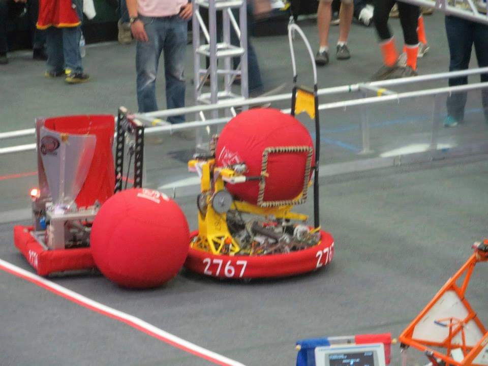

Is there a legal way to make a round bumper? In some years as to robot size all that is specified is something like 120in circumference that could allow for some or all of it to be round. Could not find in any year something for a round robot. Lets go extreme - asssume a circular robot frame. Now you can bend plywood to a degree. 3/4 in is tough to bend but 1/4 in not so much so could one laminate 3 ea 1/4 in bent plywood pieces together? after all plywood is sheets of wood laminated together so that would be then a DIY piece of plywood. The pool noodles and cloth would be no problem. Just as I could not find something (maybe I missed it) that said the robot has to be a poligon with no more than X sides and each side measuring at least xx in. We had an octagonal frame a few years ago. So how about a round frame and bumpers?
Here is an example round robot:
https://www.thebluealliance.com/team/3574/2013
Is a round bumper theoretically possible? Sure. Is it actually feasible? Not really. 3 pieces of 1/4” plywood is not a single piece of 3/4” plywood, which is what the rules require.
That being said, what’s the big difference between a true circle and a 10- or even 20-agon frame?
Question then would be if 3 pieces of 1/4 in plywood would make 1 piece of 3/4 in plywood and how would you tell the difference as the definition of plywood is sheets of wood glued together with alternating grain. So gluing 3 pieces of 1/4 in plywood together would make a 3/4in plywood by definition. Or even taking 3 pieces of 1/4 in any wood glued together would be plywood by definition if the grain alternates. As for a 20agon - possible as 20x6 = 120 but a circle would be cooler then

“plywood or solid robust wood” is the wording of the bumper rule. I don’t view that as mandating the use of plywood only. Plausible argument could be made that bentwood lamination meets the criteria of solid robust wood…

Back the the original question, there’s nothing that I can find saying you can’t steam the wood to get it soft and bend it around a form or your robot. There’s actually been some discussion on that in days of yore, if the threads can be dug up.

We did a round robot in 2014, with one continuous bumper segment. We did the 3 sections on 1/4 in plywood to make them.

OK, there is a few items here. For the circular robot frame, bumpers rules specify that bumpers must cover both sides of every corner of the robot frame. Therefore a circular robot is considered to be an infinite number of corners and needs to be completely covered with bumper.
Three pieces of 1/4" plywood is most defnitely not the same as 3/4" plywood. Anyone who has done this in the past and was able to get by inspections, consider yourself lucky. The GDC was actually vocal about this in the 2019 season.
While there has not been any Q&A about this recently, kerfing one side of the plywood and bending into the shape of the robot frame has been allowed in the past. That is no guarantee that future seasons will allow this. Of course there are right ways to do things and wrong ways to do things. Each implementation will need to be examined by the LRI on site to insure compliance.
As to the functionality of round robots, each team should make their own design decisions. Round designs have proven competitive in some past games but remember that some of those games were pre-bumper. Some of the criteria in your design should be the wheelbase compared to bumper, the height of the center of robot mass with regard to driving stability and the game itself.
