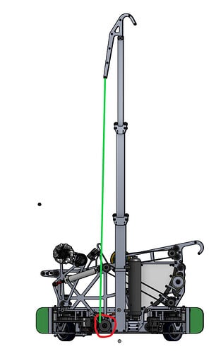

Our team used the Thrifty telescoping tube kit. It consists of 2 side plates with bearings and constant force springs. Then you use nested 2"x2" aluminum tubing, 1.5"x1.5" aluminum tubing, and in our case 1"x1" aluminum tubing. Then the constant force springs are connected to the bottom of the next inner stage (shown below).
https://cad.onshape.com/documents/9b597e70b70c28467625e71b/w/875cbc79c3f13310b06a8347/e/95d19e2cc46c781ce2ee0915?renderMode=0&uiState=61dd9a40864efa33bbef4ef1
The point of the constant force spring is to pull up on each stage and extending the arms. If let go while compressed the arms spring up pretty quick.
640e401c8c
Then you just tie a rope or cable to the top hook and run it down the center of each tube to a winch or shaft. Then you let the rope out and the arms extend and vice versa.
That’s how our team did it. There are several different ways out there to accomplish the same thing.

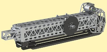

I had the same thought but maybe OP meant the large pick and place telescoping arms like:
But they aren’t very popular so I’m not sure.

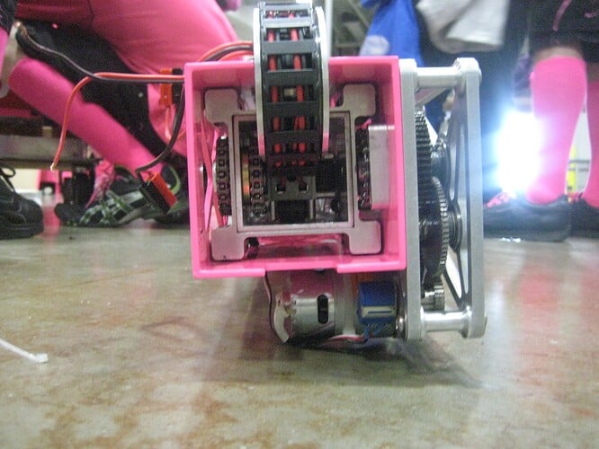

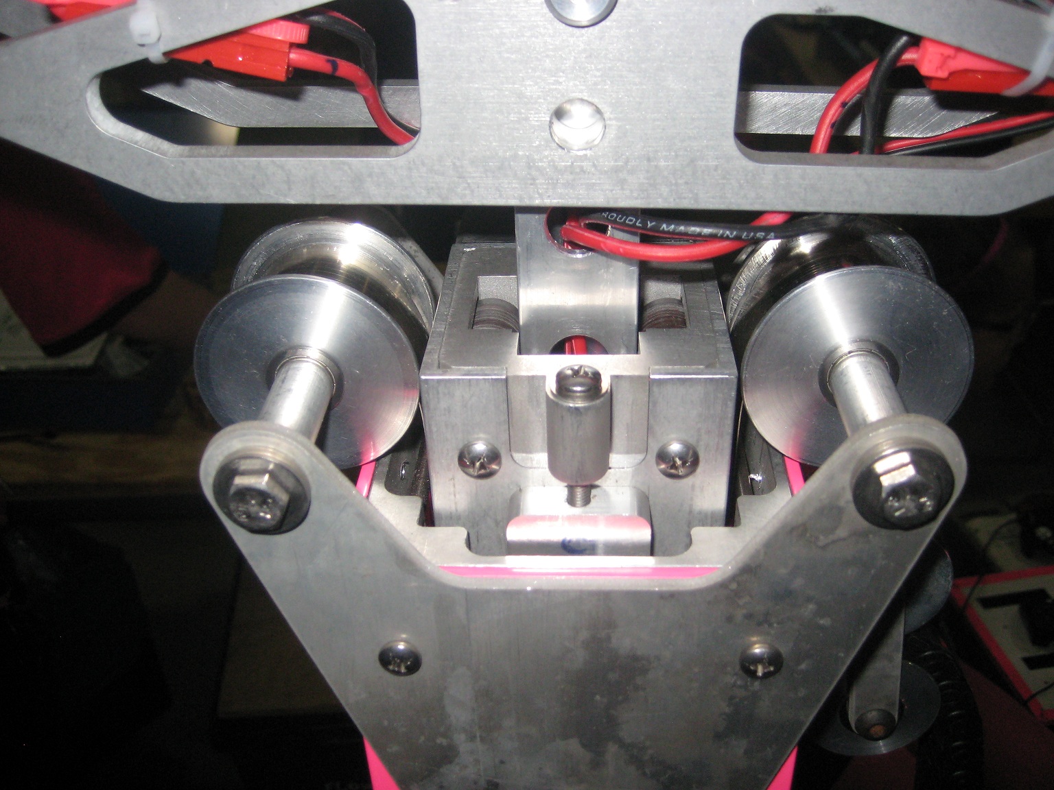

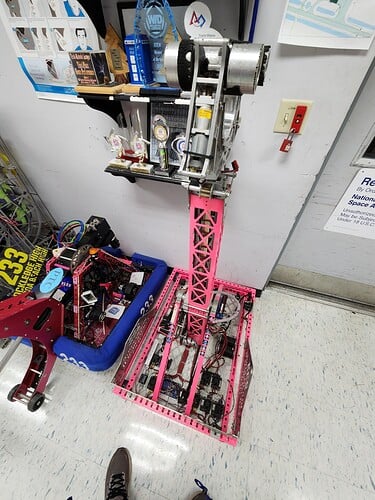

They definitely did - 3946 and 3039b allied with them at Red Stick Rumble. They spent most of the time between matches trying to whack that thing straight enough to keep it from binding. The Pink Team (233) is well known for arms which extend, rotate, and have a manipulator on them; check their site for designs as well.
Hello. If you are asking as to how COTS telescoping arms work (as seen in 2020-2022 for climbing), I am able to give you an explanation. If you are looking for how a telescoping arm works that is powered in both directions I’d recommend checking the rest of the replies.
For COTS telsecoping mechanisms, such as AndyMark’s Climber in a Box, TTB Telescoping Tube, or WCP GreyT telescope, there are multiple stages made up of box tubing. (1x1, 1.5x1.5, 2x2, etc). Each piece of box tubing has plates that mount to the top of it that hold constant force springs, and each tubing is inside each other (1x1 inside 1.5x1.5, and the 1.5x1.5 inside 2x2).
The constant force springs from for example the 2x2 plates mount to the bottom of the 1.5x1.5 tubing, trying to lift it up and extend it. In order to retract the telescoping tubes, there is a motor and winch near the bottom that wraps and unwraps string to make it shorter and longer. The string is usually attached to some bolt near the top of the smallest stage to fully extend and retract the tubes. Usually the string and motor winch are inside the tubes.
As for rigging, as I said before the strings and motor winch are usually inside the tube, but that makes it a lot harder to replace the string if needed. Some teams such as 2910 have opted to have the motor winch on the outside to make it easier to replace the string. Hope this helps!

Sorry but I think our old site is down right now, working on a new one :stuck_out_tongue: I’ll try to upload some design stuff on our 2011 bot later this week and see if I can dig up a pink arm cad

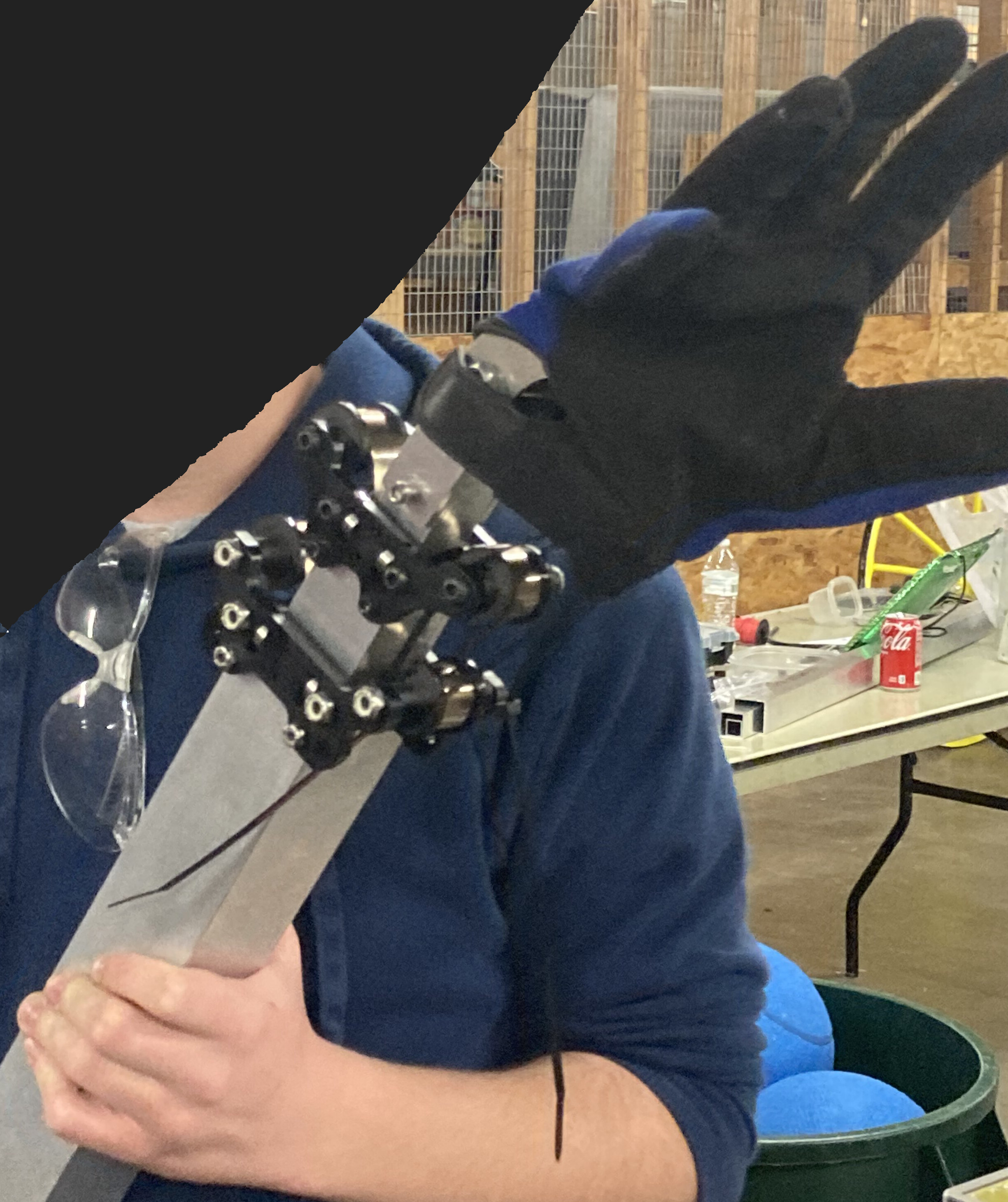

We found out if you let it shoot up freely you’ll end up bending the 8-32 bolts that mount the constant force spring assembly on the 2x2 or 1.5x1.5 tube. That is with the thriftybot kit.
Oh, we didn’t know that. I guess we got lucky! But it’s not like we did it a lot…or like put a glove on it and start to punch things with it…we totally didn’t do that…
:lying_face:
Just doing it a couple times can bend them but not a lot. Honestly you don’t even notice that they are bent until you go to take them out. We had a few failures of the original 3d printed block that goes in the bottom of the 1x1 and 1.5x1.5 tubing.
Have you tried the WCP metal versions?
The failure in the 3D printed block was fixed when they sent us the milled delrin version of that part, there was a weakness in the shoulder on the 3D printed parts.
