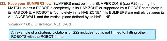

See rule G23, what I assume means you must be entirely over the line and you cannot be in Hab zone 1 and lift vertically to zone 3

If NOT the vertical prism, the robot still has to be:
  • fully in the HAB zone,
  • with bumpers fully above the appropriate altitude
  • supported only by a combination of: appropriate level or higher; the alliance wall; a robot at that level
Any robot meeting all of these criteria isn’t “on” a lower level, merely “over” it.
