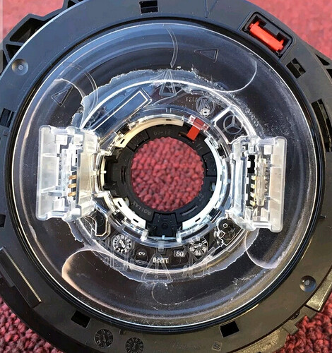

Relevant to this thread:
This is an image of a ‘clock spring’ contact used for the connections between a vehicle steering wheel and the rest of the car. Modern cars have all sorts of steering wheel-mounted switches and stuff, so reliable connections (i.e., NOT slip rings) are needed.
Look closely and you can see four tape-like flat conductors that alternate between coiling onto the center or the outer hub; this has the flat conductor bending and rolling, which allows for a very long lifetime. The thickness of the conductors determines their current capacity.
This is likely not available as a COTS, but being completely passive, I speculate that it is not a custom circuit but a type of wire. If you were to do something like this, it could accommodate several revolutions of the turret. A car steering wheel generally turns about 4 times lock-to-lock; you can design for more if desired.
The “S” could be interpreted as “Scrapyard” :wink:
If one were to use high-strand count 12 AWG wire, it might be possible to make a version of this mechanism that would handle the currents required by the large motors or motor controllers. Otherwise, standard ribbon cable could be used for the signal level connections.
