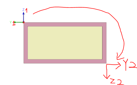

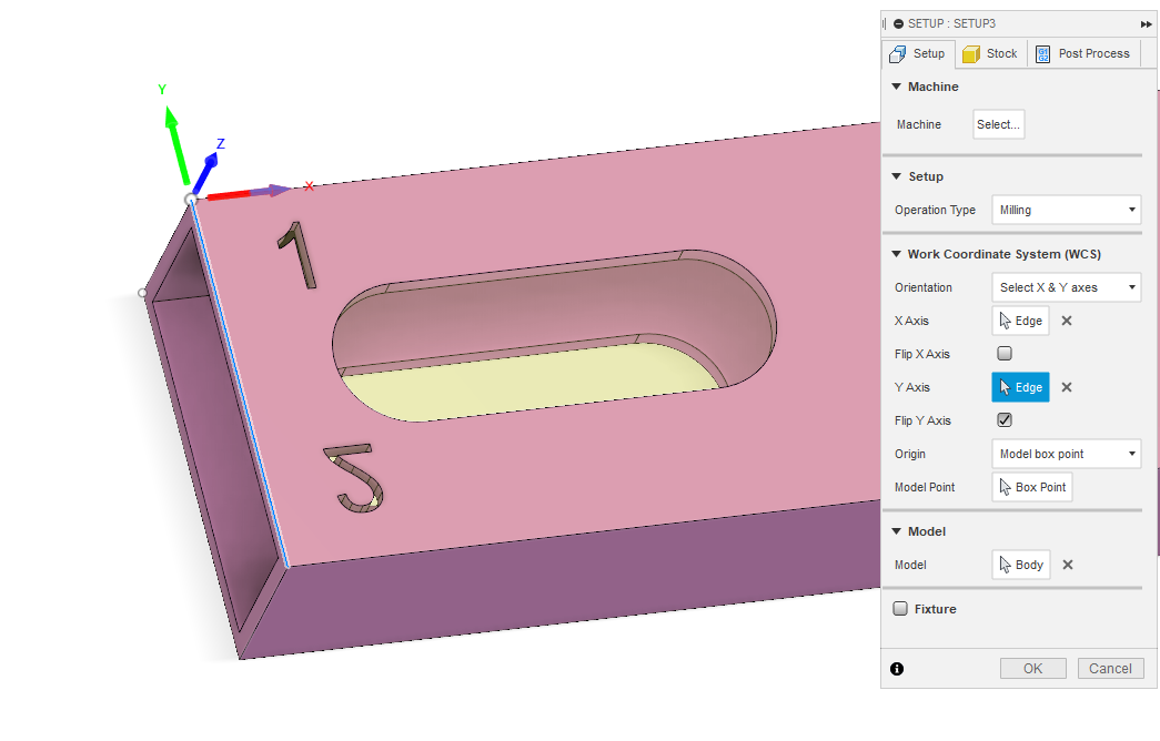

IMPORTANT: The axis you flip the part about is CRITICAL and completely dependent on how it was CAMmed. If you are rotating the part about the X axis, in CAM you need to set the origin of each setup in the correct location. I made a quick example below.

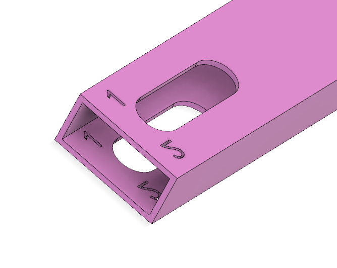

Fusion 360 Example Setups:
The original part:

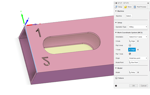

I’ve added the 1 and 2 to better represent where the part is in space. Our first setup will be when the 1 is upright, indicated off the back left corner.
First setup (Part up against back and end stop):

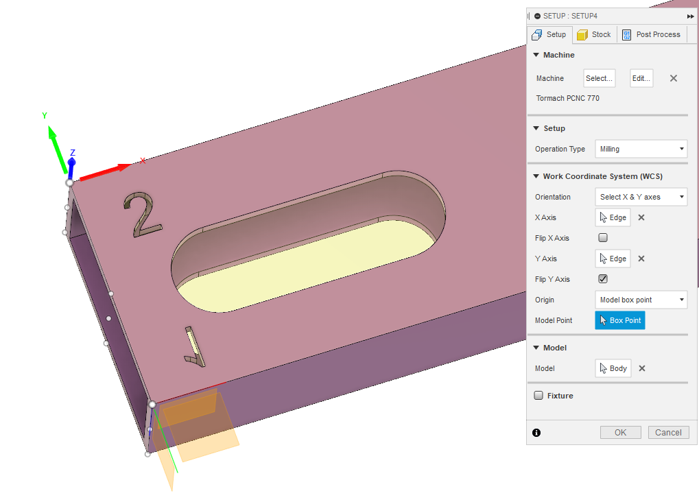

Second Setup (Part rotated 180 deg about X axis and up against stops):
Notice how this is opposite from the model origin on the bottom of the part. We essentially changed the reference frame for the machine for this specific setup.
The below screen grab and beautiful artwork shows how the part will be rotated and how the setup coordinate axis change.
If you are flipping the tube, you MUST measure the tube for it’s exact size and compensate accordingly in your work offset or in CAM.
