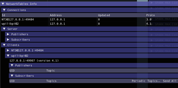

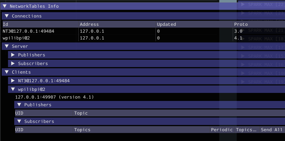

Using robot simulation on the PC for initial testing, I start our robot sim using VSCode using real-drivers station, the wait for the Robot Simulation panel to come up. Next, I start the cameraServer in client mode with the python command above.
Camera light comes on, and I see the client connection in the Sim panel’s NetworkTable Info:
The problem is I don’t see anything on SmartDashboard when I add a camera steam or mjpg viewer.
With ShuffleBoard there is “no data available” under the camera server.
