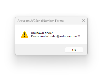

2 cameras on one device need to be different types, or you need to be able to rename the cameras. Arducam has a utility to do this for their cameras. I think it is done with the Serial Number Modification Tool.
We are getting better at identical cameras on the same device, provided they never change USB ports, as of 2024.2.7. I’m working on a docs page to explain more visually the actual camera matching process
I have two Arducam USB OV9281 and I am pretty sure they are randomly switching which one the photonvision on the PI is referencing in my pipelines. I tried the tool mentioned above but I get this error:
this is using the photonvision image for the Orange Pi. Anyone know if I’m going about this wrong?
It may not be an official Arducam or there’s a hardware issue. Can you see the picture from the camera using the Camera app (window) ? If so, it is likely a knock off.

Actually that’s exactly the same camera we have. I got a reply from arducam support:
Hi,
Please try the tool in the link below:
So maybe the tool has been updated. I won’t have a chance to try this until tonight
Interesting, it worked with the download from their site. Do you have the 120FPS or the 50FPS version?
I think it might be the 120 FPS one
Unfortunately the new file link didn’t work either. Feeling a bit stuck. Everything is working well except there’s a 50% chance my 2 cameras get swapped!
You could try the 50FPS one or a different model camera. I know for sure the 50fps one can be changed, we’ve changed 3 of 'em. I noticed innomaker was selling with the same model number sensors and we have some but ran into the same problem. We’ll keep them on hand as spares. Does the cameras say Arducam on the back?
Yes, I have an official arducam (checked the pcb and verified with the support person). I now have a new version of firmware from the supplier and I’m told this should work but I can’t try it until Sunday. I’ll report back then. Just in case anyone else is having my problem here’s the latest reply:
Please follow the video in the link below to burn the firmware into your camera. Kindly note that you need to replug the camera to take effect after the burning is done.
Then try the ArducamUVCSerialNumber application again.
Ok, I’m happy to report that after updating to the latest version of photonvision (2024.2.8) and rebooted 4 times and cameras stay in the same place, fingers crossed!
