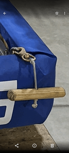

We always install eyebolts and use handles to move the robot. Make sure good knots are used.
This is exactly how my team did it! Of course, that doesn’t solve all of the issues but at least it gives the technician (and helper!) a convenient place to lift the robot from.

We made some of these today. They were so good our lead mentor said “if I knew they worked so well we would’ve done it 10 years ago.” Great design!
