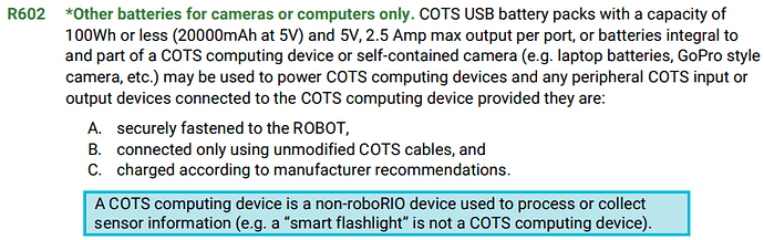

I would love to use a UPS, but they are most not legal. Sometimes they get missed in inspection, but sadly, they are not allowed by the current (2023) rules unless you can find one that has an “integral” battery or is powered by a USB battery pack.

The rule we’re talking about is R602:
The PiJuice HAT would likely not be legal. It has a removable (non-integral) battery that is not a USB power bank.
The juice4halt might be legal, but it’s not powerful enough for a Pi 4. The Pi 4 needs at least 2.5A, but ideally 3.0A, and the juice4halt is only 1A!
Yes, a USB battery pack is legal, up to 100Wh, and 5V, 2.5 Amp. Which also is likely not powerful enough for a Pi 4, ours reports undervoltage when connected to a power bank. It would probably be workable, but the Pi won’t operate at full capacity.
We ran our Pi 4 with a 12 volt Milwaukee Tool battery and a USB adaptor. Took about 30 extra minutes and a bunch of calls during inspection, but they let us keep it. We found a better way to power it for later competitions luckily.
