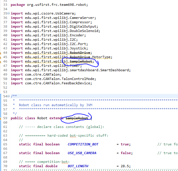

Well, our code is now broken after updating everything (java/frc-2018-update…) and I see (attached pic). OK.

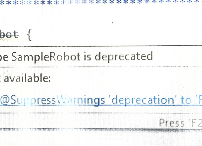

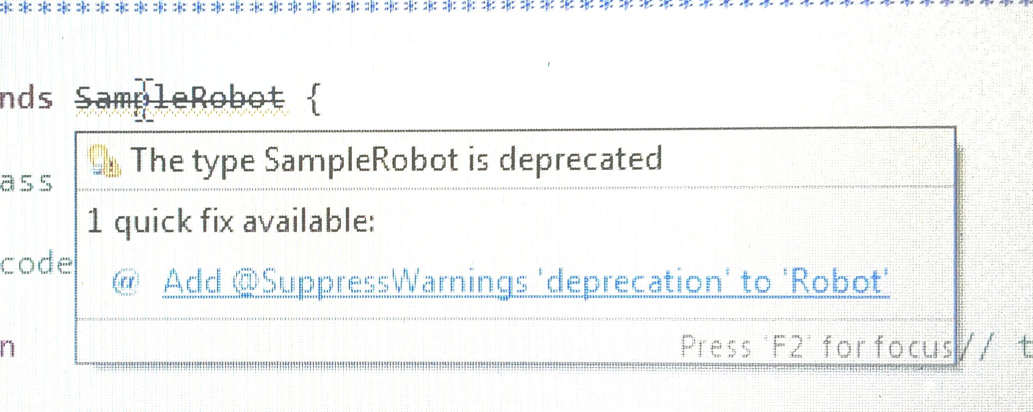

When I hover over SampleRobot I get get the dialog (2nd attached pic).
If I accept that, it add the @SuppressWarnings(“deprecation”) above the class def. Yeeeaaahh, not sure the implication of that, but it just does not seem like a good solution.
public class Robot extends SampleRobot {
(yada, yada)

Your code isn’t broken, and it still compiles. Deprecation is a warning, not an error. That is, deprecation is a strong hint to the user that they should be using a non-deprecated thing instead, but it isn’t removed yet. We deprecate things before removal so people have time to upgrade.
