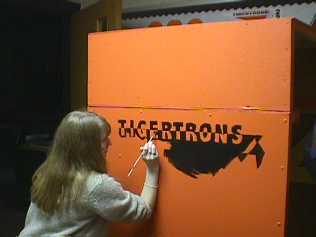

Here is an example of our crate,nothing special…a wood box with a door and aluminium re-inforced joints…
:slight_smile:
Of course our crate is orange~~~!!! This pic was taken last year when we were painting our logo on it. It has a little compartment/shelf on top. This is for extra parts and things. We also have a second crate for our tool box. Our crates are made out of chopped up 2x4s for sides and support. The bottom has 4x4 for the forklifts and a plywood base. The sides are covered with paneling.
We do not have any hinges or doors. We just un-screw the front side panel.
